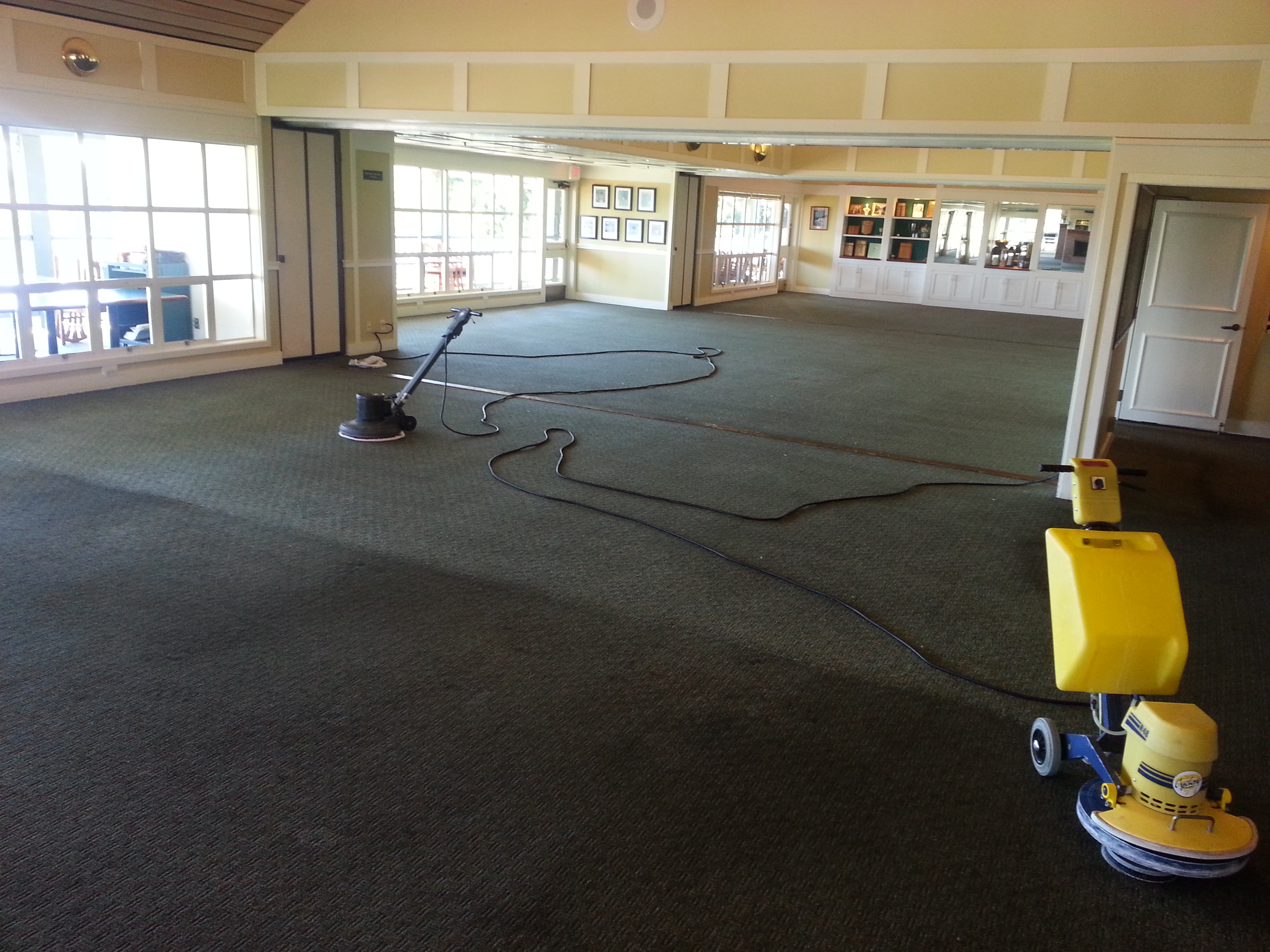

We do a huge event facility that we clean twice a year it's 22K sq/ft . We've cleaned it for years and we used to clean it with Powerglides but in recent years switched them over to mostly Encap with some HWE where needed.
They love the encap now, they can get on the carpet and get their tables setup while we are still cleaning other areas and are ready to go for the next morning. It cleans up great too, the planetary action fluffs up the fiber some too. We used to send seven machines, now we can send eight! :cool:
I'm pretty confident in our cleaning when we don't try to force a system on the project but use the tools that will make that project look best and work best for the client.
I like how you are using the pad cleanings following the Cimex! :cool:
