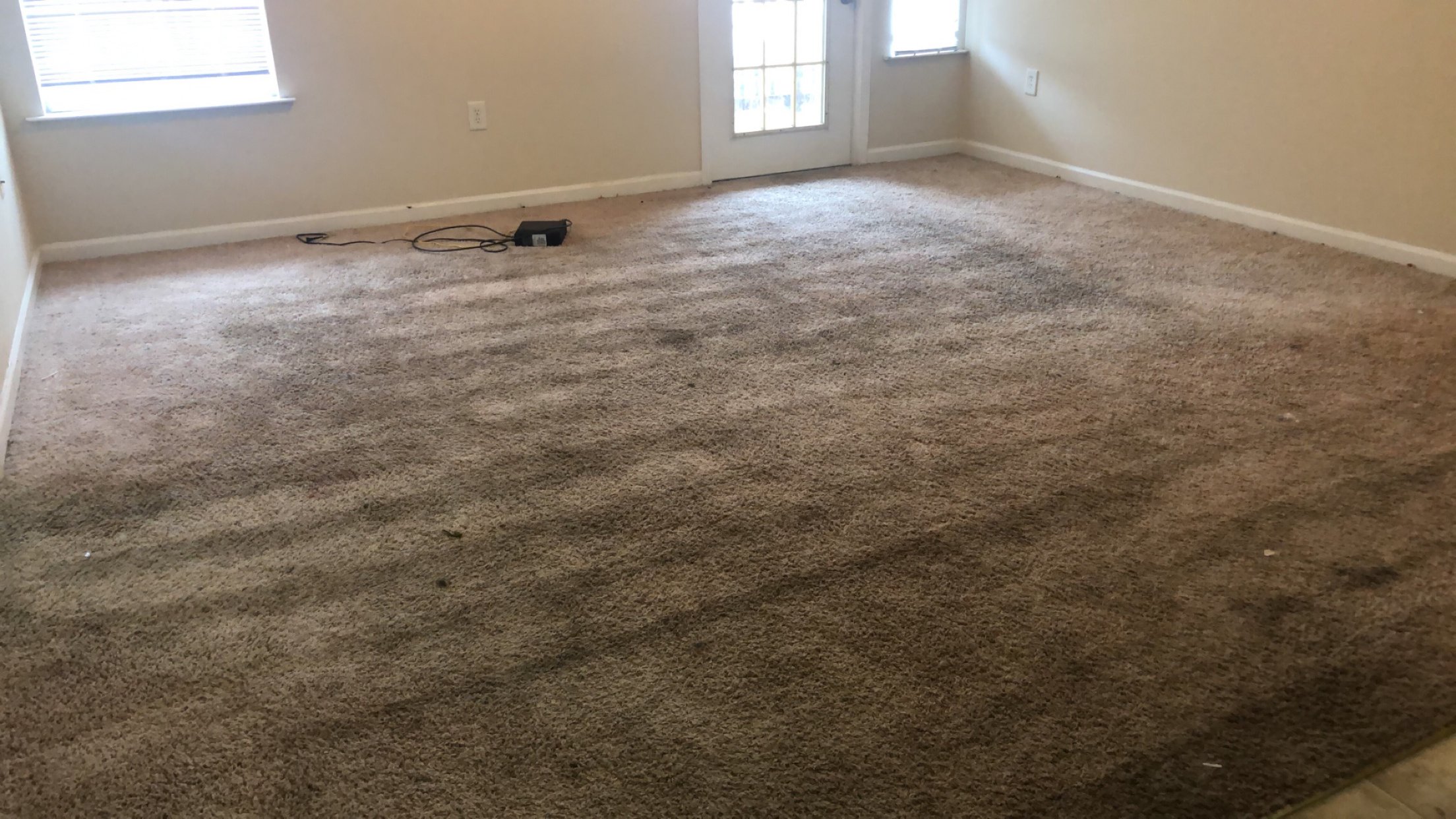

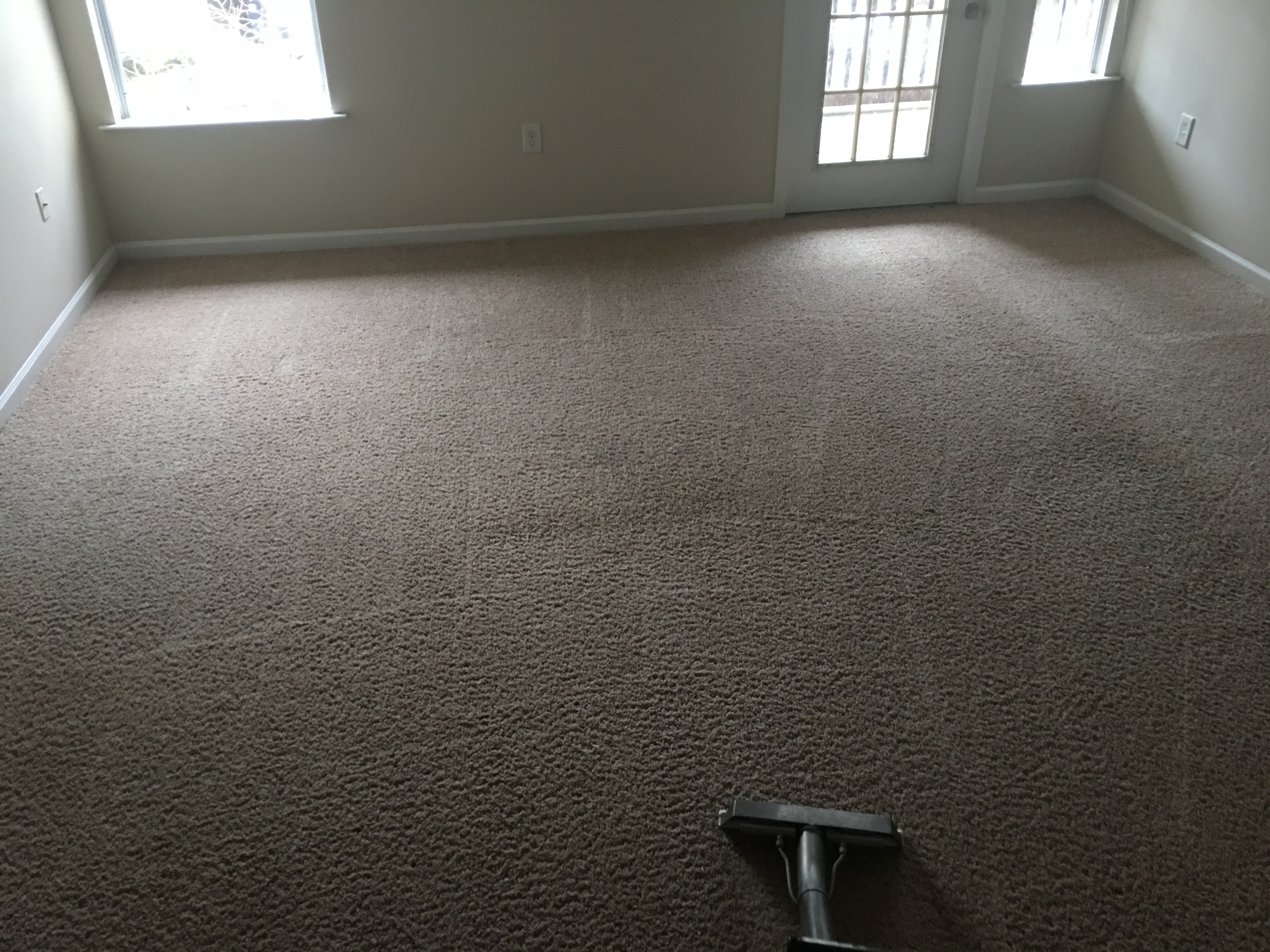

This job needed one and proof is in the Pics. There was so much junk pulled up After I vacuumed. I doubt it would’ve looked this good if I skipped CRB.
There was no special mix of prespray. Just a plain Jane jug of it.

Nice work. I dont have a brush head, but I dont see how a brush grinding things in will do the same thing. I have many hundreds of hours on rotary machines, but prefer a crb.

A CRB doesn’t rinse away your pre spray.
Which provides more valuable dwell time.
It brings junk to the surface that truck mounts would most likely leave behind.
I like a rotary wand if a carpet needs to be flushed to hell and back.

A buffer is for polishing floors, not agitating carpet. And yes, I see a 360i as a buffer with some vacuum ports. I don't want to stir the junk. I want to pull it up.

I have both and use the crb with just mildly stained carpets. It does dig out and agitate the pre-spray nicely. With 2 people it doesn’t add any extra time. For a carpet that bad I would definitely go for the rotary but great results either way. In this case the rotary would save time.
