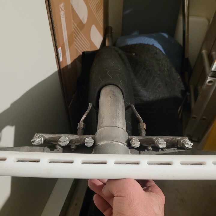

The side jets are slightly turned inwards to prevent overspray. The wand in the pic is used for residential carpets only, set at #9 flow- 95015. The identical wand is set to #11 flow for the commercial accounts. ( mostly CGD carpeting) Both are fitted with extenders to counter the glides.

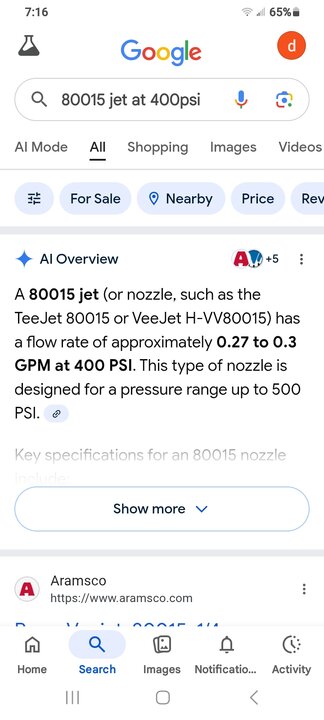

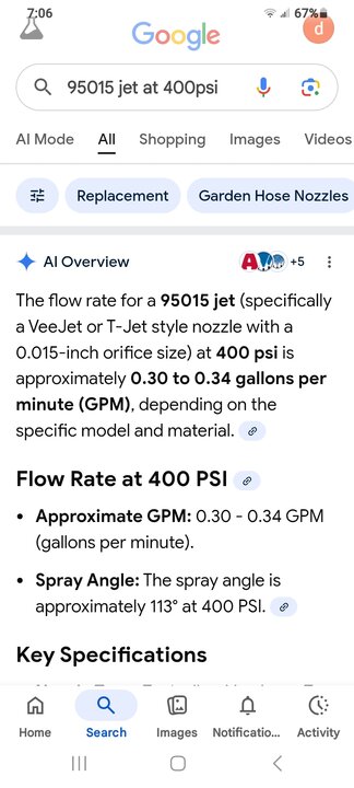

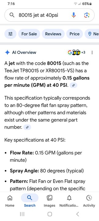

Flow is based on psi. Most spray jets are rated at 40psi. Based on that, 5 - 80015 jets will flow .75 gpm @40 psi (.15gpm per jet×5) and 1.35 to 1.5gpm @400psi

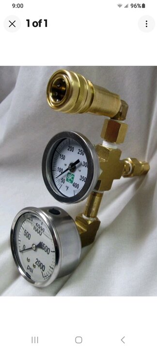

I have no idea what you're talking about. Ive always simply used spraying systems flow charts for flows based on tip size and pressures , then simply multiplied by number of jets to reach flow. Flow is based on size of tip and psi at tip. Diameter, construction (materials its made of),and length of hose will cause pressure drop from pressure source to tip which will effect actual flow. Thats why jets are measured on a chart at a standard pressure generally 40psi and adjusted up or down from base for final flow. And all this is made sooo much easier for this computer generation by simply asking google "whats the flow rate of a _ _ _ _ # jet @ _ _ _ _ psi and getting an immediate answer. To get an accurate pressure reading at the tip , youll need a pressure guage on quick connects at the wand and check pressure while spraying. But if you're really really really geeking out and you have a hose connecting your trigger valve to jet manifold youll connect the guage where the manifold and hose meet for the utmost accurate reading. If that's your thing and you got that much spare time. For me .... size & number of jets and pressure at the trigger is good enough. I have a" lie detector " that looks like picture below i use as a test tool for checking my temps & pressure

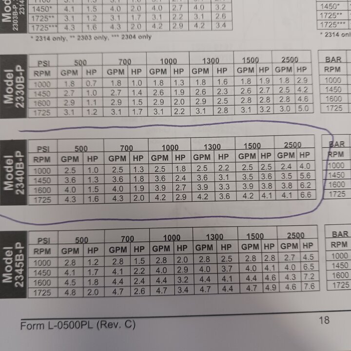

Yes thats what im saying . But only if your jets are allowing LESS THAN YOUR PUMP OUTPUT IS youll spray the same amount of water ei: if your pumps flow is 2gpm@ 400 psi and your jets are 1.5gpm @ 400psi the flow would be the same even on a pump that did 15 or 20 gpm. However if the pump does 2gpm@400psi and your jets use2.25gpm@400psi there would be a severe pressure drop on that pump but would maintain pressure on the pump that produces 4gpm. Keep in mind pumps are rated @rpms ie: if your pump is rated @ 2gpm@2500psi@1750 pump rpm if the pump turns less rpms the gpm and psi will be lower. Below is the performance chart for my pump, Hypro 2340b-p
