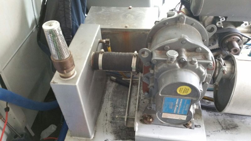

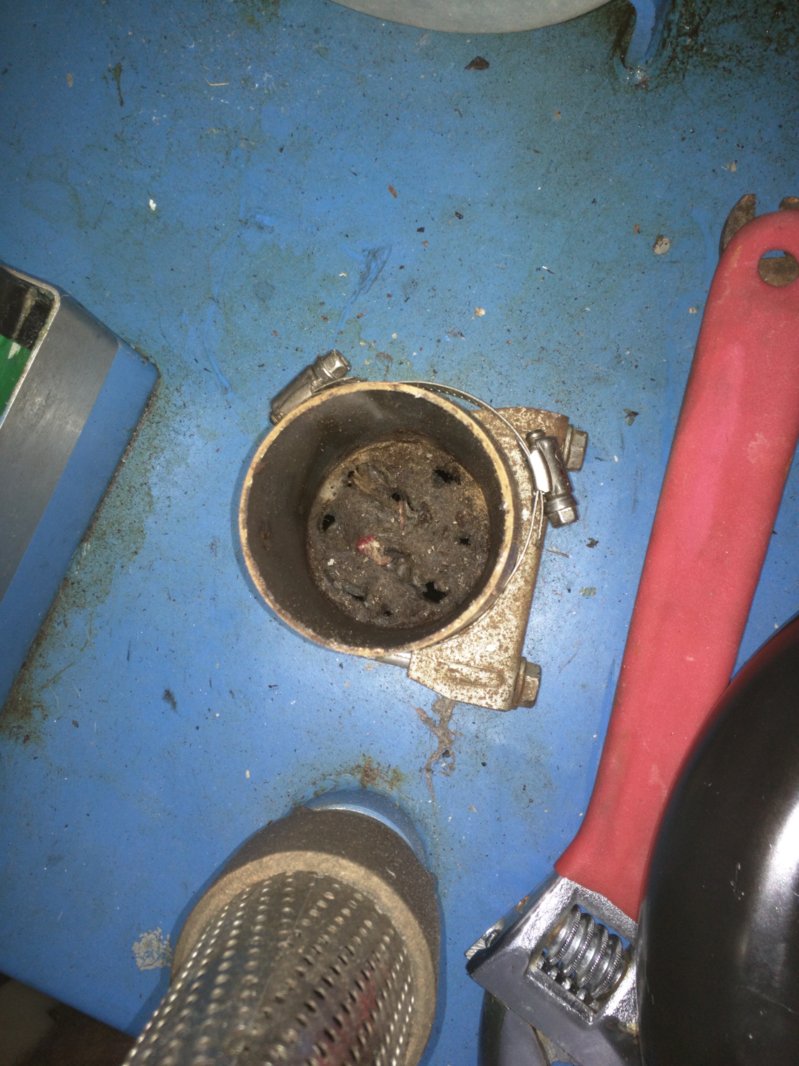

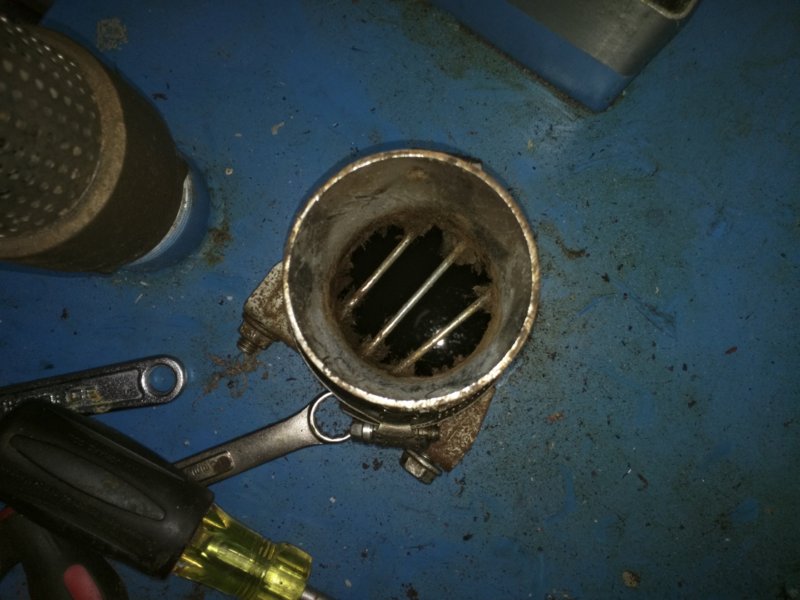

Maybe this can help some here with TNT's

Thanks Ryan! I wonder how many Judson owners don't know that little screen is there....
D
dgardner

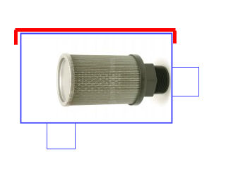

If I had that unit I think I would be replacing that elbow with a stainless box and put a regular threaded inlet filter inside.
B
Bucey
It's an older model. Les, doesn't design them that way anymore. No more elbow, there is a air chamber housing that the blower inlet goes straight into off of the recovery tank. If that makes sense.

Well, imagine instead of taking loose several clamps and removing an elbow with a mallet, then digging around with a tool to clear the junk out you just popped a couple of latches, lifted off the top of the box and unscrewed a filter - that you could take over to the bench and gently brush (and/or back-flush with the water hose) - all without tools. And, btw, the filter would have about six times the area of the original screen so you wouldn't have to clean it nearly as often.
The box would replace the elbow, and you would never have to tinker with it or remove it. The only added component would be the filter, which can be cleaned and reused indefinitely. So, basically one additional component. There's a reason that pretty much all TM's use a similar filter nowadays - it's a pretty good idea, and not invented by me by any stretch of the imagination!

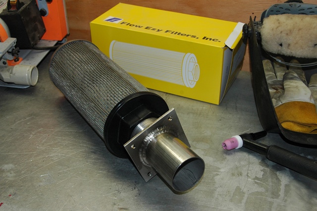

I'm hoping to avoid that. The adaptor I fabbed for the machine I am building is all stainless. I just recently got a second argon cylinder and regulator so I can properly back-purge the stainless. Huge improvement. Here's the filter - 11" long with 3" NPT connection:

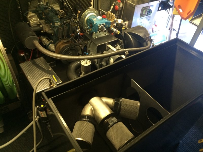

Mike, is that how Les designs the C4 units? Or is that a modification you have done? I still don't like seeing that 90 and all those filters. But what do I know?
Make sure the filters are all stainless mesh and reinforcement or they will rust through and won't be warrantied. The nut needs to be plastic.

D
dgardner
Yikes - thanks Michael - I listed the wrong one above! I edited to list the nylon/stainless version. More expensive (of course).

Perhaps a single filter with equivalent area would have been too long to physically fit in the available space? Also the filters of that type I have seen are only available up to 3" inlet - multiple filters would be needed to avoid inlet restriction for a larger piping size. Just guesses.
M
Mike Draper
dan, your exactly right. I couldnt use the standard long filters or else I would need to lengthen the tank. 2 filters are acutally more than sufficient, but since the modified inlet from aerotech already had 3 holes there was no reason not to use the 3rd hole.
When taking the filters off, I have exactly 1" of space when the filter is to the last thread on the nipple. Made the tank just big enough for the filter removal / installation
Reactions: dgardner
M
Mike Draper
The C4 has an air chamber that comes up from the tank in order to slow the air down. No filters

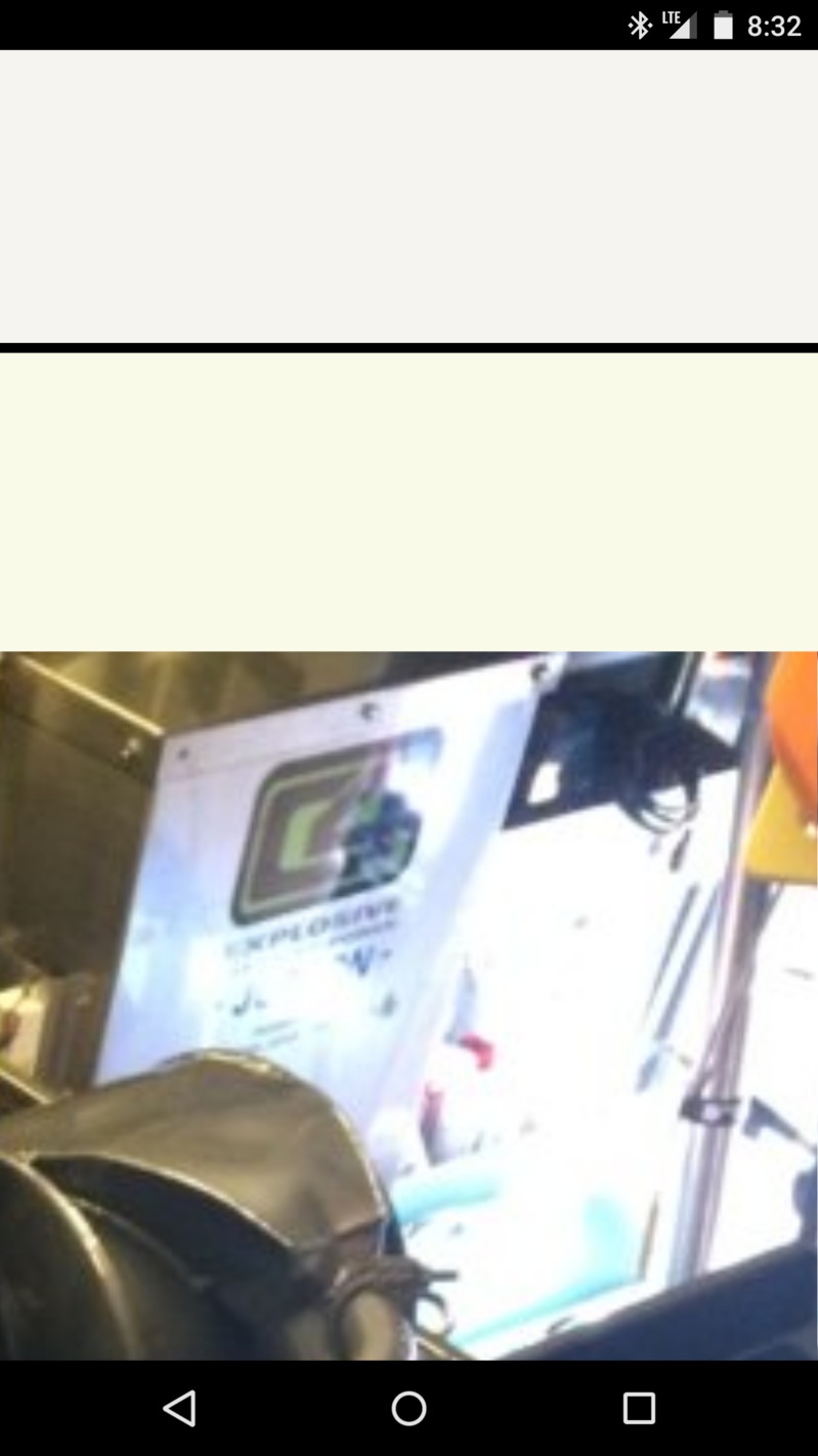

I thought that was the unit I saw in the video......what through me of was this....
I notice now that was your LP heater.

Funny that adding a filter would be considered an unnecessary component. Debri getting sucked through the blower might not hurt it but I wouldn't like it. When you drive the water in the tank sloshes around putting whatever is in the water everywhere. As much as I do with all the my filters they still get coated, and I have two large ones. i have a large surface area reducing the vacuum effect, imagine if I only had one small one.. You can see the effect, stuff is getting sucked through.
