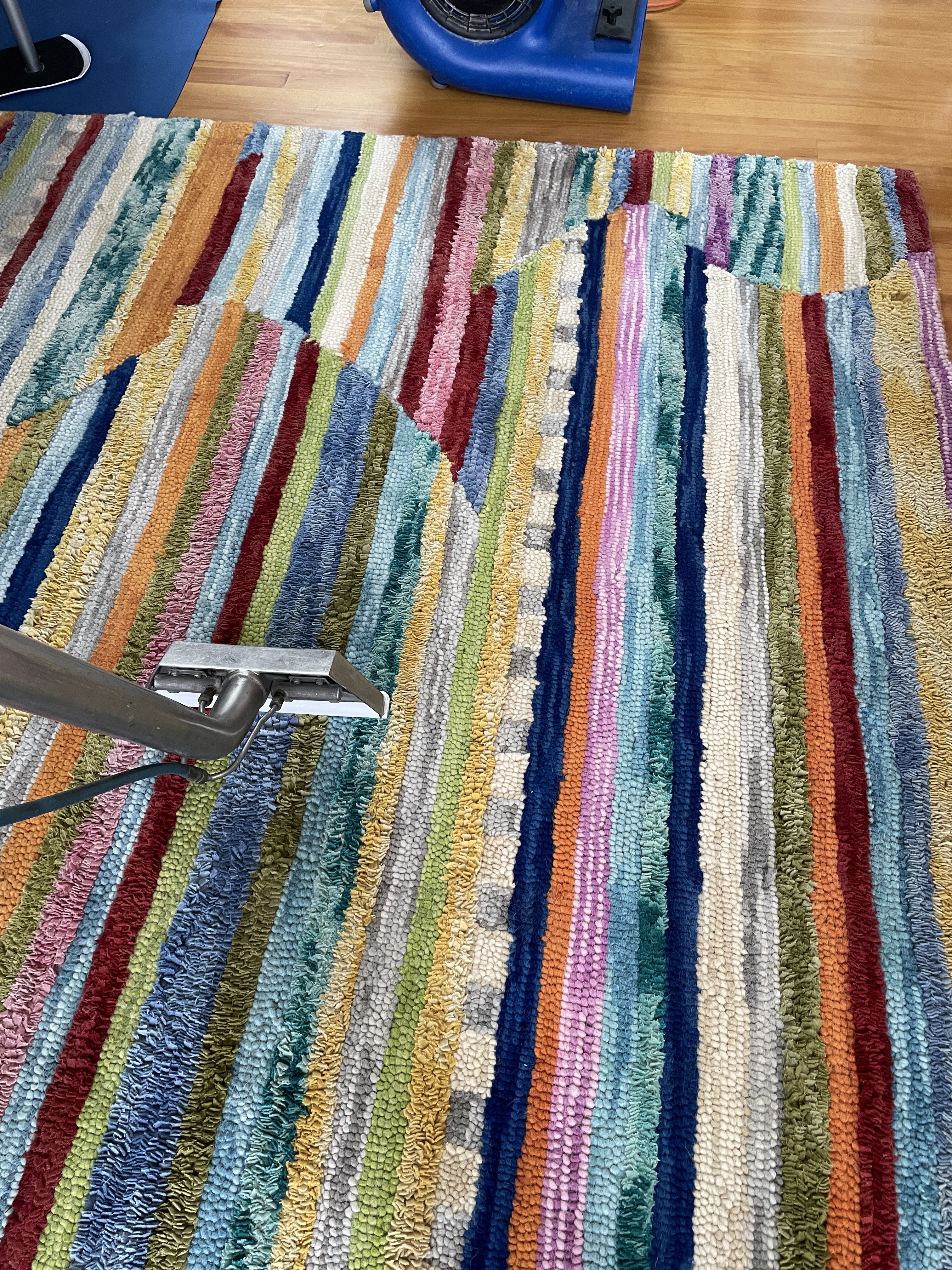

This house was built in 1965. Pretty sure original carpets. Besides the offgass under furniture situation they still look good, actually great. No stains or wear patterns.

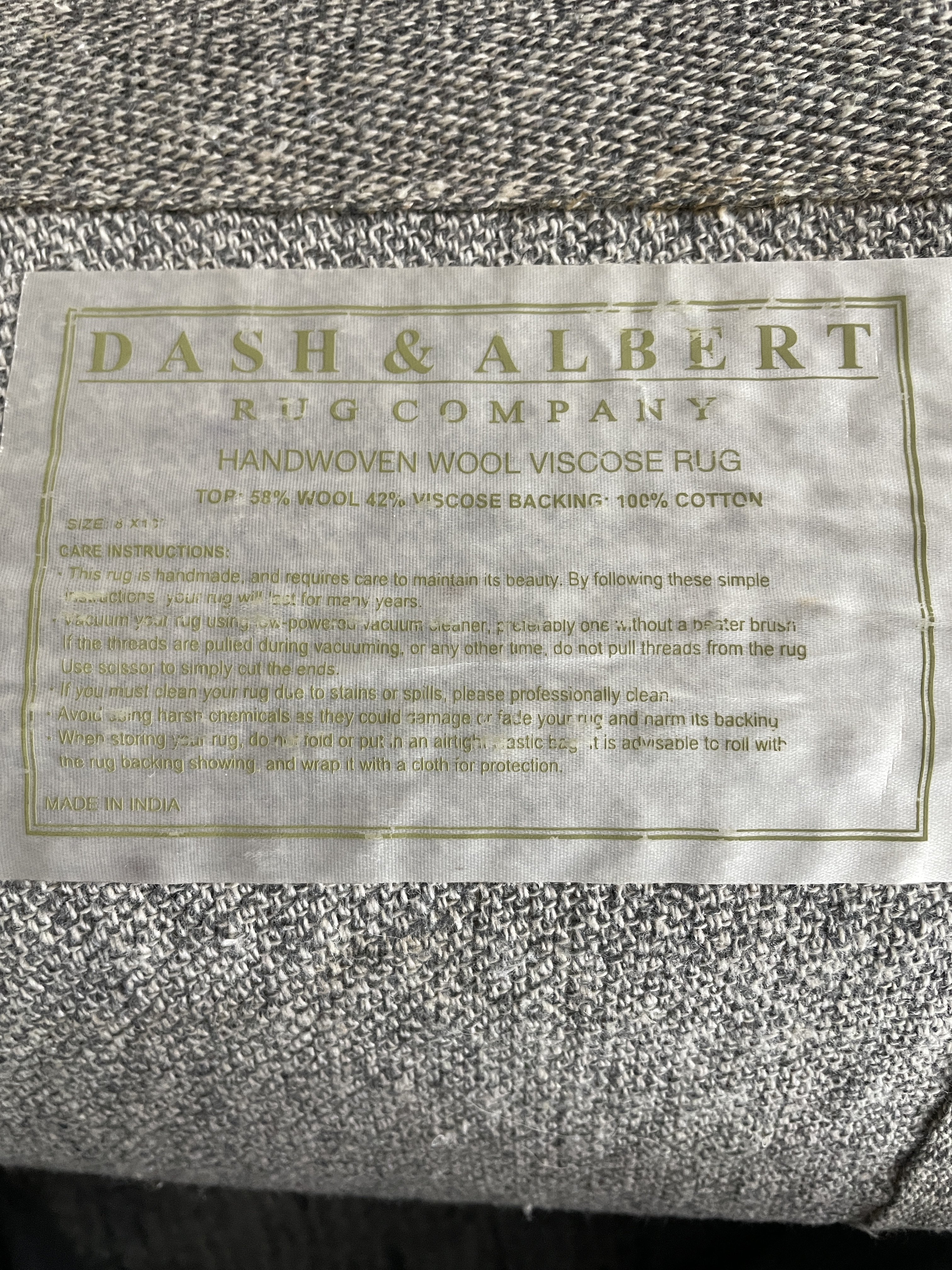

Next job was a 5 yo house with rugs bought by an interior designer. I walked from this one. piss stains were the problem, then the tag........viscose blend.
Im seeing more and more viscose.

At least Annie Selke (Dash and Albert) warns people about what they're buying:
The delicate fibers of viscose-blend rugs are best suited for low-traffic, gently used rooms only. Not suitable for homes with children and pets.
On the website at least.

Thanks, I didnt see that.

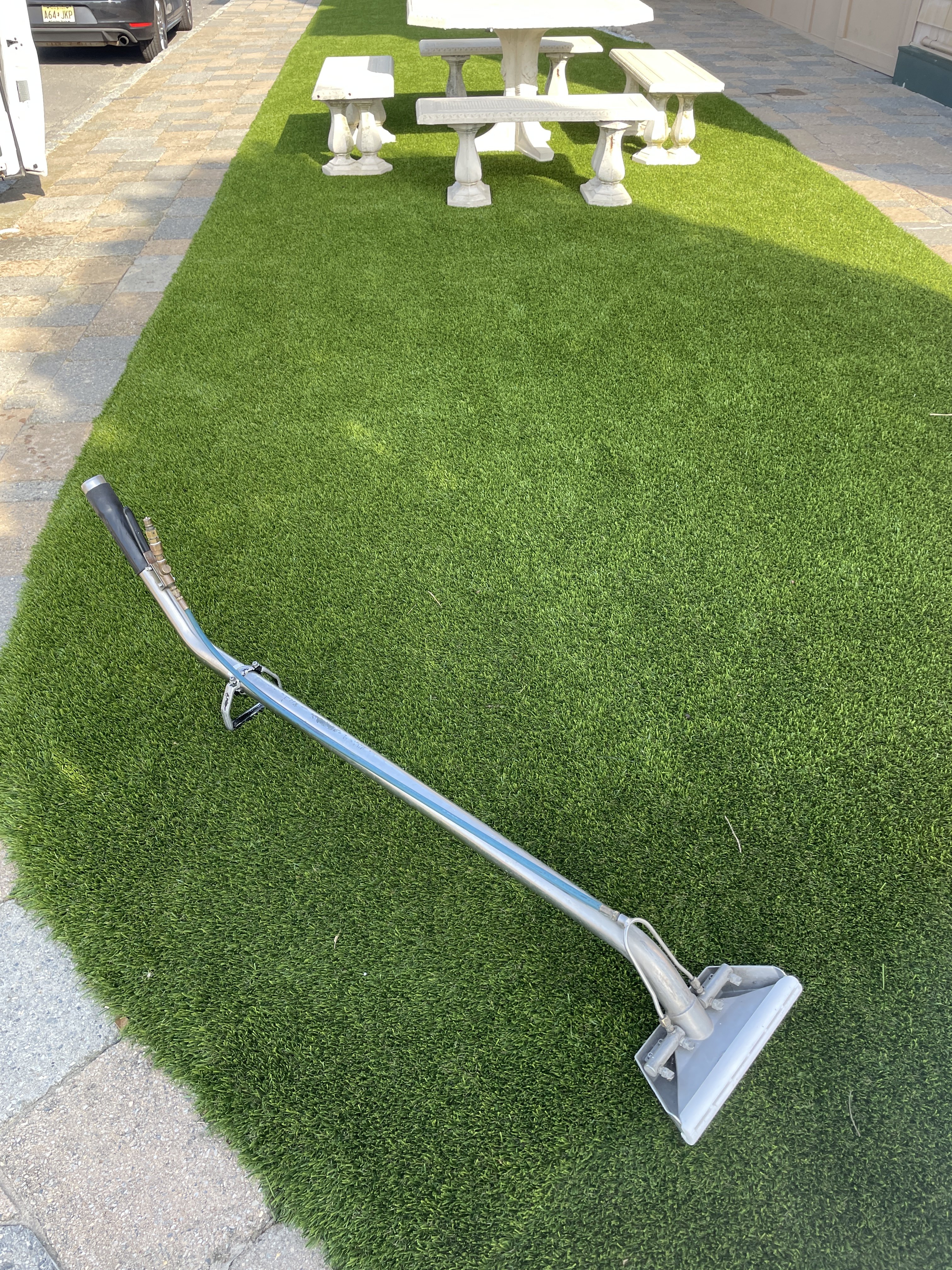

Funky grass too.
@ $16 to $20 per sq ft, I decided to go around it. Do not want racing stripes here.
