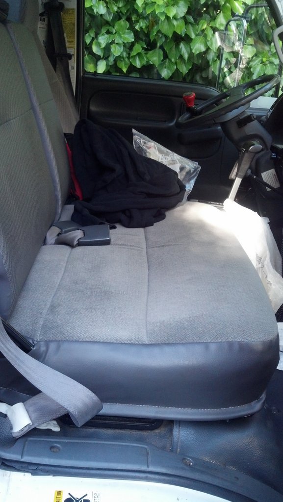

Two of the best Vortex mods ever.
114,141
One was to wedge some two by fours between the glycol heat exchanges and the front wall of the box.
Huge decrease in flexing of the tank. Not sure what idiot thought hanging those two HX tubes with some crappy tack welds on those huge SS sheets was going to be a good thing. KMA! KMA!
After gusseting up the cracks and adding the wood I've been as leak free as Merty on date night.
second bestous improvement was to redo the passenger seat with new springs and two inches of premium super foam
