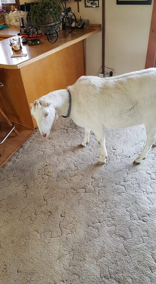

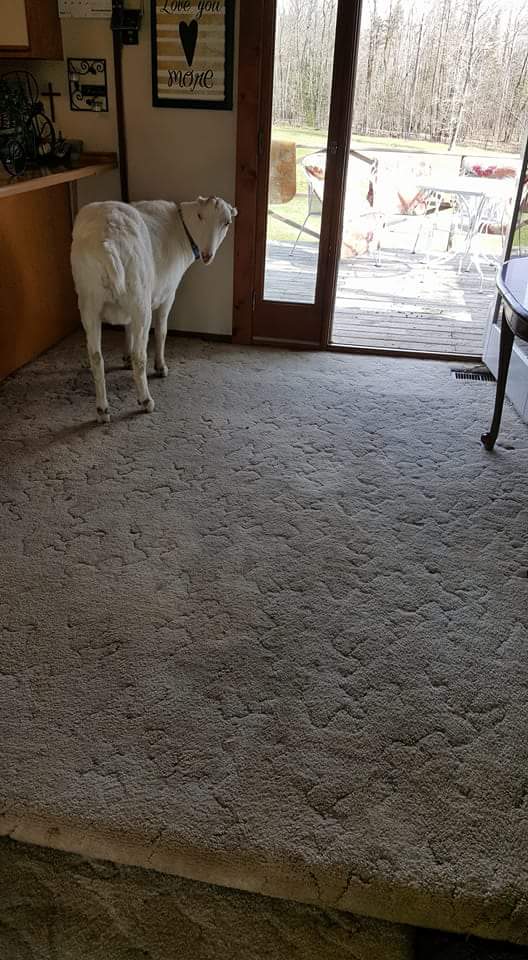

Hey Jimmy @Jimmy L
Get a load of this one from one of our clients!
Has the run of the house!
