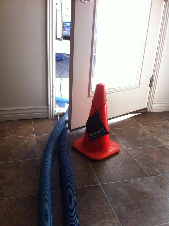

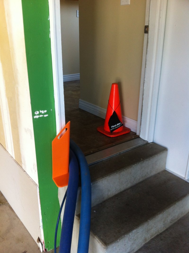

Propane-powered equipment still puts out carbon monoxide. As mentioned above, our tech nearly died running "clean-burning propane". A propane-powered engine discharges CO, just less of it.
Here's what I learned about carbon monoxide. It has a cumulative effect. The CO gradually builds-up in the blood because it tenaciously binds to the red blood cells. And it doesn't release for several hours. Then once the person reaches an overload, the blood cells can no longer carry oxygen. Since this occurs gradually the victim isn't aware of the toxic level building up. Dangerous stuff! That's why after our episode, we went back to running electric high-speed buffers.
Like Bob recommended, a CO detector is essential. https://www.aircraftspruce.com/cata...M_BC-V5MZTzfXTkkmIsCfkwY06k_W-HYaAg3SEALw_wcB

I just ordered a few of these. Thanks. Where is the best place to set these to be most accurate while I'm working in the building?
