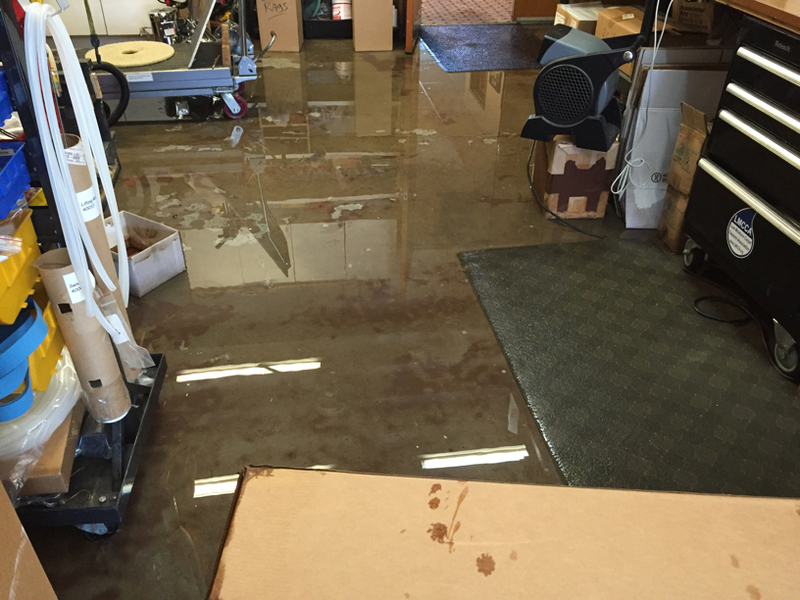

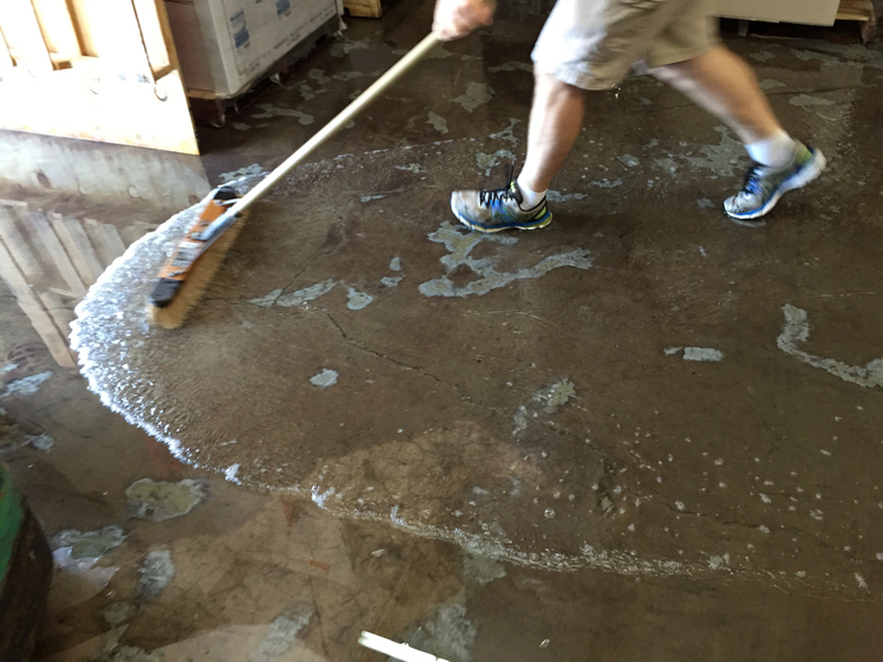

OK all you water damage restoration guys, please give me some advice. I just got a call from our next-door neighbor at our building and there was a pipe break. My warehouse is underwater and the show room and a couple of offices are soaking wet too. They called Servpro. Any suggestions on how to get this dried out with the least amount of damage and the quickest turnaround? Water damage restoration was never my specialty. Any suggestions would certainly be welcomed!

I'm not impressed with Servpro so far. He is still trying to get his guy to get over here with some equipment. They need to dry out the building next-door before the can even start on ours because water is still seeping through the wall.

The baseboards run all the way to the slab. That's why he pulled the baseboards. The water ran under the walls from the neighbor's space next door. And the wicking ran 3 feet up the wall, according to his moisture meter. That's why he pulled the baseboards - to open the walls and to try to get them dry. My space is a far cry better than what the Servpro guys are doing next door. They've trashed their place (ripped the heck out of their drywall).
