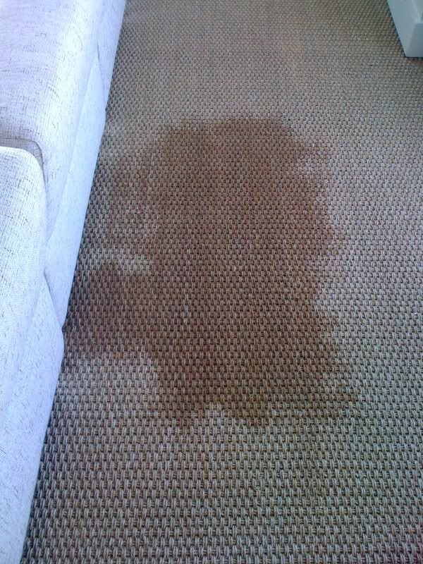

I have a customer who has a wall to wall seagrass carpet. Similar to sisal. when he was showing his house someone moved wet outdoor furniture and placed in on the carpet leaving a water mark. there is no dye just the water stain. What would you guys try first to correct this
I have a pic....im not sure how to post it

First.. get a complete sign off of liability and don't make any promise whatsoever. and second you may be able make it uniform by doing a quick rinse over the entire thing.. Use and acetic rinse. no heat and keep your pressue down to not even maybe 2-300. glided wand and get it dry as absolutly fast as you can. Lots of airpaths and air movers.

either host or encap lightly on moisture or walk away

Host or don't touch it but that won't fix it. David told you the only way it MIGHT be fixed but there is a HUGE chance of causing more damage. I would pass.

I have done a few of these (sisal, seagrass, etc. are very popular in my neck of the woods). The problem with Host is you will have a very difficult time removing all the granules off a wall to wall.
You will probably have to steam clean this thing and force dry it with some ari movers. Hopefully it is nowhere near the wall or seams. But just remind the client that it is already damaged. You will be attempting a salvage cleaning. That way, you will not be held responsible if further damage occurs and you will still be paid.

I had to clean some of this the other day in an apartment on the 12th floor. We presprayed a sample piece lightly with encap green and it rolled up like a news paper. In the end, I lightly sprayed it and bonneted cleaned it. Then we went over it with the CRB - That seemed to work the best to dig stuff out of the texture. Over all soiling looked much better. Most of the spots came out. But the urine stain on the side of the bed is forever.
I would probably never do it again.

I usually tell them to live with it or decorate around it. If they would rather replace it then I tackle it. For a small water spot I would try the new product by bridgepoint. I forget the name but it's 15 per small bottle. It's mostly peroxide I think. I lightly sprayed a small area that was water marked and it dried perfect.

From the picture there is no chance you can make this carpet worse, but you won't make it much better either. Let the customer know they can take the money they would have spent with you and put it toward a nice "better than sisal" style of cleanable carpet.

I think your only chance of saving that is to dye it darker. Other than that it is probably not worth it to correct a size stain like that. This type of rug is not very costly to replace. Perhaps they should invest in that.

I have had success (only sometimes and not on such a big intense stain)with a tanin spotter (actives are hydrogen chloride & oxalic acid)followed by rust remover (10% hydrofluoric acid).

Peroxide can damage cellulosic fibers. I would not go that route.
The carpet was already ruined.
The spot I hit was much smaller and while peroxide might damage it some it completely fixed the problem. I still clean for her and the carpet is still fine.

A stain that size, I'd run too!!
I've done a few small stains. Used a Stelco spotter possibly similar to what Ross has referred to but also on one I used a 3% H202 solution and lightened it up.
One some, it'll leave a lighter area and I've been able to lessen that with tannin dyes.
But no way I'd attempt that process on something that big.

I went to the home yesturday and took a better look at the spot. The owner of the home is attempting to sell his 3.5million dollar house when one of the other agents showing the house put damp outdoor furniture on the seagrass. The owner told me he paid close to 5 grand to have it installed!
After explaining everything to him he decided he would try to get the agent to replace it seeing as it could cause more damage or not get better.
