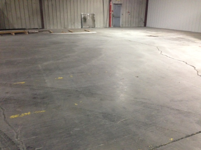

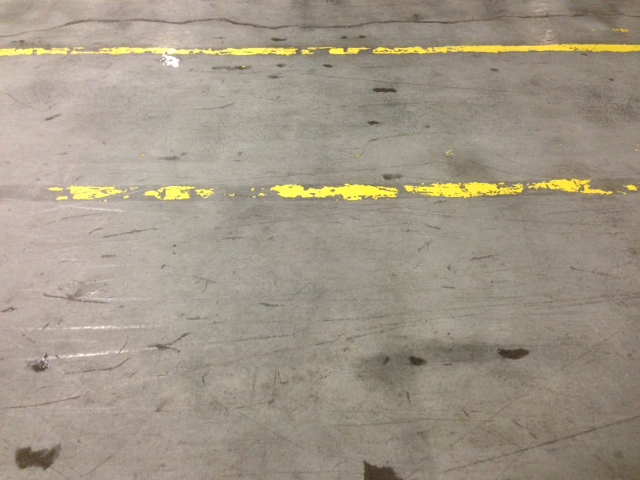

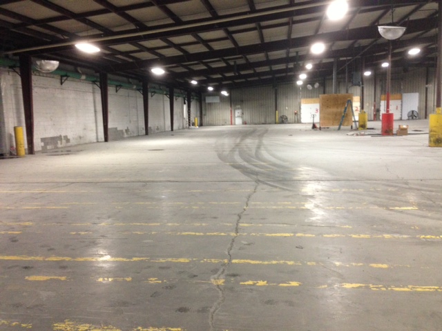

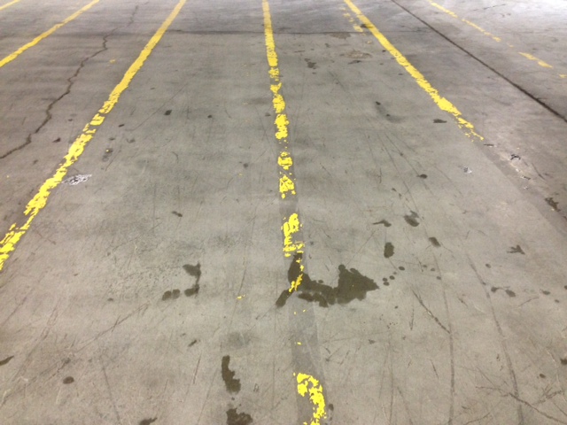

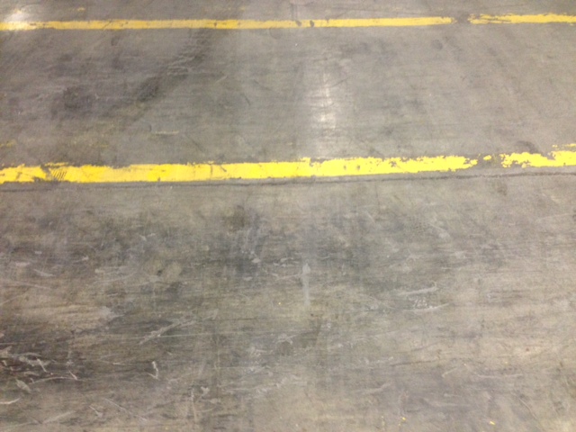

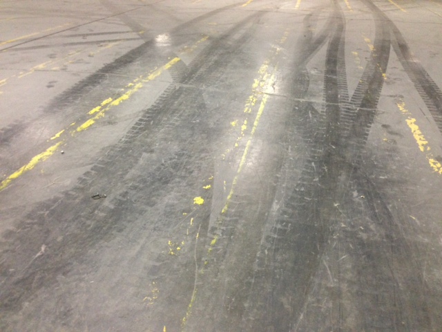

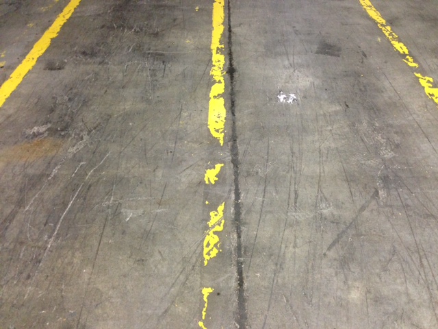

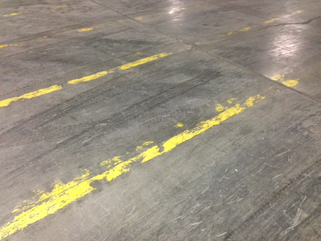

Ok, spent around an hour tonight looking this project over. Took some pics to share. My contact which referred me says they are just looking to have it cleaned up and concrete sealed. I won't get the chance to talk to the co-owner until Monday or Tuesday. Going back Sunday afternoon to do a test area where the worst tire marks are. They are moving their equip/furn in 1st of April and have some pressure washing and painting to be done on the walls first.
The following area is about the medium build up and probably covers about 10-15% of the total
This is the worst and I have to find out if they want the yellow stripes removed as well. This covers maybe 10-15% of total
This is about what 60-75% of what the total area looks like just has a real good coating of dust and grime
This is a general overview of about 40% of the total area and the worst part
I'm feeling pretty good about this right now, I will know for sure after I get the chance to test an area on Sunday. Then once I get my questions answered on Mon/Tue I'll know if we can move forward. My contact said that they were not at all happy with the original bid which tells me they just want it cleaned up real good so they can get moved in. I do know what is going in there but can't share that info at this time. We do have a couple local lurkers in Lexington that are waiting to pounce if they get the chance.
If viewing pics helps with further suggestions that would be much appreciated. The warehouse is not heated it was setting at 54 degrees air temp tonight but I didn't have a surface themometer available tonight so I will get those readings on Sunday as well.

I would rent a dual head riding auto scrubber with a couple of serious brushes, have a guy pulling a 25 gallon sprayer pre spraying in front of you then rinse , go back over with a step or two of twister pads, then use a good impregnator or concrete densifer.

ahhh pics showed a ton.....
i would recommend DO NOT SEAL IT......
if there are lurkers call me....and i can explain this
