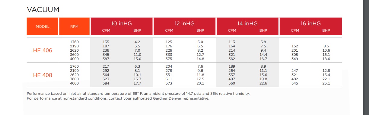

What blower is really needed for single wand cleaning at 100'-150'?
What blower is on the 570? I looked it up online and it said HF408. How would that compare to my 47 blower?

The Peak spins the 46 blower at 3000 rpm, so same exact vacuum performance as the 370 I guess.
So, for an extra $1,500 you get more heat from the bigger motor. Looks like it doesn’t use much gas.

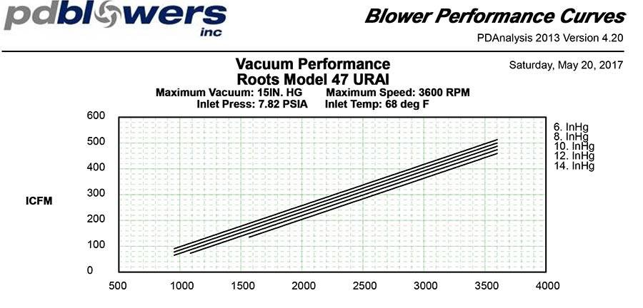

Your trying to create vacuum or remove the atmospheric pressure, the bigger the blower the more effective it is at creating true vacuum, not just air movement
ee-yeah-butt....
fizzicks dictates you can only move so much air thru a straw (the hose and wand) at any given length and HG
On "normal" hose runs , the bigger blowers are over capacity
side note...the 45 vs 47-8 blower debate is similar to the "small block vs big block" engine builder debate
Small block says he'll beat you with RPM's
Big block says he'll beat you with you lower end torque
they're both right....

Any rocket scientists here?
how much air can be moved thru 100ft of 2" hose @ 15hg lift?
You dont understand what I am saying, and that is okay
I think I do, Tom ...and I'm pretty sure Dan does too
but maybe you don't understand what I'm saying ?
the limiting factor isn't the blower on most TMs .
the limiting factor is the volume of air that can be physically be pulled thru a hose and wand slot
a stoopit example of that?
a 68 blower @15hg can't move more volume thru an upl tool than a #2 blower @ 15 hg
because.....the 1" opening (4" x 1/4" slot) is the limiting factor
