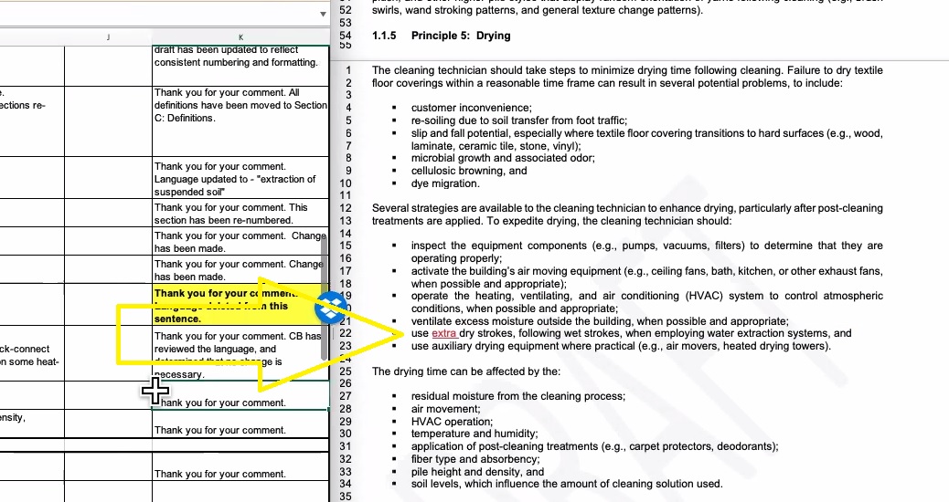

What is an "Extra Dry Stroke"?

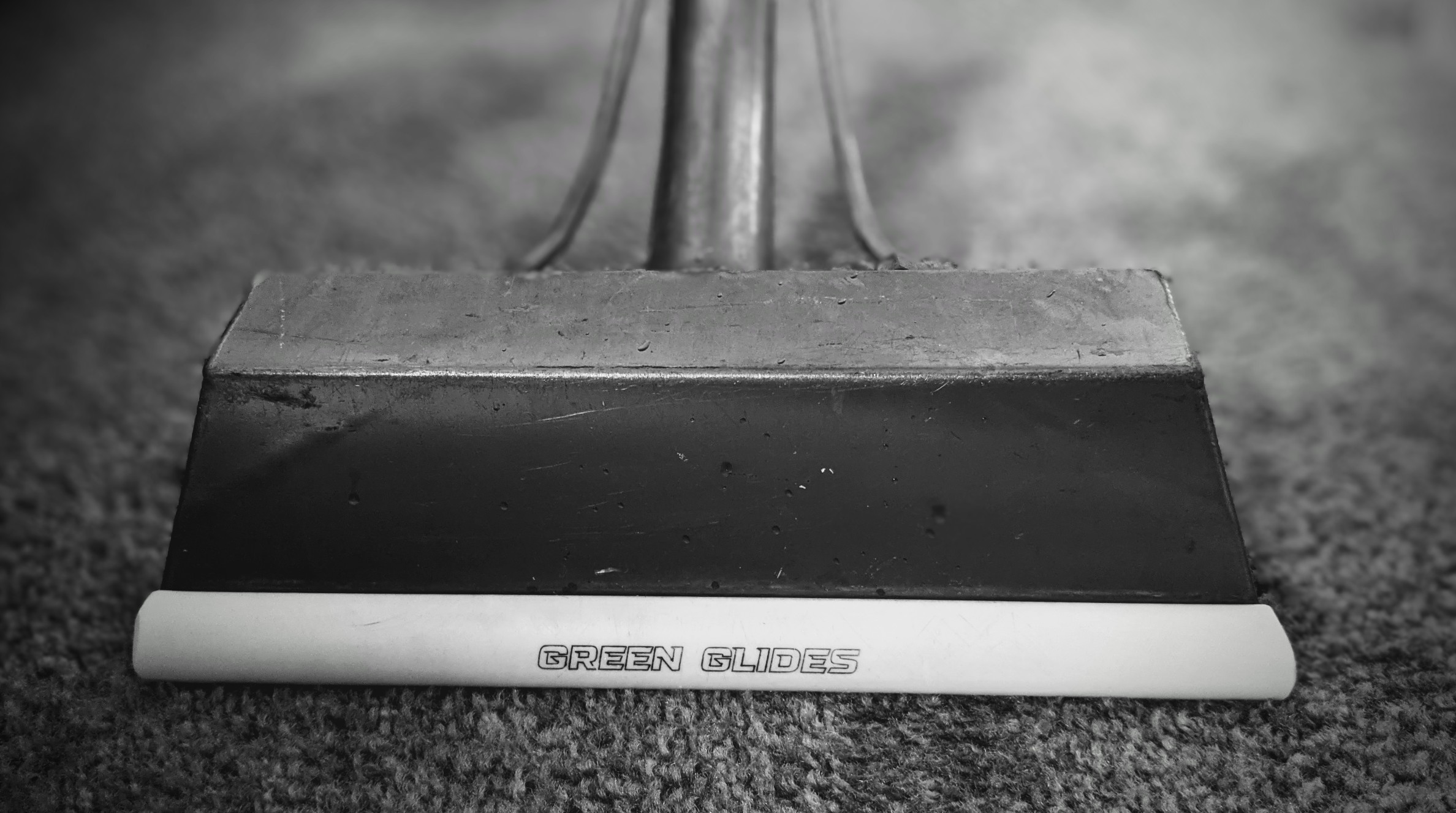

Extra dry strokes for me @ 525 cleaning passes per minute solution on, followed by 525 drying passes per minute, solution valve off.
This is how I can offer the fastest unassisted drying times available.

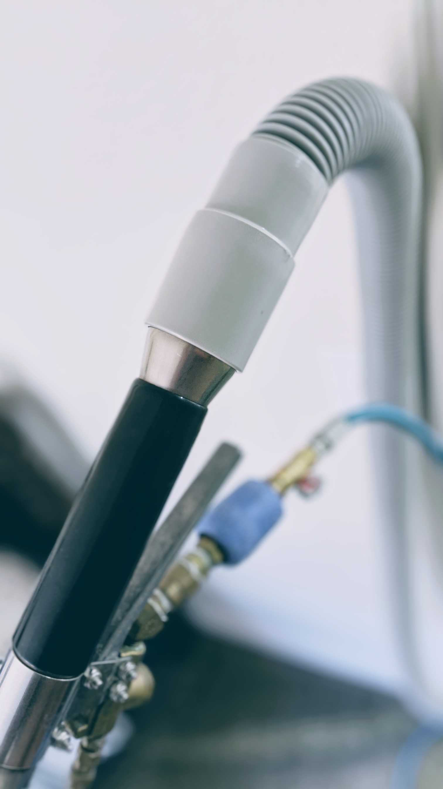

Thats a Joe Valve. Joes is going to pop a gasket when he finds out Sam Miller sent him that.

Standard is 1 wet, 2 dry
Extra dry stroke?
One wet and THREE dry...
Pretty straight forward....
What do I win?
