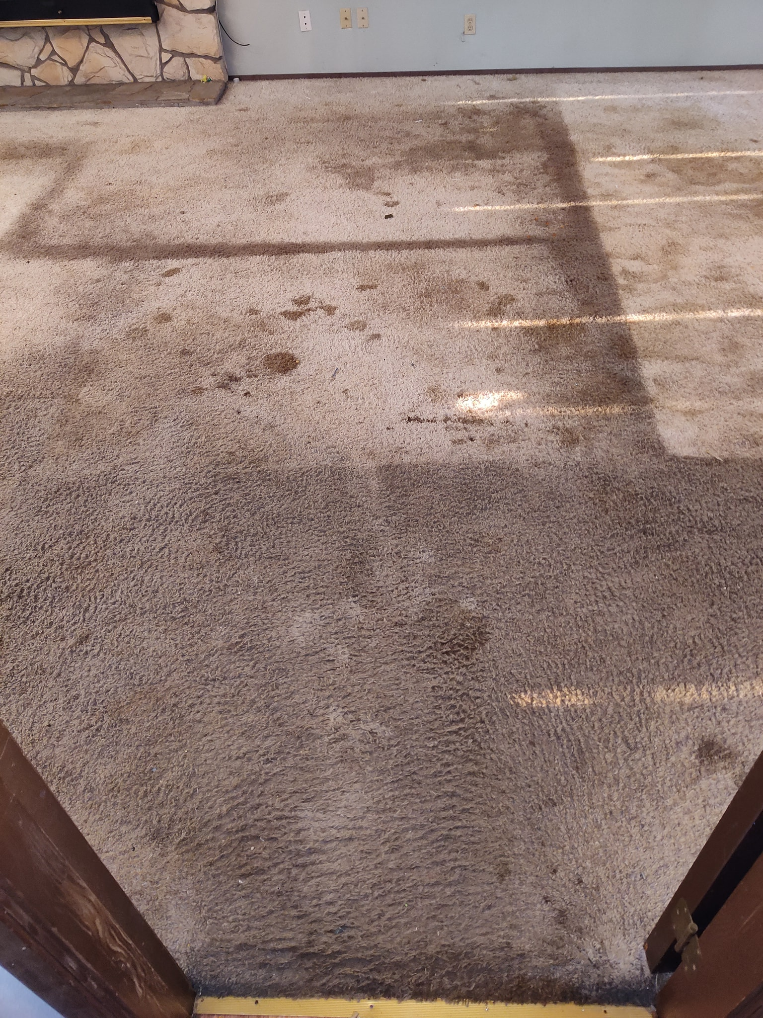

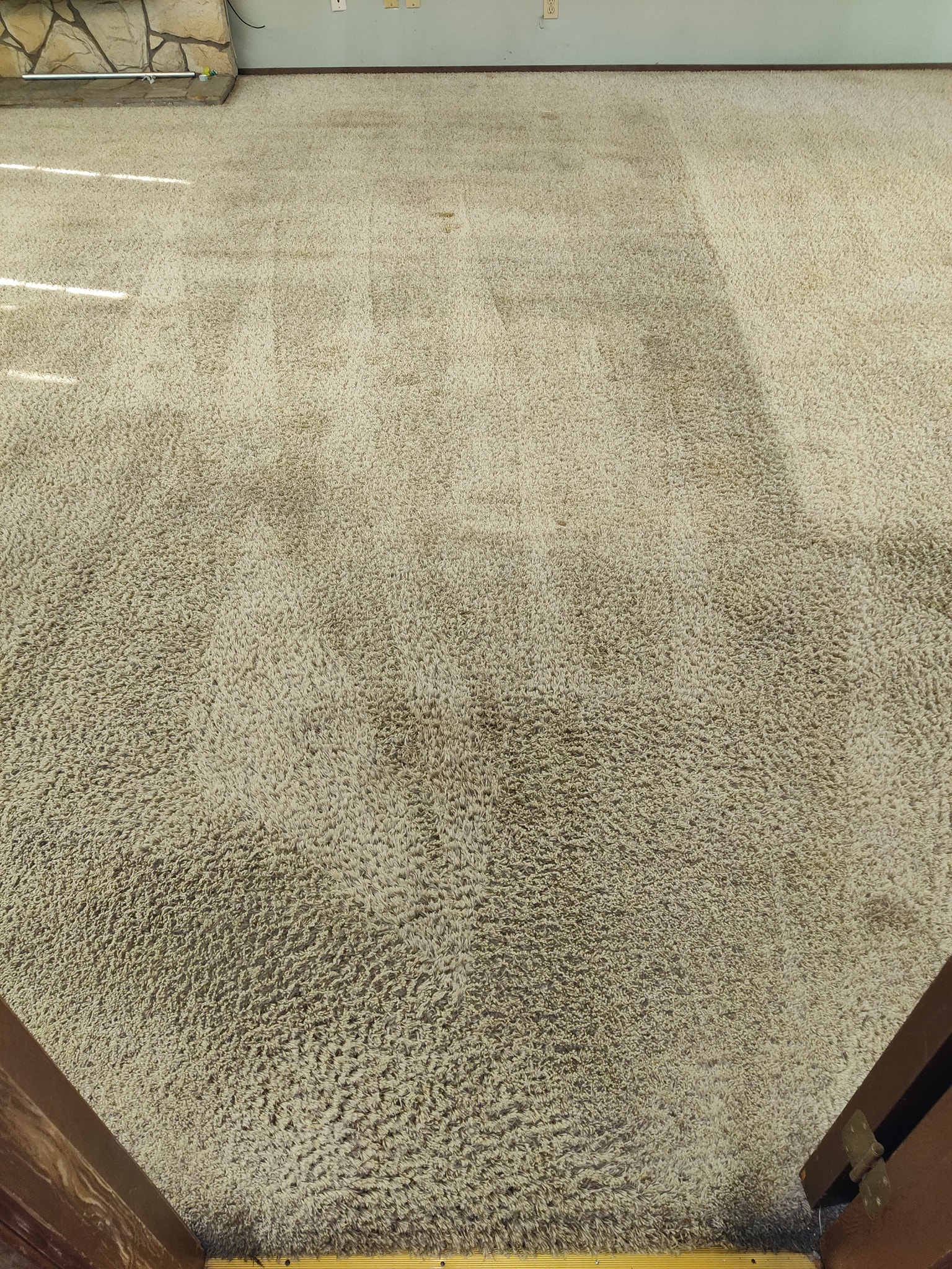

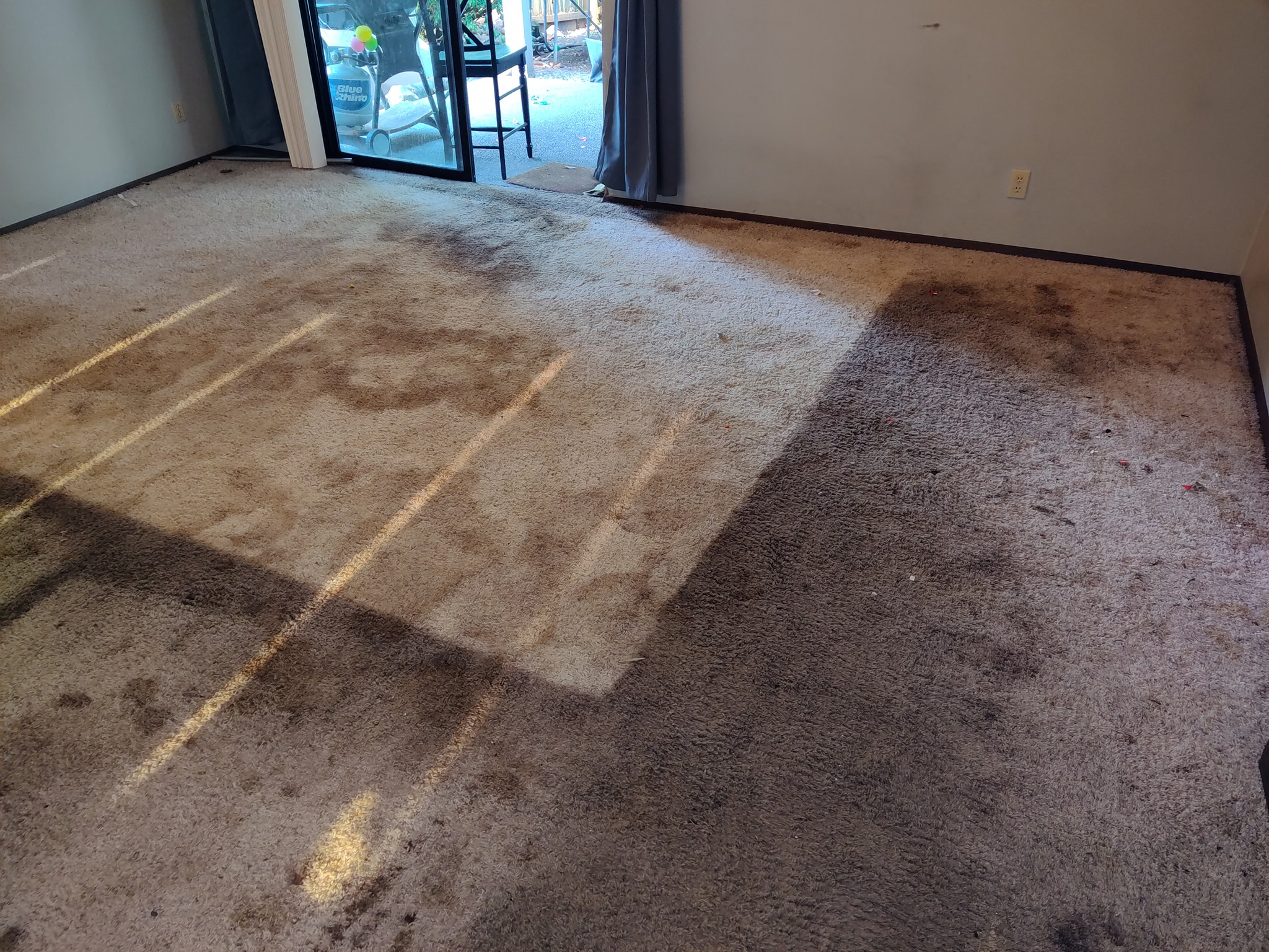

what's your plan of attack
112,870
Hack Attack
Dec 19, 2017
5,620
further south than you
Dan
1/2 full HF with waterbased degreaser, 50% more of whatever high pH prespray you use, 20 min scrub while it dwells then RE
charge more than the carpets worth
Idiotâ„¢
48,122
Prattville, Alabama
That’s extreme but not too far beyond what I deal with on a semi-regular basis.
1)Prevacuum thoroughly. (My vacuum would be cleaned and sanitized after.)
2) I would cover all the soiling possibilities with a prespray of Bio-8, D-Gas and PSor.
3) Rotovac my way into the room with a brush head.
4) Edge the room with a stand up filtration tool.
5) Wand my way out
Side note:
As I’m vacuuming, if I note any stains that I think may need dye stain remover and steam, I’ll do those before prespraying the carpet.
Jobs like this OFTEN require follow up cleaning and ALWAYS REQUIRE clarification of what can be expected.
Average cleaners will fail at these jobs because they won’t purchase the necessary equipment, don’t have the proper chems and are hesitant to price high enough to cover all the time necessary.
I can almost always clean these type jobs well enough to allow another rental season of use and save the home owner about half of the replacement costs.
I seldom encounter these jobs on owner-occupied houses.

30,652
advise them it needs replaced.
Advise them there will be an additional salvage restoration fee.
Advise them there will be no urine restoration.
I'll throw some smelly good stuff on is all
if they say proceed;
vac
Mix PowerBurst at 3 heaping scoops per gal, toss in 4oz per gal of UltraPac 711 for good measure .
Hose it down at a gal per 100-150sf
dwell while the scrubber and hoses get set up
roto scrub w/stripped bonnet
(red VCT pad might make that rag come apart)
Saturated bonnet is safe
wand makes a dry stroke first to suck up the first bit of pre-spray sludge.
Then flush/rinse extract with incredibly slow (to most) back stroke .
followed by slow forward and back dry pass
move over half wand width.
repeat
Done a million of 'em
13,371
I've cleaned section 8 jobs for 15 years.
I've cleaned a few of these.
Vacuum well soak with a good high ph cleaner scrub with crb and extract.
And I do mean soak it. That one room would get half a hydroforce 4 to 1 about 3 inches away from carpet.
30,652
and I still clean carpets
and can still clean better than the vast majority
and better than 67.893% with a POS porty and AW29 wand
30,652
It's not BS when you can back it up
never used a RE except the RX-20.
The RE scrub in and wand out would be killer I'd expect.
I've always run 2 man crew, rotary scrubber is more efficient
(never had AT capacity to run two floor tools)
