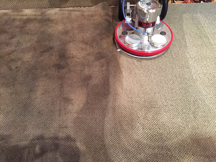

Not necessarily Chris. Here's what we did with VLM at the Experience show last week. The carpet had been pre-loaded with motor oil and potting soil. Scrubbed with Microbeast bonnet and Releasit juice. Results were impressive!
Oh yeah, I saw that and I don't know if I could have done that well with the truck and a pre scrub honestly. But I do know that I couldn't have cleaned it that well with any VLM combo I have ever tried, hence my frustration with the whole process. Maybe the hard water in this area interferes.
BTW Rick, have you ever tried the Taski dry foam machine, and would it work with your products?
You could've got the same results. There was no magic. It was simply a combination of three things. 1. A spicy mix of detergent. I mixed the Punch and DS2 strong. 2. The Microbeast bonnet cuts through dirt like a razor. 3. The orbital action of the Vario scrubs really well. That's all there was to it.
