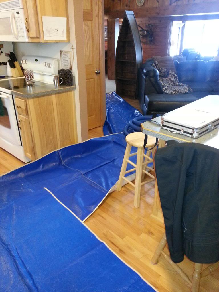

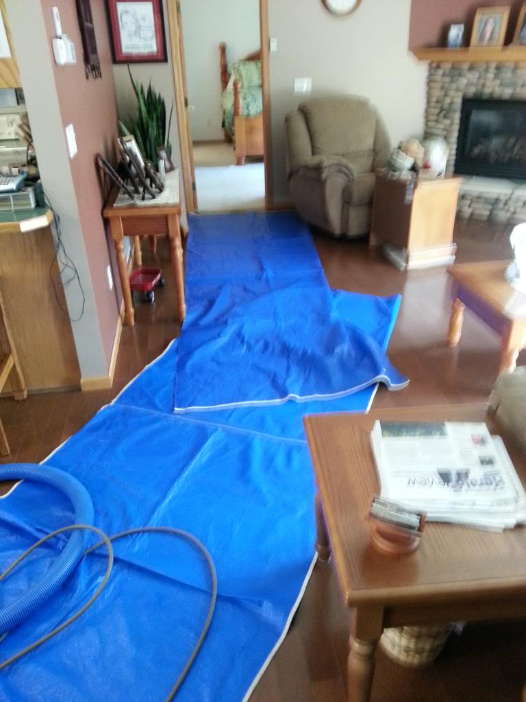

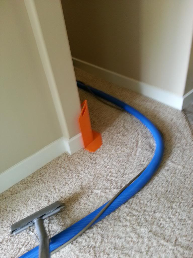

We cover hard surfaces that we cross with poly-canvas drop clothes. Here are some pics before we had the corner guards also in place. We put the corner guards behind the drop clothes for added protection.
Here is also a link to the type and brand we use. http://www.amazon.com/Essentials-4-...ials+4-feet+x+12-feet+canvas+drop+cloth+hw412
