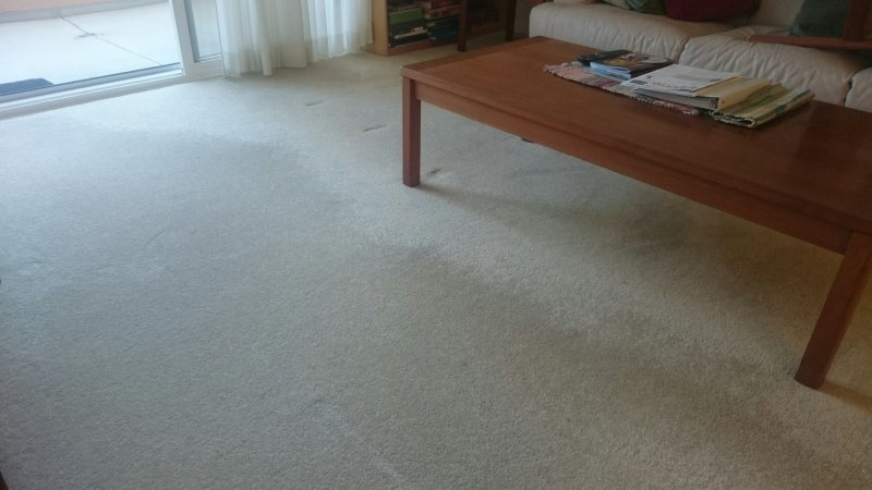

"Why can't you clean this away?? It's only two years old and this shouldn't have to stay this dirty looking... "
Then you try again explaining that they were sold a pos carpet that is pooling/pile reversing like crazy.
This is just one example from this home:

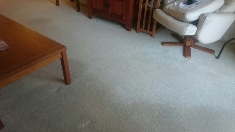

And some more:

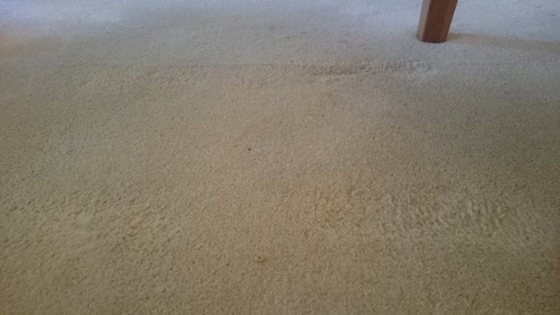

Chair legs destroying the two year old carpet. Again: tough luck Mrs Piff!

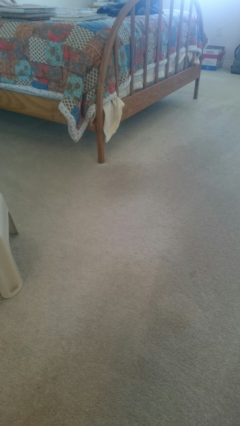

And another room:
This carpet is not even that dirty. It's pooling that makes it so bad.

Unfortunately I see a lot of this too. I hit it with the crb. At least they can see I did all I can.
If you handle it right they start feeling sorry for you trying to fix it.
Cleaning Professional
15,253
That's why I go thru the areas before hand and point out things I see. Sometimes customers see it as a excuse and pass on my services...............in denial............SO FOOK DEM ALL!

These were all taken during the pre-cleaning walk (you can see the cheerios)...I did dry groom out the big pooling area to show them what I was talking about.
I was pointing out all the problems and explained what can and cannot be changed.
I ended up doing the job and did use the CRB too. On carpets like this nothing really will make a big difference...
