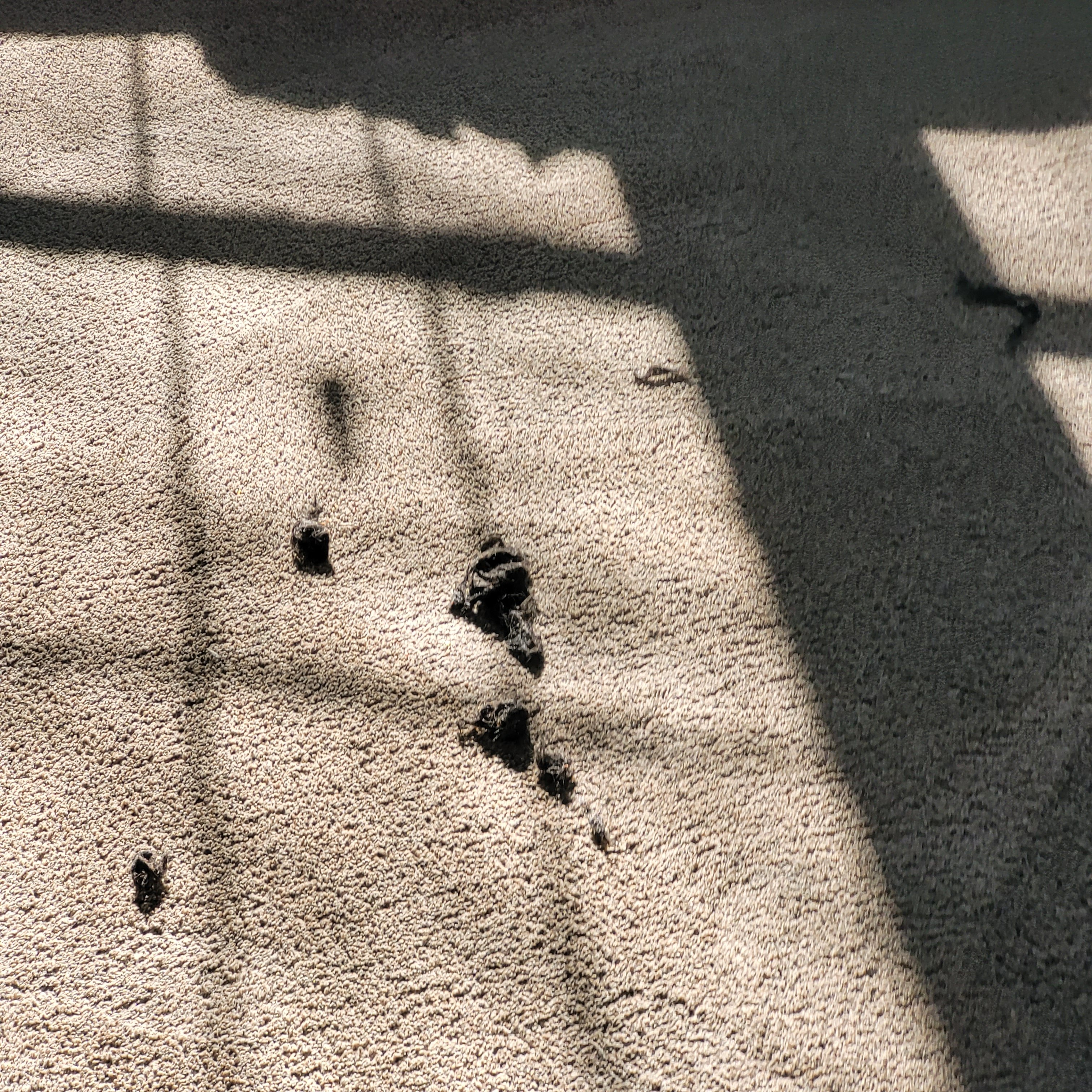

You're right, your instructions are skunk, I mean sound. I have to agree with your assessment about the wicking. When using CRB, I always get stuff flying off the surface( usually dog hair mixed with human hair and mud in the same areas. My theory is that beat-down padding gets saturated with soiled water and since the carpet is drying from the bottom up, all that scum has a tendency to resurface. I've seen the same pattern over and over, and I wish that I could turn jobs like this down.
Here is the pick from using CRB at the transition points, to support your assessment.

11,551
This is old, hahaha but customer tend to work on diarrhea themselves.
They usually start my wetting and using a do it yourself machine spotter.
They end up sinking it I to the padding and the stain comes back up wicking.
Then they call you the next day and it's still wet.
Best to wait a few days so the wicking stops before attempting to remove.
I tell people scrap excess and sprinkle baking powder.
The baking powder will absorb and stop the sinking stinking.
Then work on it after it's dry.
