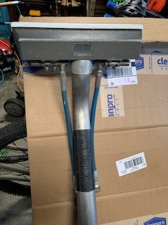

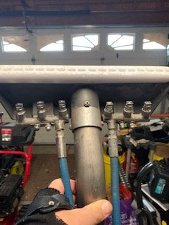

Yes, I have one but cant recollect if it has metal lips, but I highly doubt it
take the glide off and it will be obvious
I don't want to take the glide off of this one I was just wandering who makes it. Here is the backside of it.
