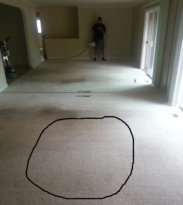

Do you keep Sodium (meta) Bisulfate on your truck?
you should..
in that circle was some horrible yellow discoloration caused by off gassing trapped under a big cheap Costco rug.
After dry vacuuming, add an ounce to a quart of hot water, hose it down and 50% of the time the yellow will be gone by the time you bring in the prespray.
DO NOT CHARGE THEM!
Just enjoy their reaction and let them spread the word..

is there a street name for that? i flunked chemistry - seriously. if i had any idea i would need to be a chemist to do this job, i might have thought twice... amy
San Francisco, CA
You can buy it straight
or in a pinch, any of the "white cotton" (Haitian Cotton) cleaners have it as a main ingredient.

ummm....where is the after pic?
and did you leave saying "yes mam...I competely rectified that barely noticeable issue....no charge......no mam....nothin I can do about those actual dirty spots"
