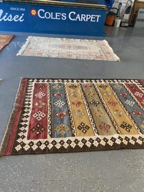

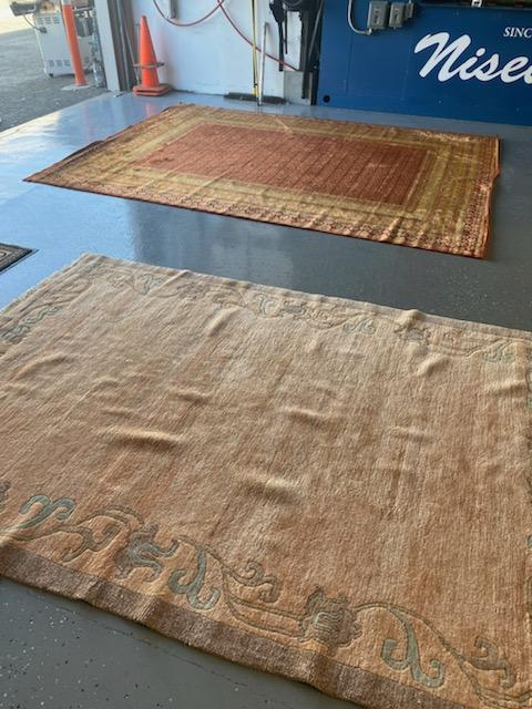

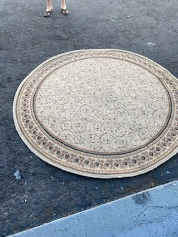

would you clean these in the home?
116,365
red one in back is 100% Viscose
tan in front is wool...
all wool..
Olefin
demo rugs for the Vegas MF IICRC class...
OP and CRB/compound on all of them...
Reactions: icleancarpetz

The round one can be cleaned in the driveway. CRB and dirt swirling will actually take longer than extracting, so why not do a better job of cleaning?
