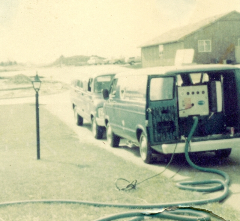

our first TM back in the 70's was Steam Genie's Hydro Genie II it was set at 14-inches of merc. We never dual wanded but ran as much as 400-foot of hose off it. 24-hp Onan drove 2-Suterbilts in series.

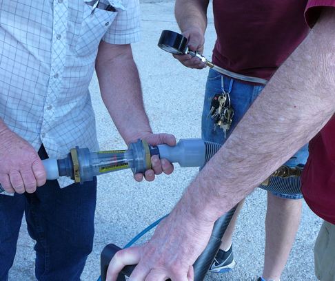

I disagree quite strongly.
Unlike most TM manufacturers, we tested CFM at different hg. lift levels earlier this year.
Using the same 14" wand and hose on a plush carpet with 35HP/ #47 blower TM,
the CFM at the wand decreased from 260 CFM @ 16" hg. to 200 CFM @13" hg .
That was a loss of 23% of actual CFM from a reduction to 13" hg.
We were using a calibrated CFM meter and digital 4 digit lift meter:
CFM increases with an increase in LIFT.
More Details:
http://www.cobbcarpet.com/zen/index.php?main_page=document_general_info&cPath=63&products_id=5319[ QUOTEarrow-10x10.png]

Tri lobe or dual lobe Blower Larry ? The charts state the opposite of what you are saying.
CFM goes up, lift goes down
CFM goes down, lift goes up
I guess it depends on what blower you are testing
It was a brand new dual lobe #47 Sutorbuilt.
You are seeing a slight loss of Maximum CFM due to lobe clearances in the blower.
You will not see 300 CFM thru the wand at any time.
