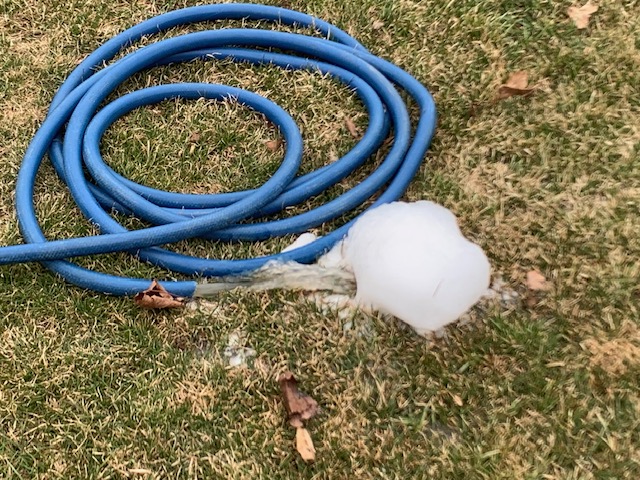

The way I clean with HWE is very similar to washing your clothes. Wash cycle/Agitation/rinse cycle. Apply cleaning agent, CRB, rinse with water and groom. With the CRB doing most of the work, I can reduce the amount of cleaning agent and water pressure.
So when I clean for a repeat customer. At any point, I can remove the hose cuff off my wand and I will see just water inside the hose, extremely little or no white (cleaning agent).
Today I cleaned for a past customer that I used to clean annually. Last year she tried a VLM cleaner. She said it looked good at first but then kinda *dulled out*. When I started cleaning I noticed a slight reduction of suction, so I take off my cuff and see lots of white (cleaning agent) so much so in fact that from that point on I just presprayed water because there was enough cleaning agent in the carpet from the VLM that I just needed to activate it.
Pictures say a thousand words. Again, all I presprayed was plain, softened water.
Lots of VLM cleaners use the wrong products or too much or too high a dilution rate, just like many hwe cleaners. It's not necessarily the method, it's the cleaner.

In my experience, I often get residue and foam from previous HWE (especially from those who use home machines), so I would not judge the cleaning of HWE merely on what I get from previous cleanings. I do not know if the homeowner used Tide or Simple Green, or actual carpet extraction solution. I will say, when cleaning glue-down carpet, the low moisture method works too well! What I mean by that is, it does not re-soil at as fast of a rate as HWE, and they wonder why I come back on schedule to clean what does not appear to them to need cleaning. As it has been pointed out, there are many products out there, and many do not have crystalizing polymers in them. When I first started with OP, many of the juices that were the rage did not have much or any in the way of crystallization.
