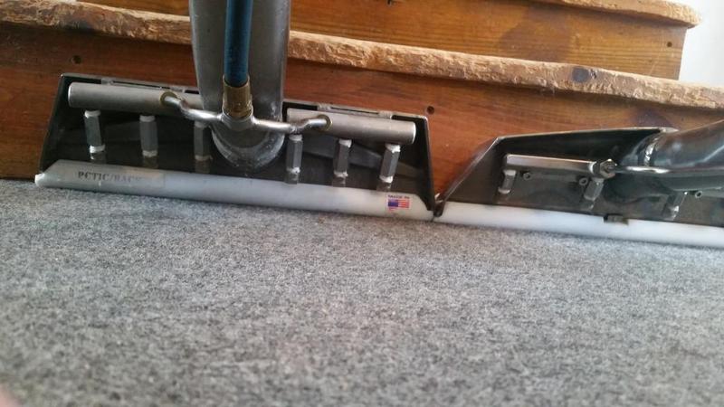

Call me slow or behind the times but what is the advantage of the wand jet extenders? I stopped trolling the boards for a while until recently..lol
11,197
Grand Rapids, MN
Partially compensates for the additional height of the glide....
Keeps the heat closer to the fibers...
Better control of spray pattern in some instances....
I know I am missing some things....
Just shooting from the hip here quick
48,053
Prattville, Alabama
In my opinion, extenders are worthless. The only reason I use them is for the check valves. (I prefer in jet check valves, but that's a long story.)
They place my jets too close to the carpet and cause jets tracks on some carpets AND they still don't prevent overspray. I use them on both my Greenhorn and my Titanium and they cause the same problems on both wands.
Reactions: Larry Cobb
Aug 20, 2013
594
NY
Ralph Pastorelli
Someone has issues with anything he touches and thanks for un friending my on FB Marty ..lol
San Francisco, CA
I totally agree with Marty. The only advantage to the extenders is less dripping.
Other than that I find them to be disadvantageous to cleaning. Too close to carpet and potential distortion issues, as at times (thick fluffy carpet) and at different angles they can be way too close to carpet.
That extra inch or two closer to the fabric is not going to make any difference in heat. That's laughable. And anyhow, a slight increase in the droplets size (o2 versus 0.15 etc) will do ten times more for heat.
I removed all extenders and in my opinion, my wand cleans much better.
Yes. It does drip.
Therefore an ounce of conscientiousness and a towel (White. Clean. Please. Need I tell you everything?) nonchalantly, dangling from your back pocket, are your friends, my friend. Or should they "unfriend" you?

At that point, why not just go for a slot then and eliminate the "dead spaces" altogether?
I have never found them to be "clean streaks" but actually pile reversal from the intense vacuum. When groomed they disappear.
Of all of the glides, the hybrid leaves the most aggressive pattern. Those little mini-slots really cause some mean pile reversal on dense plush carpets.....and if it's a wool, acrylic (or other wool-look fiber) or silk I recommend NOT using a hybrid on them because the pile reversal can be nearly impossible to groom out. For those I recommend a slot or a rug glide, which is a hole glide with the holes sunk in a channel to leave a smooth finish.

Hey Lisa,
The groove with the recessed holes is for what benefit? Is that just to have a smooth clean finished product, does it create more agitation, etc.
What is the direct comparison of a holed glide with and without the groove?
