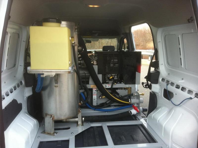

The Transit Connect has a similar issue, but it's not just about the holes. The floor itself is structurally insufficient to adequately anchor and attach such a dense, heavy object as a truck-mount with conventional bolt-through-frame means. Sapphire uses/provides a special sub-frame chassis, of their own, in order to distribute the anchor and attachment forces, so that the Transit Connect can accommodate a TM then placed on and bolted to, that auxiliary chassis. It's a matter of engineering and time to do so, the same for the full-size van. What may be unknown is just what kind and size TM can be practically done. It may have some limitations and not all TM manufacturers may invest the resources.

A simple metal frame can be constructed and welded up by a novice, Using not only the seat bolts, but the factory supplied anchor bolts.
IMO I like this idea for any van, no climbing undder the van, and a more secure install. + no holes all over the place.

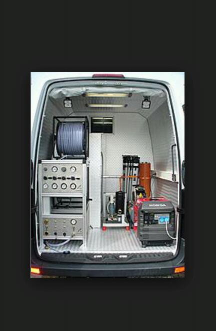

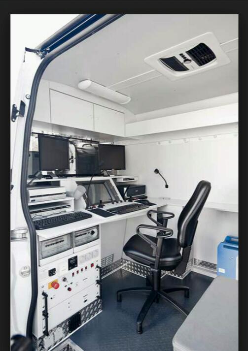

Those of you believing this nonsense, that you can't install your crap in a cargo van that is being manufactured and sold for these type of specific purposes- need to check yourselves.
Our industry is not the only one that will need to bolt down equipment and all kinds of other things in a cargo van. I wouldn't worry about it too much. Look at what we installed in vans in Europe: my dad's company installed many many offices and equipment loaded back ends in vans that were used for pipe line inspection.
We were the distributor and official service for 3 different manufactures. IBAK Gmbh, Rico Gmbh for example.
Look at some pictures of installed vans and you'll see what I mean.
