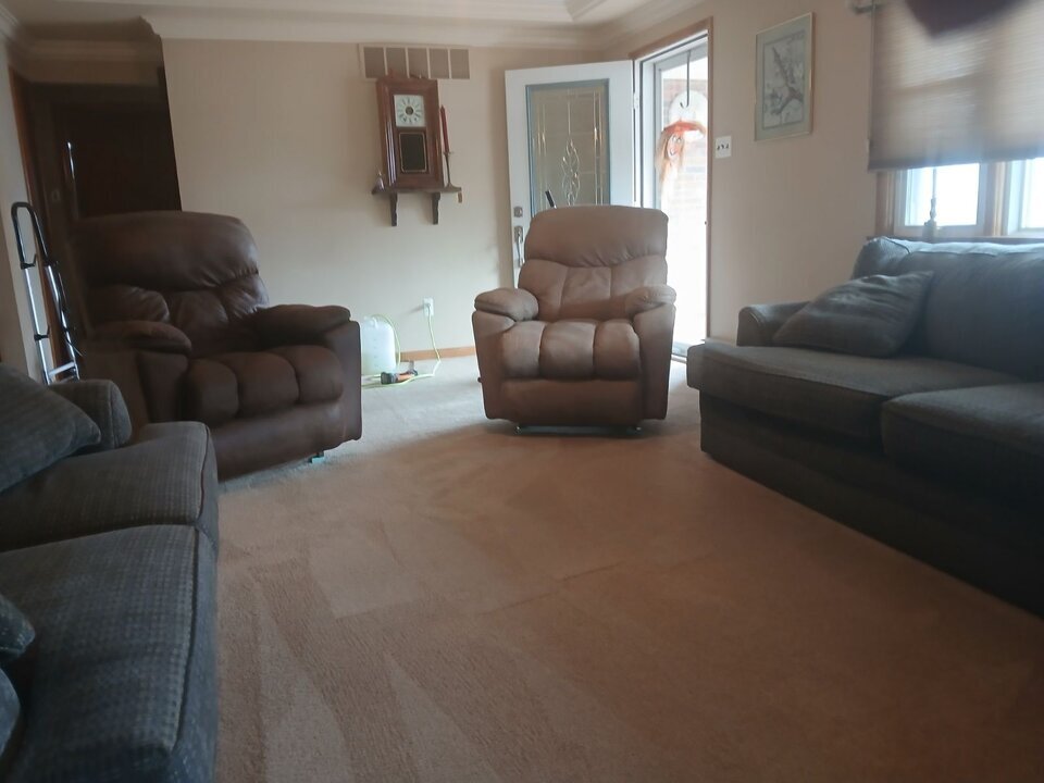

Long time customer. Living Room and Hall are always bad
Used VacAway Double Trouble 9.5 ph at 2 oz and 4 oz of Detonator (Peroxide) on carpet
I also cleaned the 2 Chairs Sofa and Lveseat
Thick dense carpet Clean and DRY in 1-2 hours

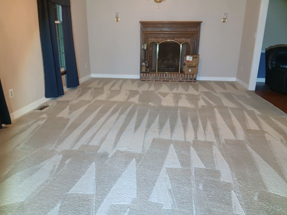

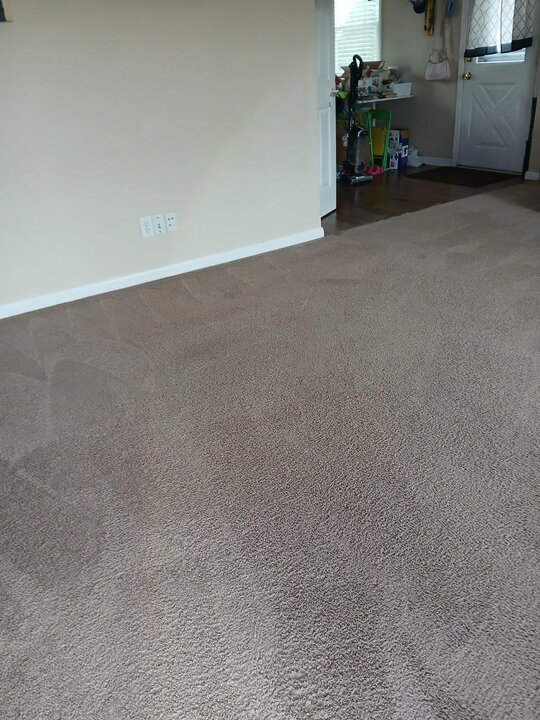

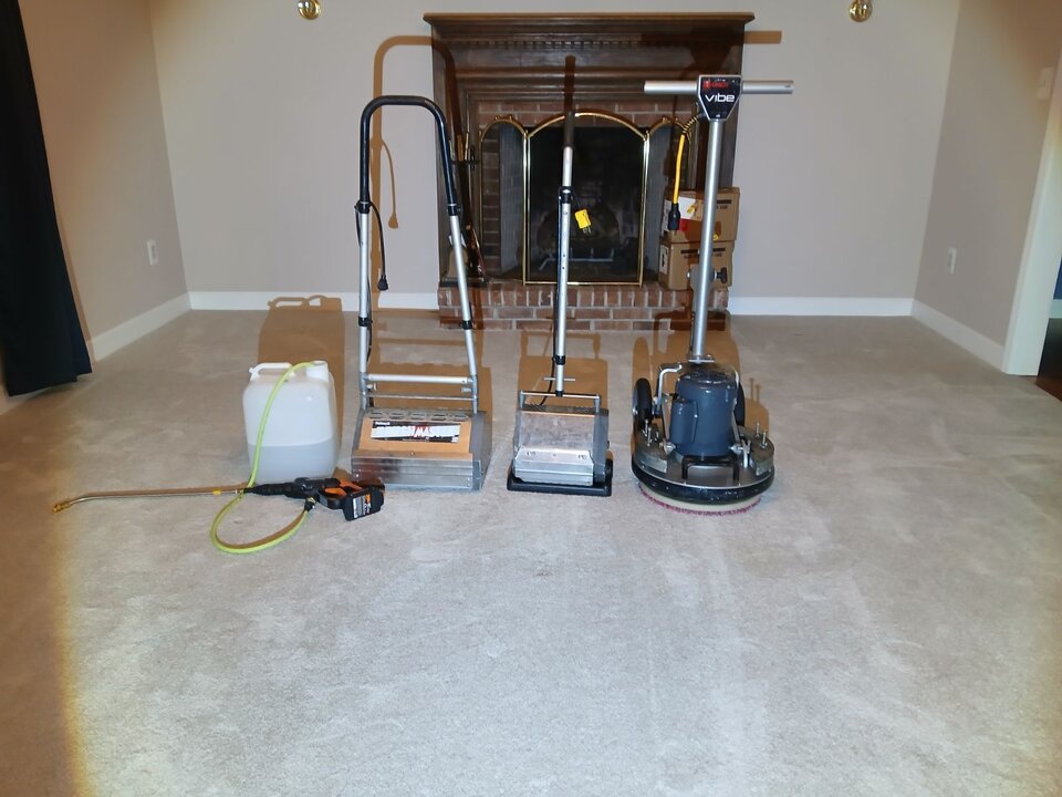

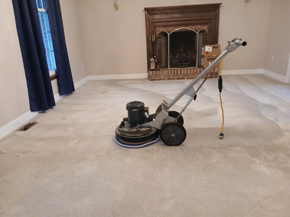

One of the girls that works at my Apt Complex is moving into a new home and she asked her favorite carpet cleaner ME, to freshen up the carpet before she moves in
Nice Big House with Nylon carpet
I used Carpet Details at 4 oz and Detonator ( Peroxide ) at 4 oz
WORX Sprayer with 8003 Teejet
Light Blue Microfiber Bonnets and Tankless Vibe with 3 weights on each side
Soft White Brushes on CRB's to scrub and Groom
Life is BETTER using the VLM Method !!!
