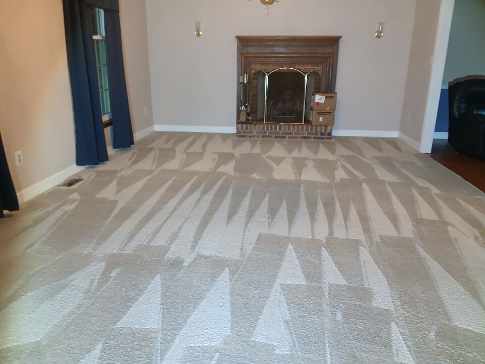

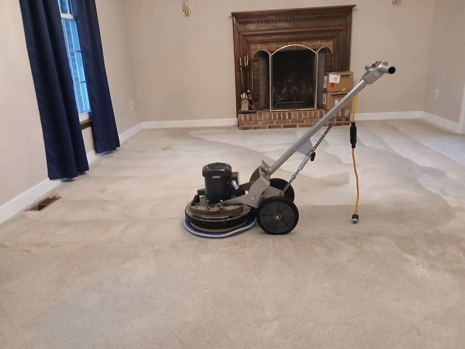

Nasty day outside
35 degrees Heavy Rain Wind Damp Cold and Miserable
But my Van Doors are closed and customers House Door is closed. No heat getting out or cold getting in
Working in Bad Weather is much easier and better using the VLM Method
And carpet will be dry in 1-2 Hours

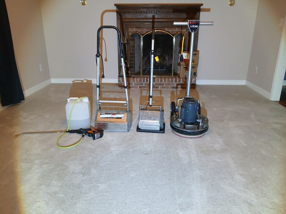

One of the girls that works at my Apt Complex is moving into a new home and she asked her favorite carpet cleaner ME, to freshen up the carpet before she moves in
Nice Big House with Nylon carpet
I used Carpet Details at 4 oz and Detonator ( Peroxide ) at 4 oz
WORX Sprayer with 8003 Teejet
Light Blue Microfiber Bonnets and Tankless Vibe with 3 weights on each side
Soft White Brushes on CRB's to scrub and Groom
Life is BETTER using the VLM Method !!!

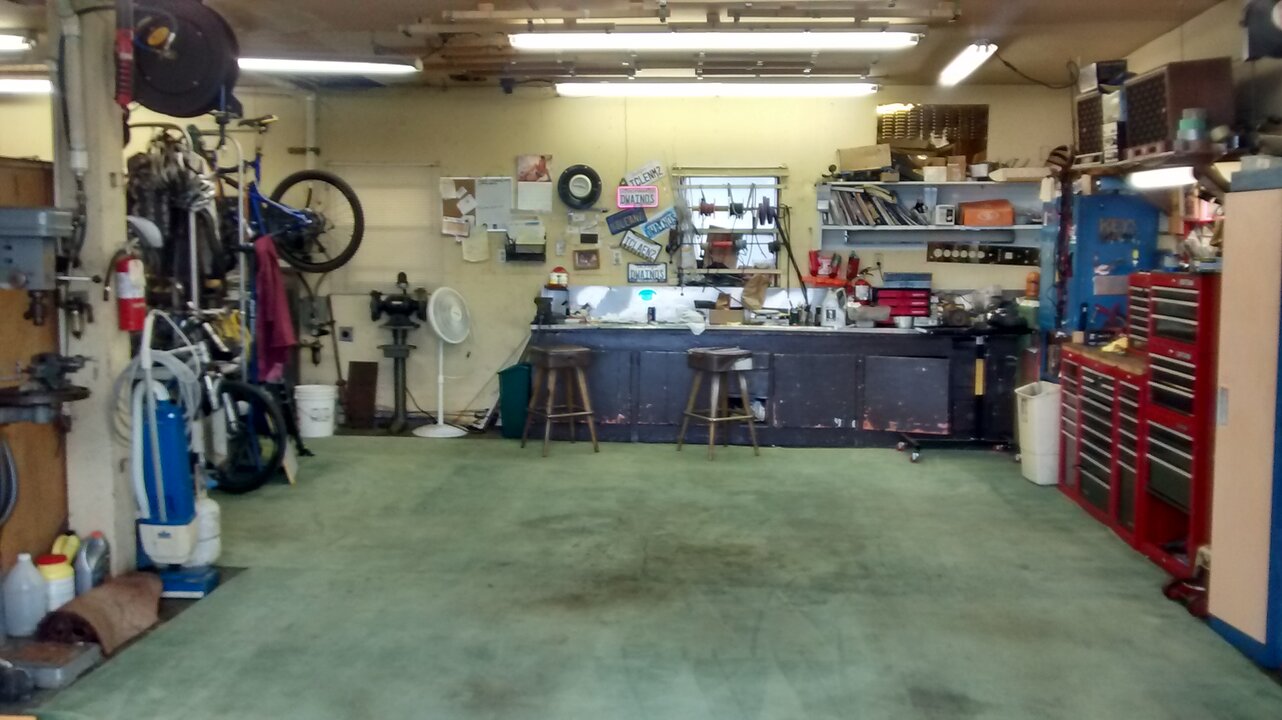

Oct 25, 2016
3,216
Swani
Living The Dream, when you pre-spray at 400 psi do you think that you get the backing of carpet and possibly the pad wet ?
I don’t use an in-line sprayer much these days, though I will in certain situations. I’m pretty careful and controlled with how I apply pre-spray, but to answer your question honestly, yes, I’m sure that at times the backing and even a bit of the pad get wet.
frank fratto
Jan 27, 2018
501
frank fratto

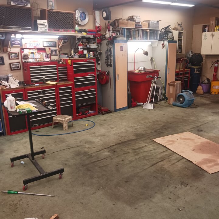

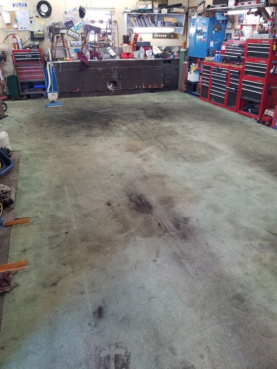

If this guy takes the challenge, we could certainly use a good judge
That carpet would be fun to clean! IT would take a minute or two to get it to look good. But i think i could make it happen.
In last 45 years of cleaning, i have done one or 50 of those , not hard to get it out ! Steam or VLM.
Dwain, thanks for the offer but living in Florida, maybe next life! "Remember, it's only 1 inch of carpet fiber .We are not flying to the MOON!!!

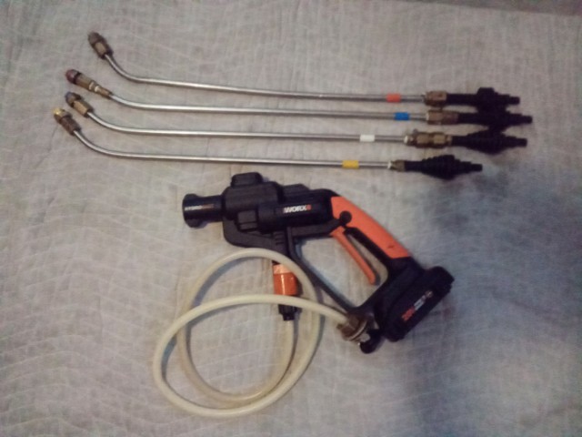

Living the Dream with TOTAL Honesty
Thank You !!!
Have you ever tried the WORX Sprayer ???
If I was still HWE I would be using the WORX
They are reasonable priced and last a long time
You need 2-3 batteries just in case but one battery usually lasts all day, and you need to charge at the end of the day, but still worth it
Adding a Multi Sprayer Wand to WORX and teejet makes it the BEST Sprayer for VLM or HWE. My opinion
I have different wands with different Teejets for every situation I run into
I mostly use 8002 or 8003 but have 8004 8006 for big rooms so I can move faster or for trashed carpet when I need to put more solution down

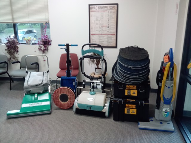

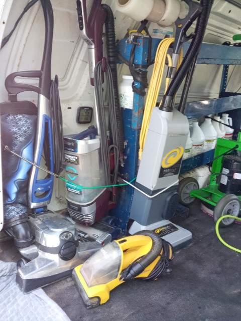

I probably have MORE money invested in vacuums than anybody here
How many guys here have a 28'' vacuum for big Commercial Jobs
Do you a 28 '' Vacuum ???
And I have more vacuums in my basement not in the pictures
Do you have a vacuum
How Many
Do you pre vacuum
Let's see your vacuum
