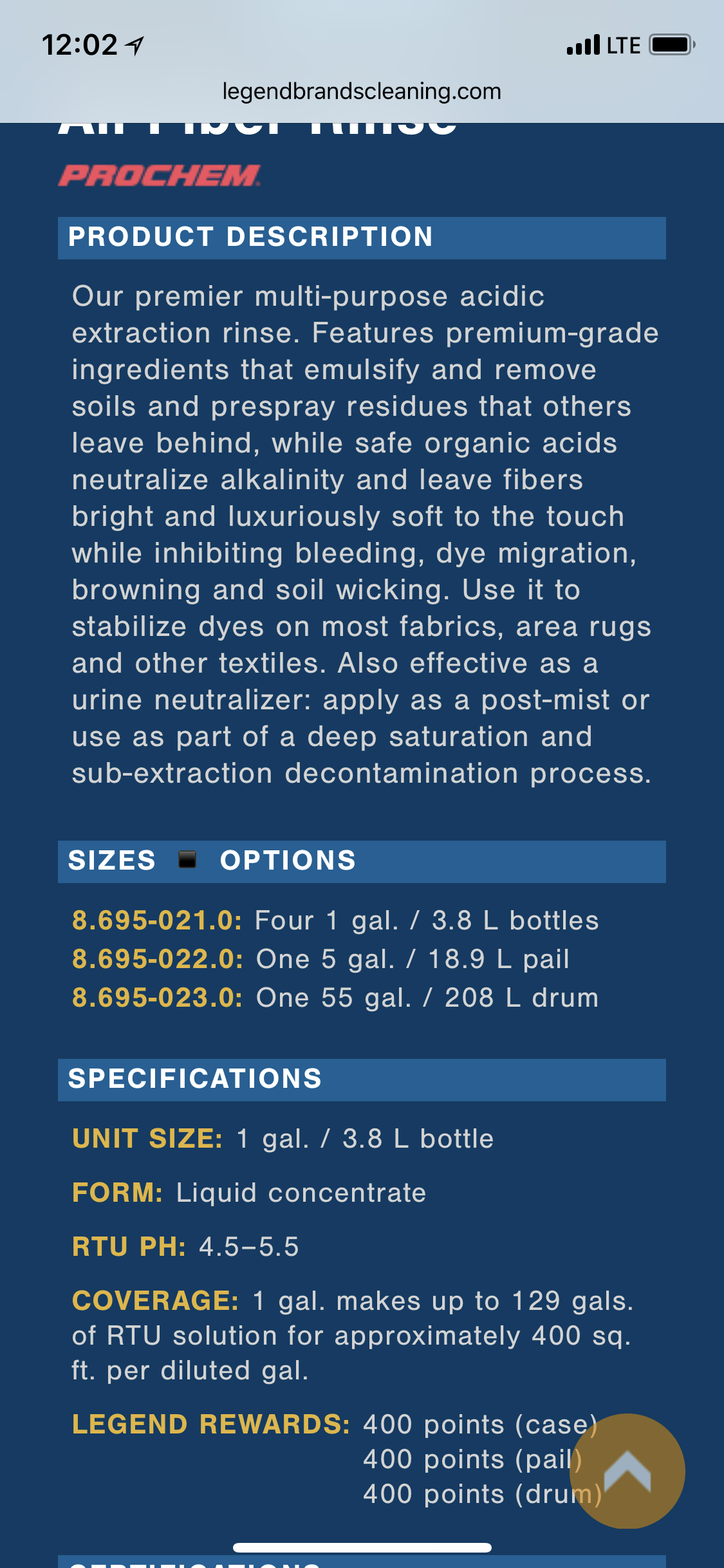

Yes, I'm wonder this and if deemed ok to use how to find the dilution ratio. My acid rinse is 1-2 cups into 5 gallons but then metered at 2 gph

Most rinse products should be diluted at either 1:320 or 1 :640. Use 1:640 if you have soft water. 1:320 if you have hard water. Somewhere in between is OK for most.
100 gallon fresh water tank would need somewhere between 20 and 40 ounces. A quart would be a nice round amount.
