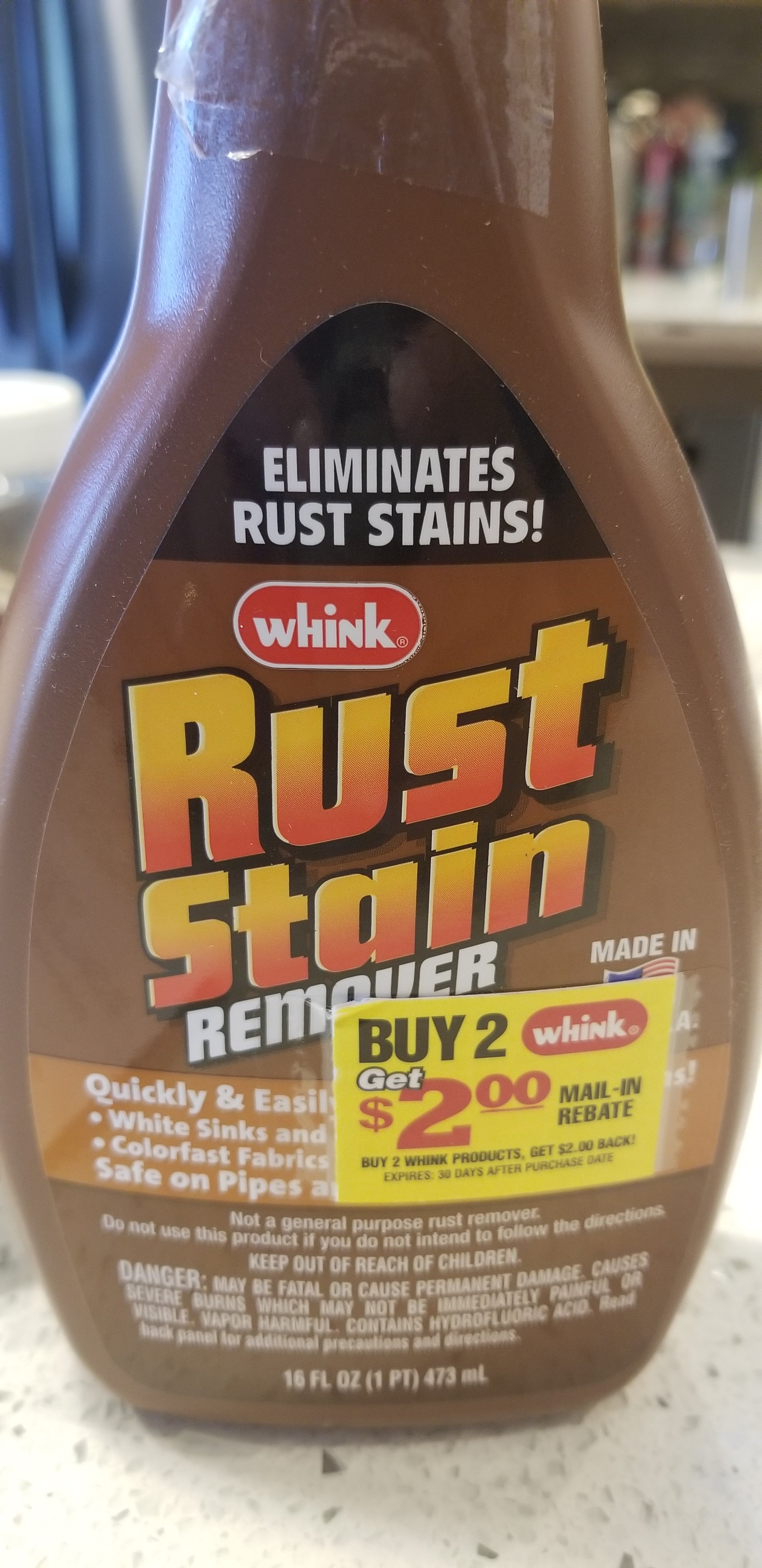

Am I an idiot for buying this?

It works.
It also creates all the collateral damage that Mr C mentioned above.
When customers worry about the "dangerous chemicals" you use, you can rightly point out that there are more frightening products that she can buy at the grocery/hardware store than cleaners routinely use.
This is such a product.

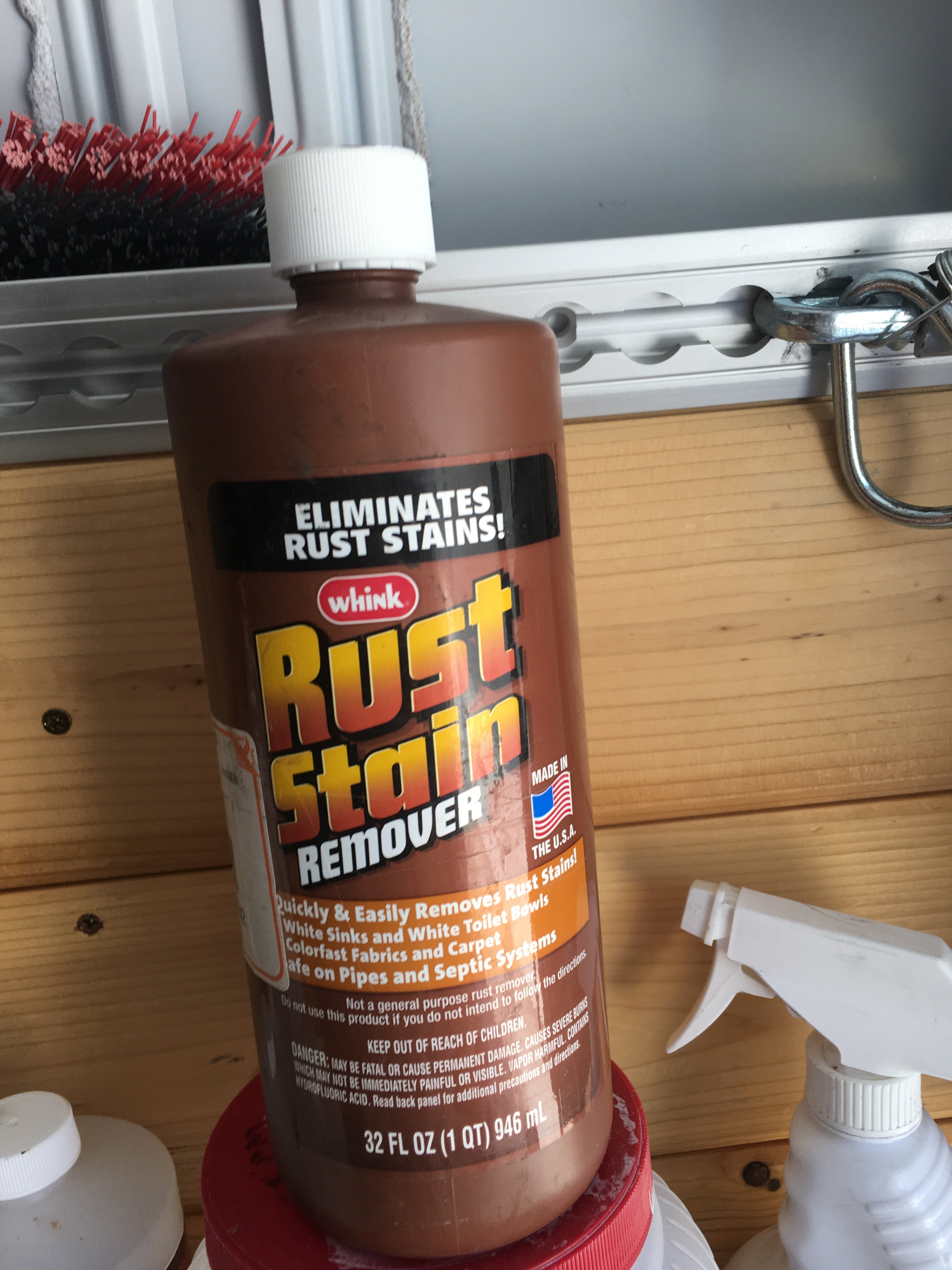

Use it very carefully, and ALWAYS rinse the area that you applied it to very well!
I use it myself, but I would be hesitant to let employees use it unless they were absolutely aware that it will etch glass AND WILL EAT YOUR SKIN WITHOUT ANY NOTICEABLE PAIN.
So DON'T ever GET ANY ON YOUR SKIN!!!

that IS your daddy's rust remover
it ain't kid stuff
careful with it around patio sliders ...it WILL etch glass as Jim mentioned
ask me how eye-no
don't forget to rinse well

Hydrofluoric Acid was banned in Australia a couple of decades ago.
If you get it on your skin, you may not feel it until it attacks your bones, as it chases the calcium.
Then it's amputation time.

Yes you are an idiot. I got some on my fingers once. Lost both fingernails and had my fingers opened to the bone to drain and inject calcium to neutralize. There's much safer alternatives like ultrachem clean. Take a look back and read my post and see my pics with clean blasting rust. It doesn't work every time but it beats the crap out of risking your health and your customers health.
Yea indèed that's an idiot chemical.

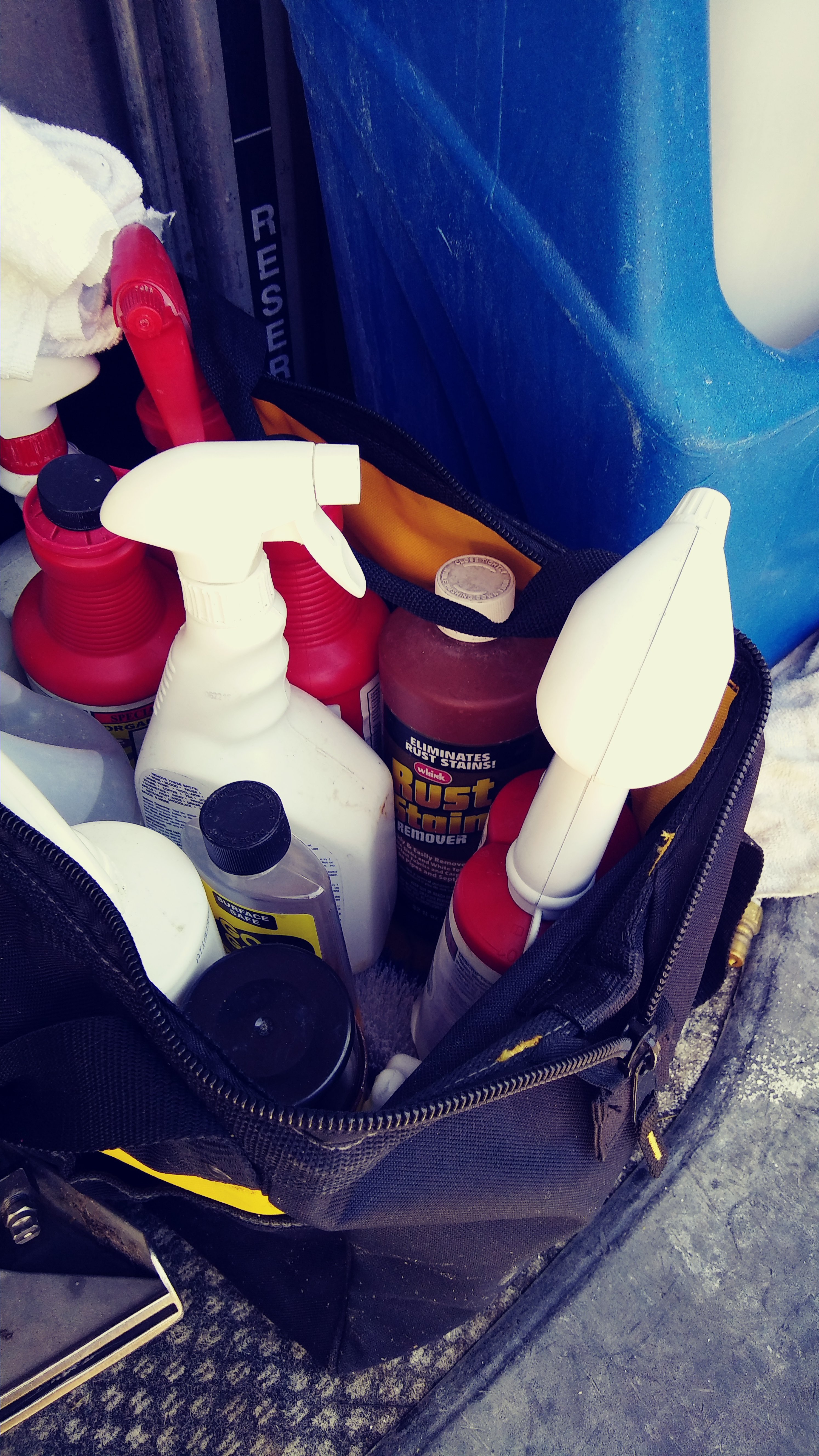

I tried the ultrachem clean a couple of times and it seems to work fine on some and not so good on others. Not sure why. I'll keep trying as I go along. I keep a 16 ounce bottle in my spotting kit. Works on many other spots and stains as well. I use t-rust on more serious rust stains.
