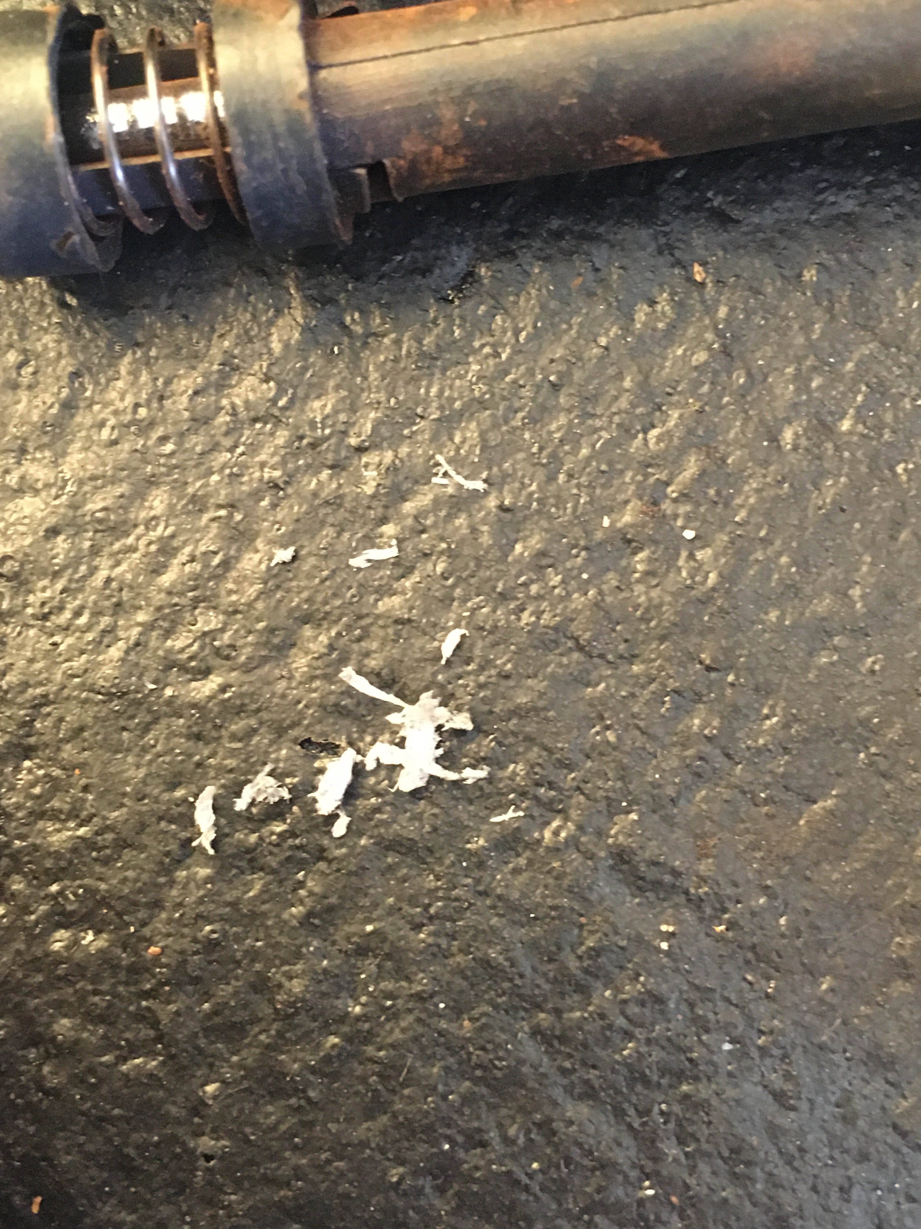

Guess what this gunk came out of?
I pulled this out of one of the fuel injectors. "Just run the damn thing!!!" morons.
did a good test on it today and it was barely glowing underneath on the bottom of the header, which I think is probably normal.
And no codes pulled up either
14,623
The injectors are one of the first things we asked about!!!! Idiot,
EH! you know I was concerned about the fuel pressure being low before I found out the accurate way to read the gauge
