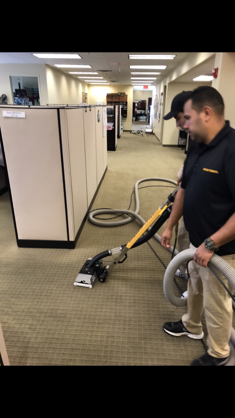

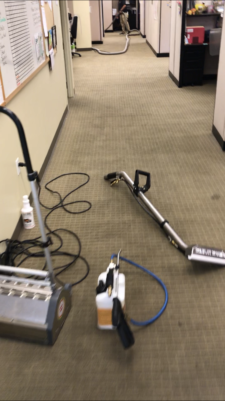

$2000 commercial job done this past Saturday (16,000 sq.ft at $0.12) that’s was a 3 year old estimate that we honored because we do a lot of work them. Normally $0.15.
2 (2 man crews) pre-sprayed, CRB-ed, Tom Conway’s Dev. Wand around cubicles, Erik’s 15” zipper open areas and halls. Done in 5 hours. I’m ok with $200 an hour. The customer was THRILLED. We clean portions of this place yearly and have never had a better result as easily as this past weekend.future work for them will be priced at $0.15 and they were contemplating protecting since it came out so well.

To be honest I would be worried about moisture recovery using the super spinner. This job was 300 ft runs. I had 2 trucks not running this day so I ran 4 trucks for 2 wands to achieve twice the CFM per wand. (Ran a 50’ x 2” hose from each truck to a 2” splitter/“y connection”. Then a 2” vac hose the remaining 250’ to the wand.) Did this on both wands.

You can only pull 275 CFM through a 2" hose... You should have plenty of vacuum with a 56 blower.
Have you tried 4 to the door (two 2" hoses from the truck to the tee 100') or 2.5" hose 100 ft?
I read somewhere that 450cfm could be pulled through 2" hose, only read it no proof so not arguing. Just after clarification
13,372
Just guessing since I missed the physics class but I would imagine more lift would get more airflow. Most run 15 or under it sounds like.
