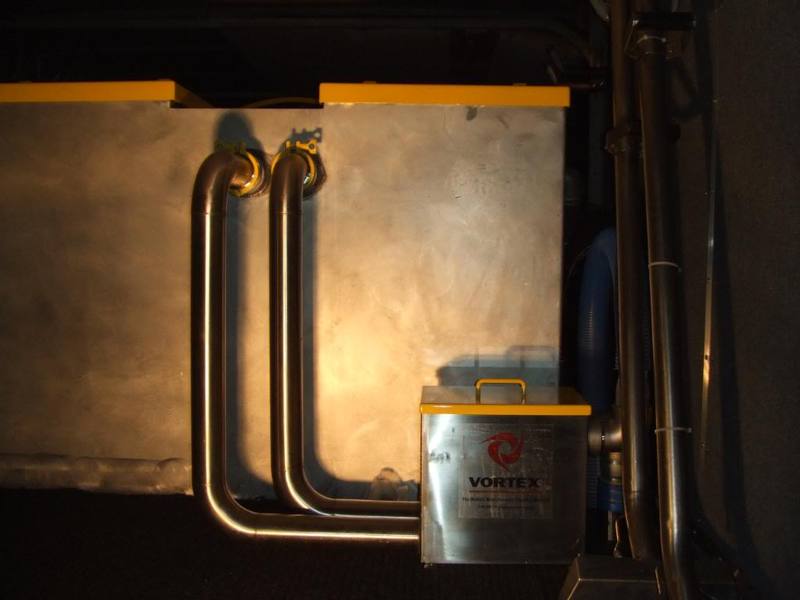

We use a large filter basket to "catch" the larger debris to protect blower. The filter box assembly has two 3" ss plumbing from waste tank to filter box and two 2.5" pipe plumbed externally for hose hook up.
The problem with filters are the users, and that they don't get cleaned out after every job. Even with a larger blower, if the filter is even half full of crap, I will notice a performance drop.
