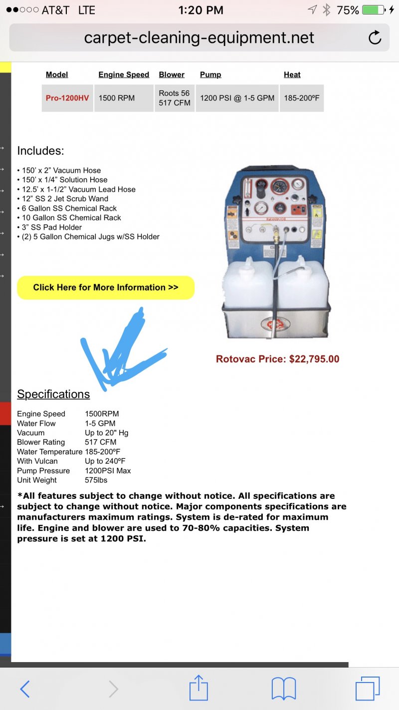

10 inches of lift
That's weird. I've heard other cleanco guys say the same, the 56 didn't feel any better than the 47. But I know WM ran the 1200 HV with the 56 set at 18-20 hg. I have to believe that butler stayed with the 47 spinning fast and at 15hg for a reason. Maybe the 47 is the limit for a blend of CFM,lift and belt longevity.
Cleaning Professional
13,372
So what RPM should I run my 56 at for best performance? I'm at about 1500 now.
J
JS41035

Max rpm for a 56 is 2850
I was wondering at what RPM do you get the max airflow.
