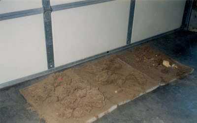

Bobby but doesn't it still use the 2-inch hose to deliver the debris to your TM collector?
The 2-inch size I would think would clog and fill with debris. ????
This debris came out of an HVAC system we cleaned. Now it's certainly not the norm but we find all kinds of stuff in our collector that I just can't see passing through a 2-inch hose.

What the heck is that and where didi it come from? Residential or commercial?
It was just 30-years of lint and debris. It had built up to the point it was restricting allow airflow to a couple of bed rooms.
It's amazing the junk we find in their ducts, bats, frogs, birds nest, snake skin, dead snake, dead rabbit, beer and pop cans and of course construction debris. New homes sometimes have a terrible mess in the boots and system when the contractor sweep the stuff right into the vents. :shock:
