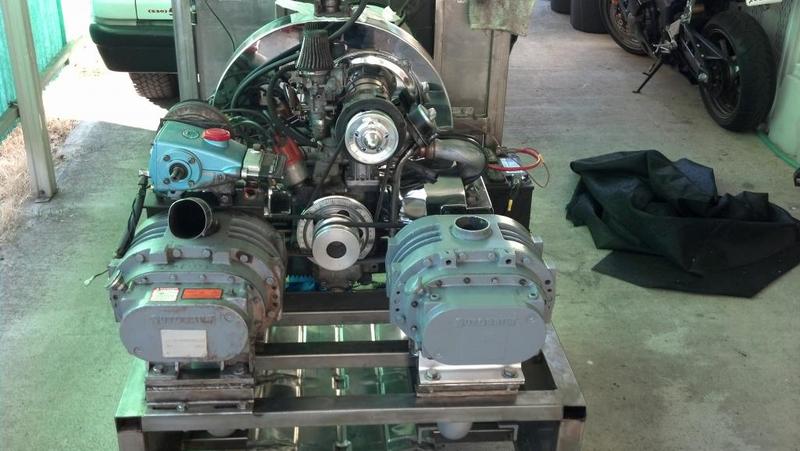

Nice looking setup. It sounds like you're running the blower at 3000, what size is it?
TConway
Jan 18, 2013
1,193
Redding
Thomas Conway
Looks like 2 45 blowers? was looing for 820 CFM on second video but didnt see that.
Yes twin 45's I don't have tach yet so I don't want to go crazy with rpms, I think max cfms out of this would be in the 700's some where today I will get tach. Wolfgang VW says 3000-3600 rpms on motor is fine but it will use some fuel if I want to run it that hard, He hopes we will have enough torque in the motor to keep it on the idle jet only if we can 1- 1.5 gallons of gas per hour.
Even at dead idle I'm still just under 500 cfm should be fine for single wand.

You need more than ONE belt to run a #4 Blower .
Larry
It is in lets see if it runs mode that is a 4 belt pully coming off the back of my motor, I am really happy about it cause it is not slipping yet and I only have the one belt on each blower, so when I put the other one should give plenty off bite.

When the vac hose opening was being covered it sounded like the motor was starting to bog down a bit. Was that because it was on idle? Not familiar with the VW engine your using and barely got a look at it from the video. How many hp? Rather than twin 45 blowers would it be big enough to spin a single bigger blower like a 56/59 wthout bogging under full load? Kind of like the idea of twin 45 blowers though, it has it's advantages.
Larry
Larry-
I have been using a single B-58 belt, and over-driving (8" pulley on motor - 7" pulley on the blower) a #45 blower, for over 15 years. The belt also has a Motion Industries tensioner in the belt loop.
A belt will last for over 2 years, cleaning daily.

Just what I was thinking. You'll need a governer to keep up your rpm's, unless you don't mind the bogging down. And what kind of VDub engine is it? Air cooled, water cooled? Old "bug" engine? My B-I-Law wanted to do a 1200cc Harley engine on a TM. I wanted to try out a Honda Gold Wing or Valkerie engine, 6 cylinder opposed, to power a TM.

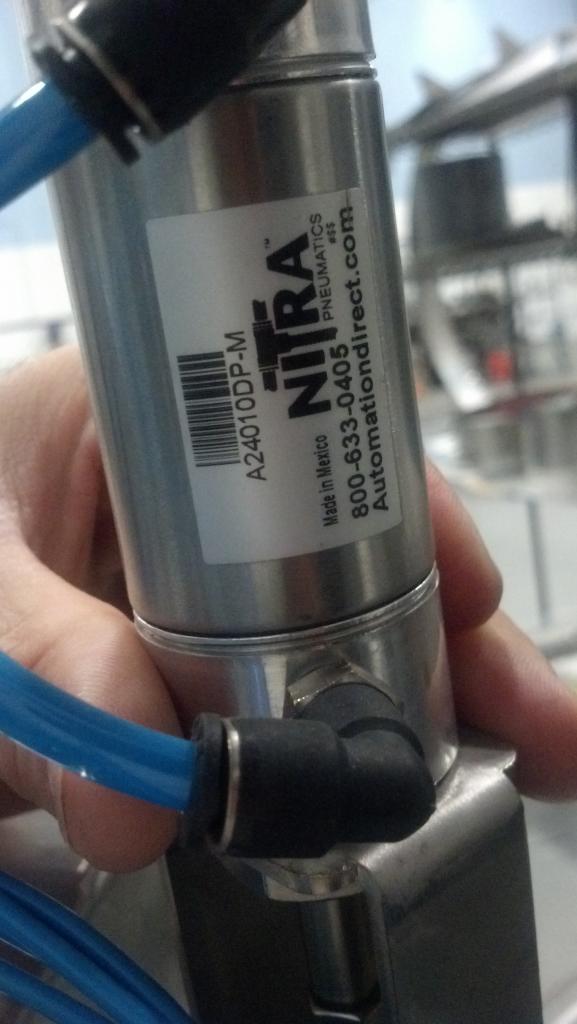

If it lugs and it will we have a really awesome air activated ram it is used in the wine industry here is a pic of it. We are going to plumb it into the intake manifold of the blower, as the vac increases it will pull the arm or ram, I will be letting Tim my fabricator be in charge of this. It will be complex for me as he has tig welder and all in stainless steel. I think these would work on older machines that have bad goveners

Yes it is a 1641cc air cooled Vw.
We will make a cover for the electric fan. I am going to put shrouds on it this way it will pull only fresh air into the fan on the vw motor.

This is basically what the older pod controlled hydramaster machines do. the second pod is hooked up to the blower to kick up the rpms a little bit when the load increases.

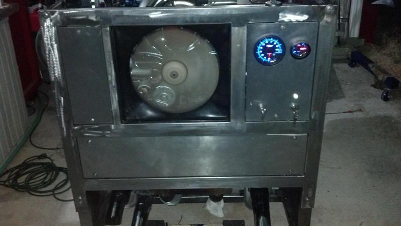

I had a little time to work on it some more on Sunday, throttle needs a little more adjustment, but it's coming together purdy good. I was worried I wasn't going to get enough heat to my HX but you can see the collector box is turning blue from the heat from the vw exhaust, my hx will only be about 6" from it. You can see where it is going to get hooked up at from the wet rag hanging out of the port.

Yes you are correct,that is my collector box, one exhaust port is going to go to a Hx box that I am going to make it will sit in the open area between the mufflers.
I had to come up with a different throttle pull than the one I pictured I found out was either full on or full off and I wanted one to pull as I needed it as vac load increases. As far as how I am going to control HX this is what I am wanting to use if I can make it work it will be remote controlled from the house. I really want this to work because it would be so cool to be cleaning and if I want MORE or LESS heat or NO heat it will be able to be done without going all the way back out to the van to adjust. You can get a remote key chain like a car alarm.

Why does the cooling fan look to have a cover, or is it spinning? Do you have a name for it yet? The Dual Velocity Water (VW) Devastator.
Looks like a a great project, and a cool machine. Are you using a round waste tank, or two?
