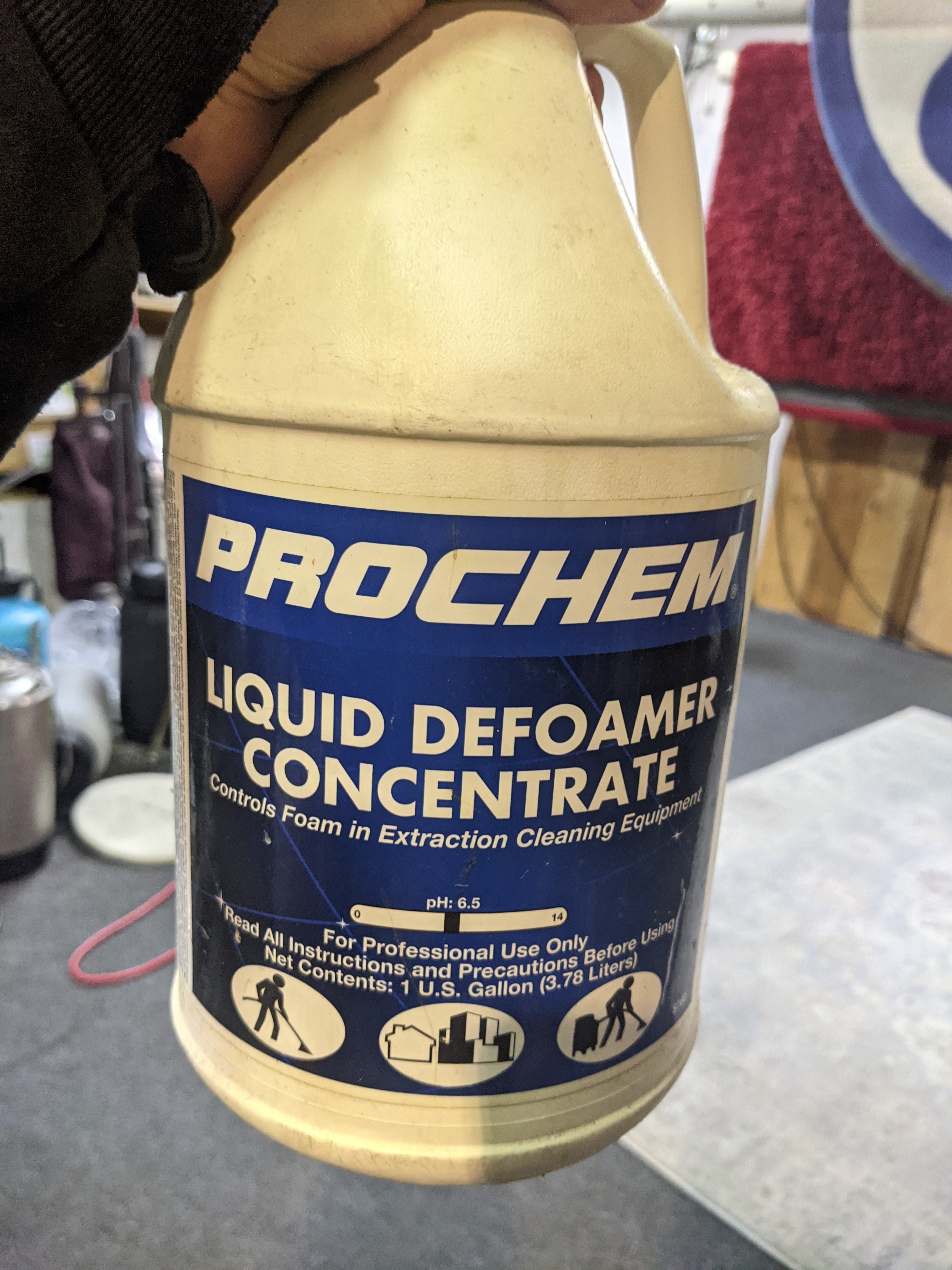

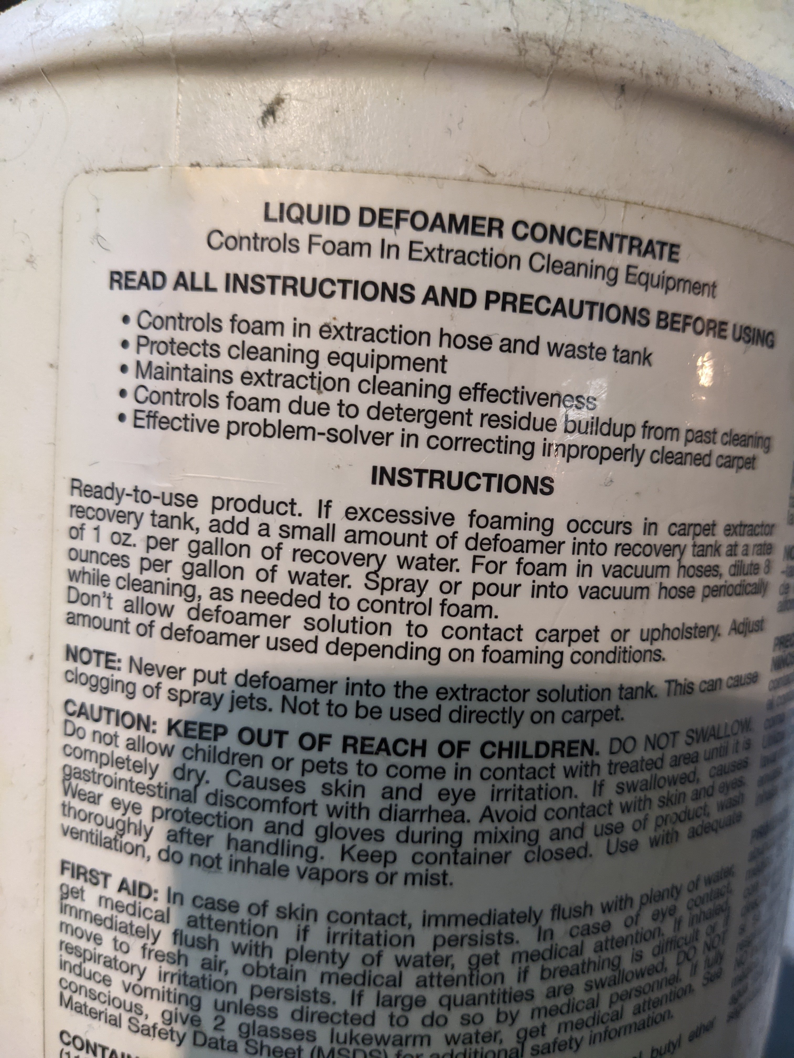

This products works well. Pay attention to the instructions.
