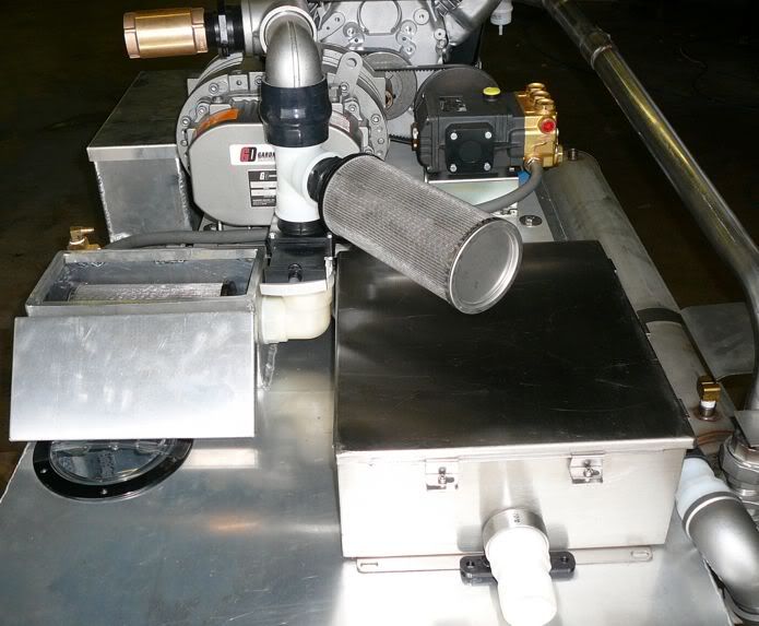

Here is a photo of the new QuickDry TM system for speed-drying carpets.
This photo is taken from the back of our Dynachem 534 TM ...,
First it shows two stainless filters, one in the recovery box at left,
and one for the drying system on the right.
2 Valves to control the air flow.
The box on the right lowers the temp of the airstream from the #4MR blower.
Another configuration is used on some other PTO TM's.
We have some special new Hi-Temp Vac hose that is included in the system.
The specially-modified RX360i is the final part of the system.
Drying time is 10 to 15 minutes with the #4MR Blower.

Guess you did not see the 2 different air filters drawing from 2 locations.

From what I understand it has some kind of device that lowers the RH in the air used from the blower. You have to carry separate 2" hose to use with it so you don't use dirty hoses. The blower heats the exhaust up to about 200 F so have hot dry air to use when drying the carpets. You hook this system up to a RX-20 or RV360i either of them outfitted with Kens glides. Ken is convinced this is going to change the carpet cleaning industry forever and make him rich. Last time I talked to him (back in my naive TMF days) he was convinced he was going to be able to sell it to Chem Dry and get rich off the royalties.
Major problems.....
You have to carry double the amount of hoses you normally carry. If you used to carry 200 feet of hose, now you would need to carry 400 feet.
If any over flow from your waste tank spills into your blower (we all know it happens from time to time) you have some serious problems like spraying nasty water all over the carpet.
The RX-20 or 360I will need to be majorly cleaned before used to dry with or never used to clean carpet because it also would have nasty water and trash inside of the tubing.

There is NO air from the recovery tank going thru the blower.
The Blower is used, but since it is subjected to continuous 235° F for long periods of time,
microorganisms will be essentially eliminated.
Some heat will be introduced, but the AC system should be able to handle it.
The system cools the air before introduction to the house.
I would have no problem with typical cleaning including urine done before this process.

the ac SHOULD be able to????
oie the house is usually 10 degrees hotter anyway from the firebreather.....now more hotair?
Larry Cobb said:
Mikey;
and how, pray tell, do you accomplish that??

This idea was discussed years ago, and it obviously does work. But, here's another real potential problem: Even though the blower is not drawing off the waste tank, the moisture blown off the carpet in the house WILL drive the Rh relative humidity up to 100%, in just minutes. Also, it WILL pressurize the home to many psi, that will drive the moisture into places that it does not belong, unless we open the doors/windows.
Restorers know what 2ndary damage occurs under those conditions. So if you do it, remember to open the home up. And add to that the fact that living microbes from the carpet WILL be displaced onto a cellulose food source. I'm not so sure I want to explain all of that to my customer. Not in the USA, the land of the lawsuit.

Larry, I'm having a hard time seeing the second control valve. Are you saying that the valves are set to draw air from the recovery tank for normal extraction, then set to shut off air through the tank and draw air through the second filter (clean dry air from inside of van) for the drying step? As in the drying step is separate from extraction? The main problem I see if this is the case would be drawing CO fumes out of the van from the propane heater or TM engine. Correct me if I'm wrong, and perhaps more pics from different angles would help.

The second exposed filter has a shut-off valve inline.
The exhaust from the engine is routed out the front of the TM with a flexible hi-temp exhaust hose.
It will be outside the truck, at least 10 feet away from the fresh air intake.
It will require some minimal housekeeping inside the truck :roll:
Larry
D
dgardner
So you would set the valves for extraction, do your normal cleaning, then reset the valves for drying and go back over the area with the 360 to dry?
