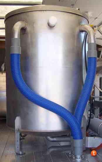

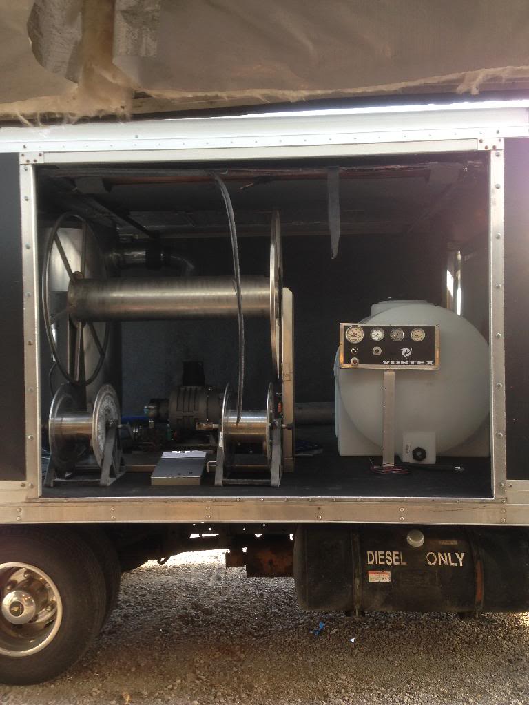

I felt that way at first as well Gene. They are actually protruding into the tank 1 inch, so that it could be welded inside and out. It also is 2x more material than A/T's new tank legs:
As a test I filled it 100% with water, and even climbed on to it to stress test it, and they didn't budge
Tanks looks great!
What was your cleanup and polish process as I may due the same.
Step by step please!
AshleyMckendree
Sep 1, 2007
1,572
Ashley Mckendree
36 grit flap disk to work down the welds and and really rough areas, then 60, 80, then 120grit flap disks to give it a nice matte flush finish, then used a cheap orbital sander with 3m p400 hook it sheets, they are expensive, but last forever under the sander. I use quite a bit of down pressure to get the finish I want. A few drops of dish soap in clean water and use a sponge to wet the metal. Finish by wiping down with microfiber and spraying it with strong peroxide, it's the best stainless cleaner I've ever used.
That ain't now where near having to CRAM the brakes on buddy. You sure about them legz?
How much water does it hold, calculate the weight and run the numbers.
That could end up a Torpedo in a Collision if ya ain't careful! Goodbye what ever is in front of it.

The above picture is aerotechs legs, mine are 2x bigger.
dgardner
Apr 7, 2008
5,109
Dan Gardner
A head-on collision can generate upwards of 40 G's - probably nothing you could reasonably build would hold a full tank back under those conditions anyway. Even if the legs hold the bolts would pull thru the floor (unless you have a mondo backing plate). Just don't hit anyone please....

Very true, we never drive with full tanks, and the massive pumpout will help ensure that :)

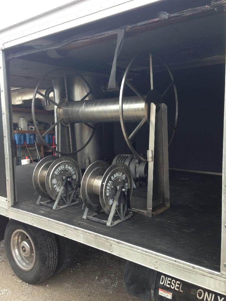

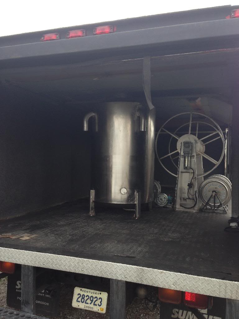

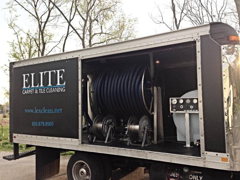

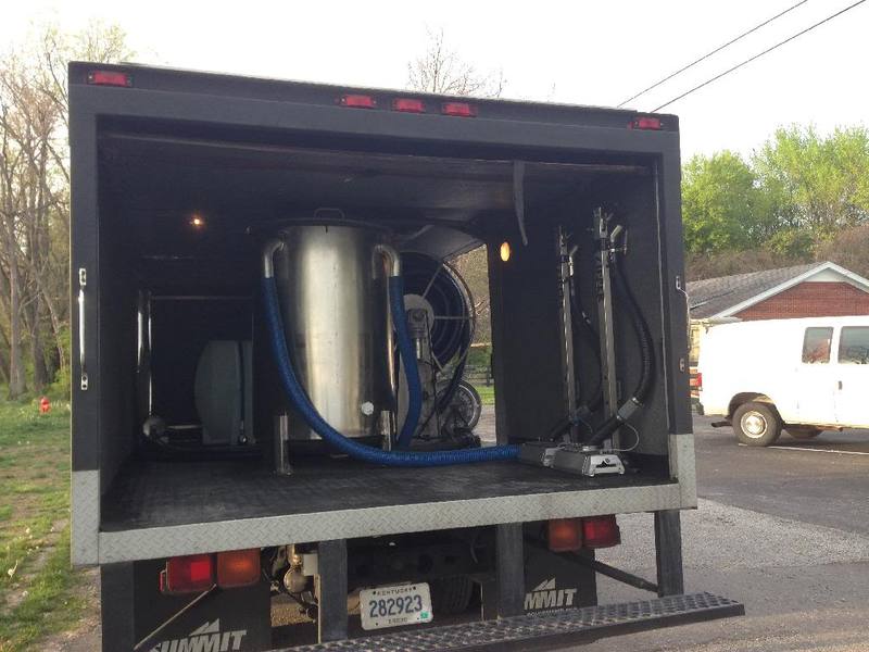

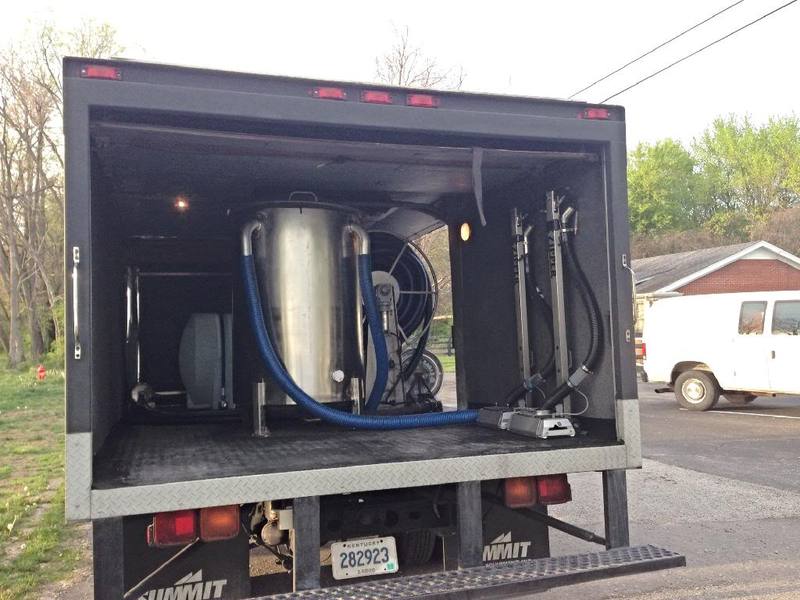

Its all winding down now, 165gal fresh tank installed, I made a TEMPORARY control panel by cutting out the old one and making an aluminum box for it, the water jetter making my new control panel is back-logged; So this will get me by.
Still have a laundry list of things to do, plumbing, blower silencer, and 100 unseen things that will pop up with a project of this scale.

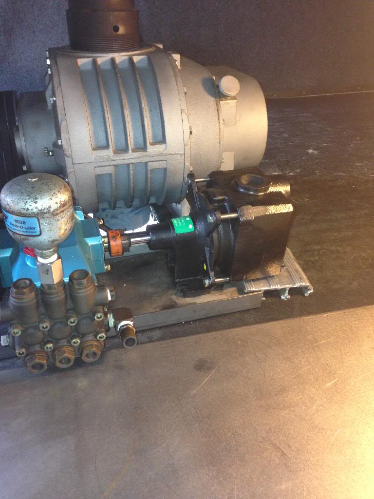

Yes, the pump has a shaft on the other side. It ran the Zentherm pump, now it will run the pumpout
Reactions: dgardner
Yes cat pump 5cp series has the option of utilizing both sides of the pump.

Man that's sweet!:icon_cool: What are you going to do for shelving? You still burning biodiesel in that other truck?
I will be putting a stainless shelf on top of the water tank, and a few rows of shelves on the wall behind it... Kind of like a chemical mix station.
And If I can find a local place that sells unistrut, I want to do some wall organizing like Mike Draper
