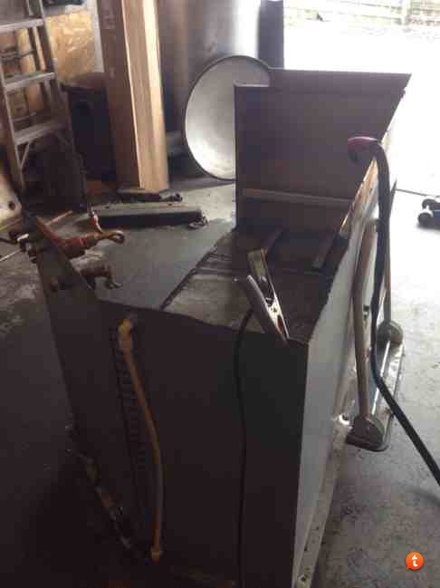

Nate, I did rebuild the the blower pictured, it came out of an 05 A/T with Low hours.
It didn't need a rebuild, but was filthy. So I took it apart, had everything but the gears put in a parts tumbler and put all new bearings, and reset the tolerances.
I ordered a new 6mp from Gardner Denver Louisville, but they said it could take 2 months as they are back ordered...
So I may just stick this in and swap it out for the new one whenever it arrives... or keep the new as backup.

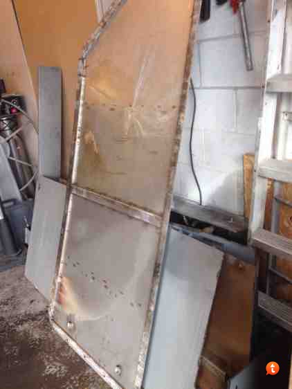

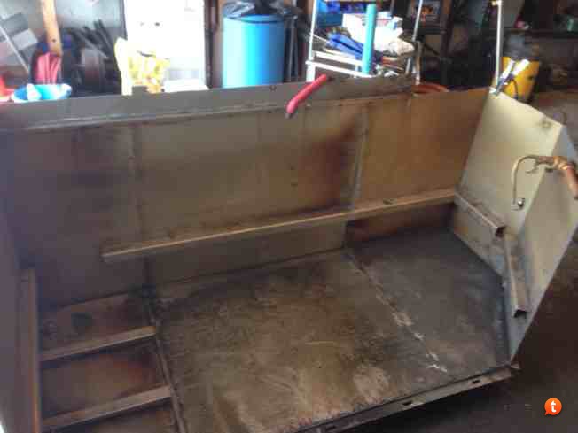

My Elephant bark flooring arrived today, I saved $1300 over going with line-x. Still plan on acid-priming the floor to seal it good.
And eastwood sent me a replacement plasma cutter that should arrive tomorrow, so I can start tearing at this thing again!

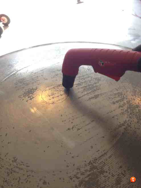

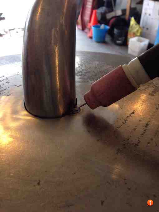

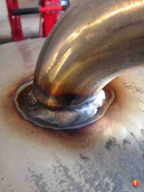

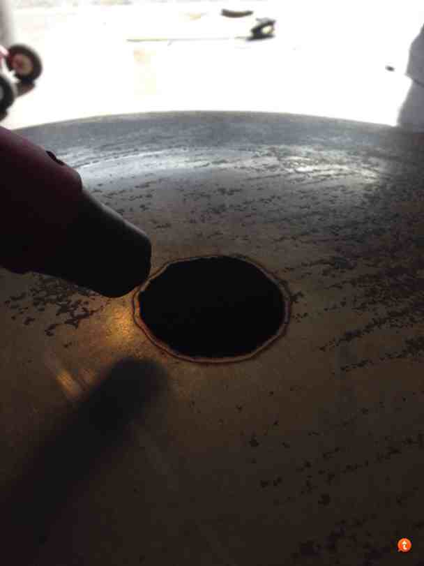

Got the replacement plasma cutter, welded the drain in

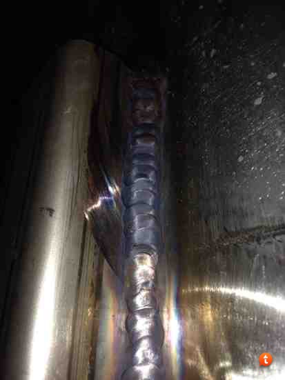

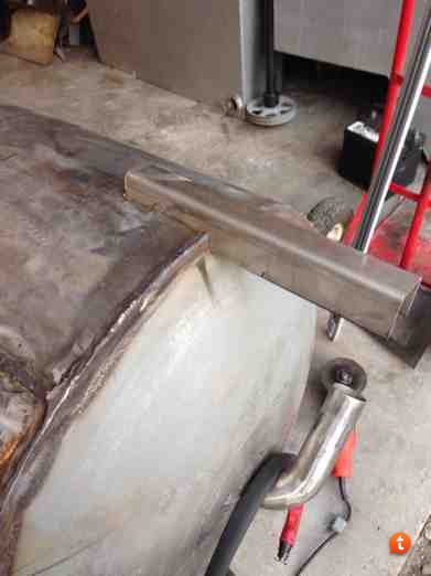

Welding the legs onto the waste tank.
My tig welds are getting slightly better looking.
AshleyMckendree
Sep 1, 2007
1,572
Ashley Mckendree

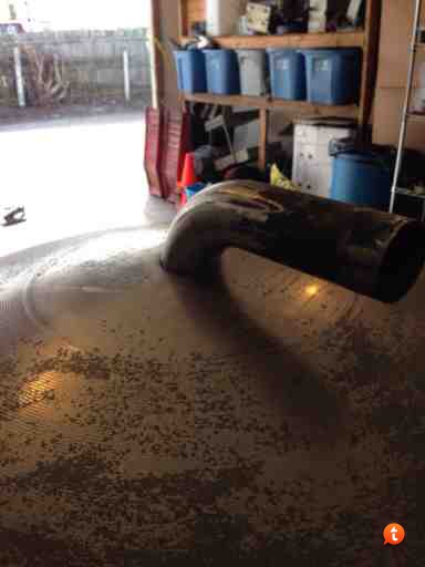

As long as I tack weld everything first, it evenly preheats that eay
Reactions: JS41035
J
JS41035
Stainless can be tricky. But I like to go a little hotter and faster on the thick stuff. It's funny how fast you lose it. I was making a stainless mounting bracket for the waterbox on a 405. Hadn't run the tig in a few years. Got counterproductive real fast. :)
