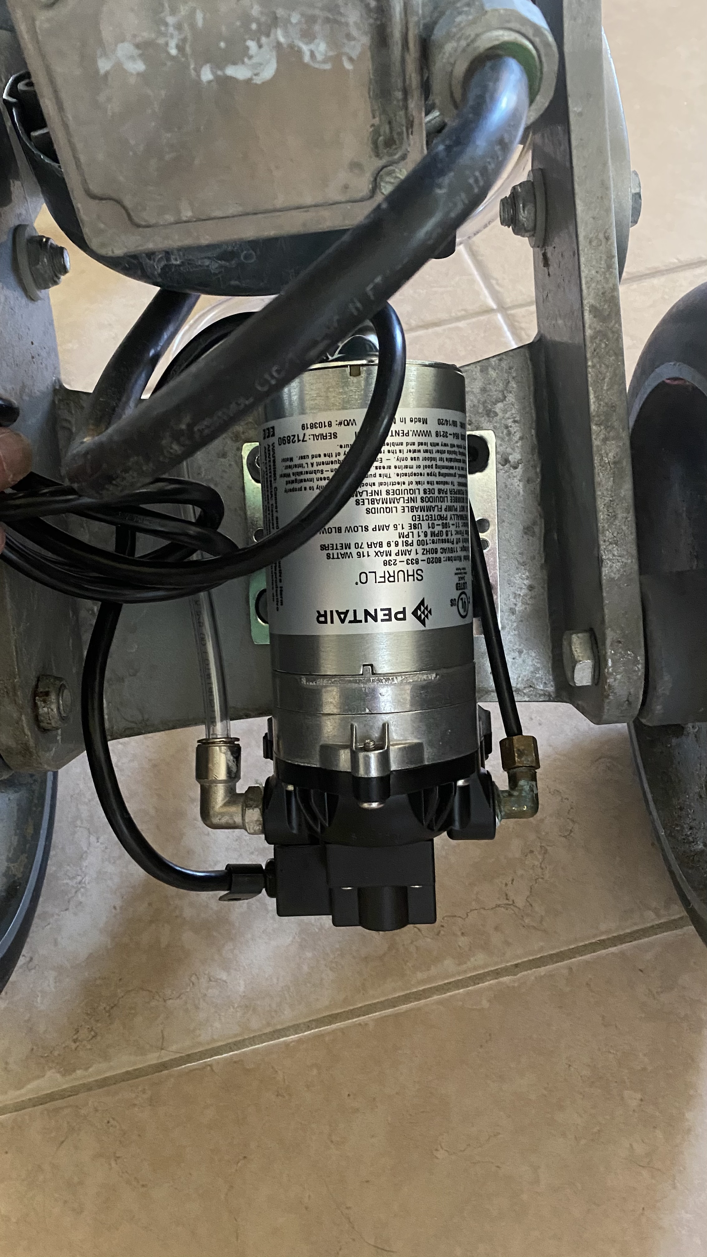

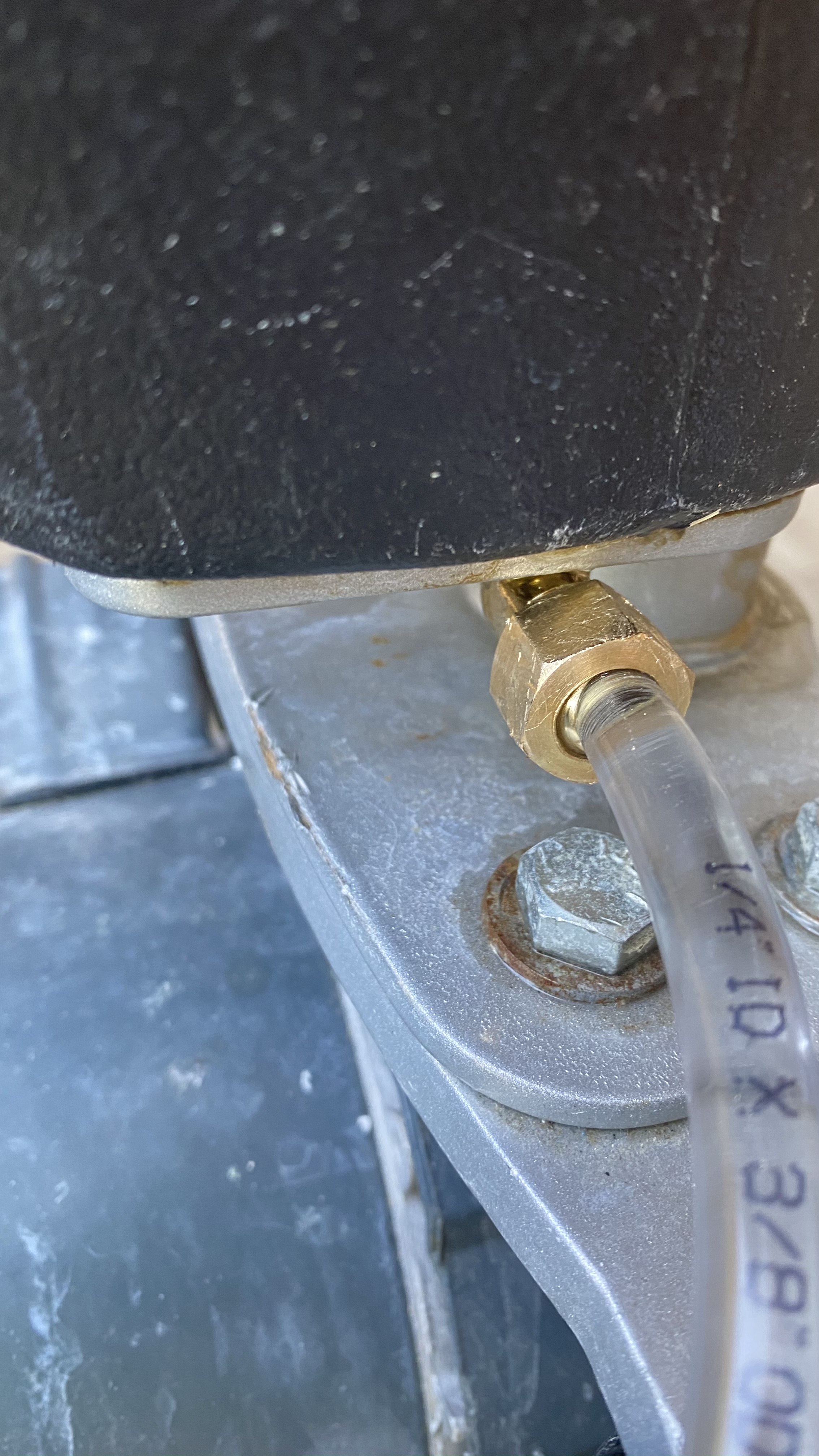

Well, My new pump arrived in the mail. I installed it and of course it didn't fit. I had to mount it vertical because it's longer than the original pump. I then had to get new fittings and hose to make it work. I hate hate hate those crush fittings and Ace Hardware didn't have any of the slip fittings. I can NEVER get those stupid crush fittings right. They always move and turn out off center. Then when I post pictures of my handy work, you guys get boners claiming water leaks that aren't there. Well after several times and going through three crush fittings, I said screw it and just man hammered it down. No leaks. If it does leak I'll get on the interweb and get a 3/8 MIP 90° elbow swivel with a 3/8 hose QD.

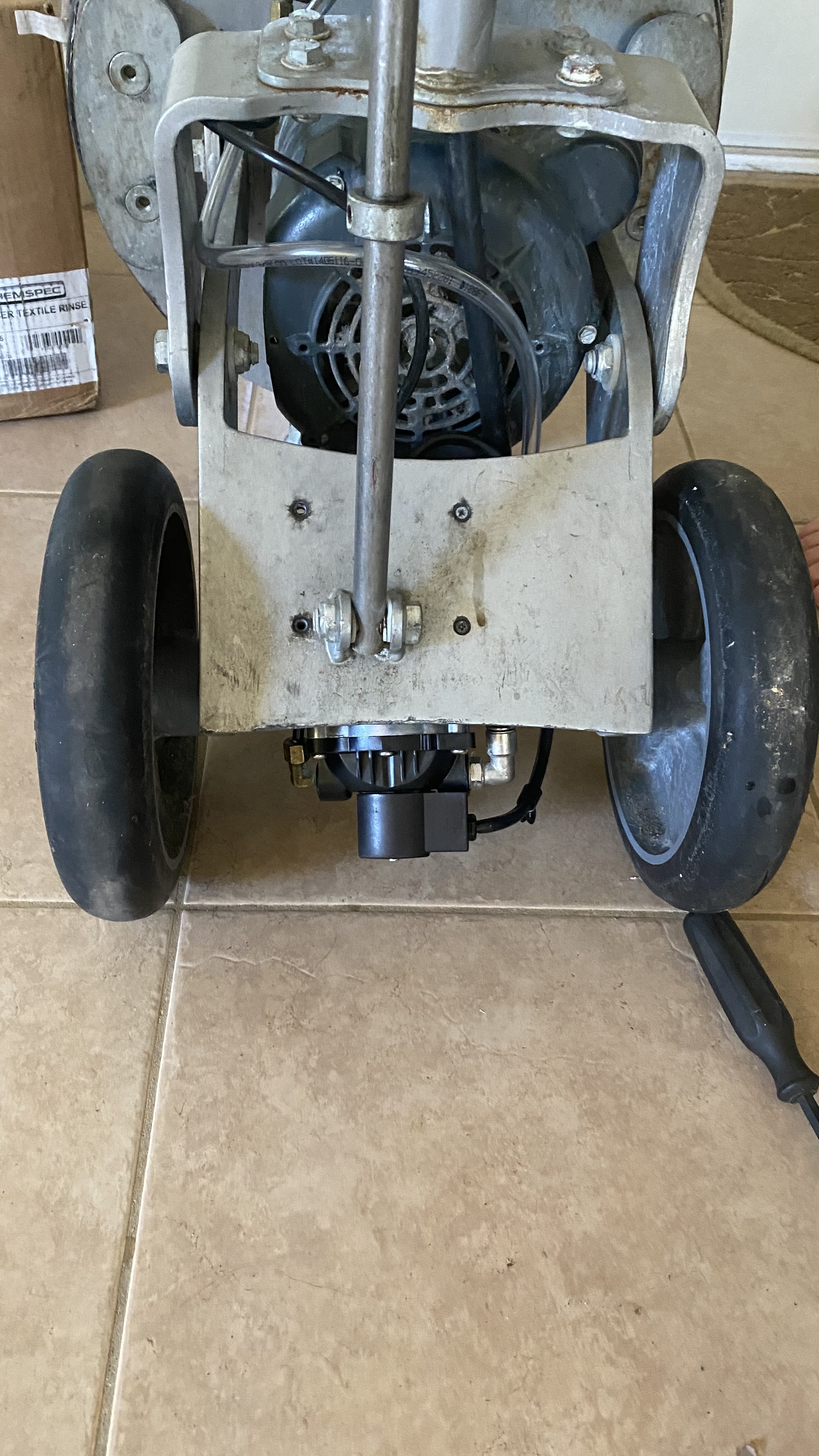

The new motor hangs down a bit, I need to be careful I don’t knock it into anything.
The new pump runs like a Damon to a Baconator. Just need to replace a couple more bolts and nuts and she's done.

I think you should bend or have a piece of metal bent to an "L", to bolt at the motor mount holes in order to protect the head.

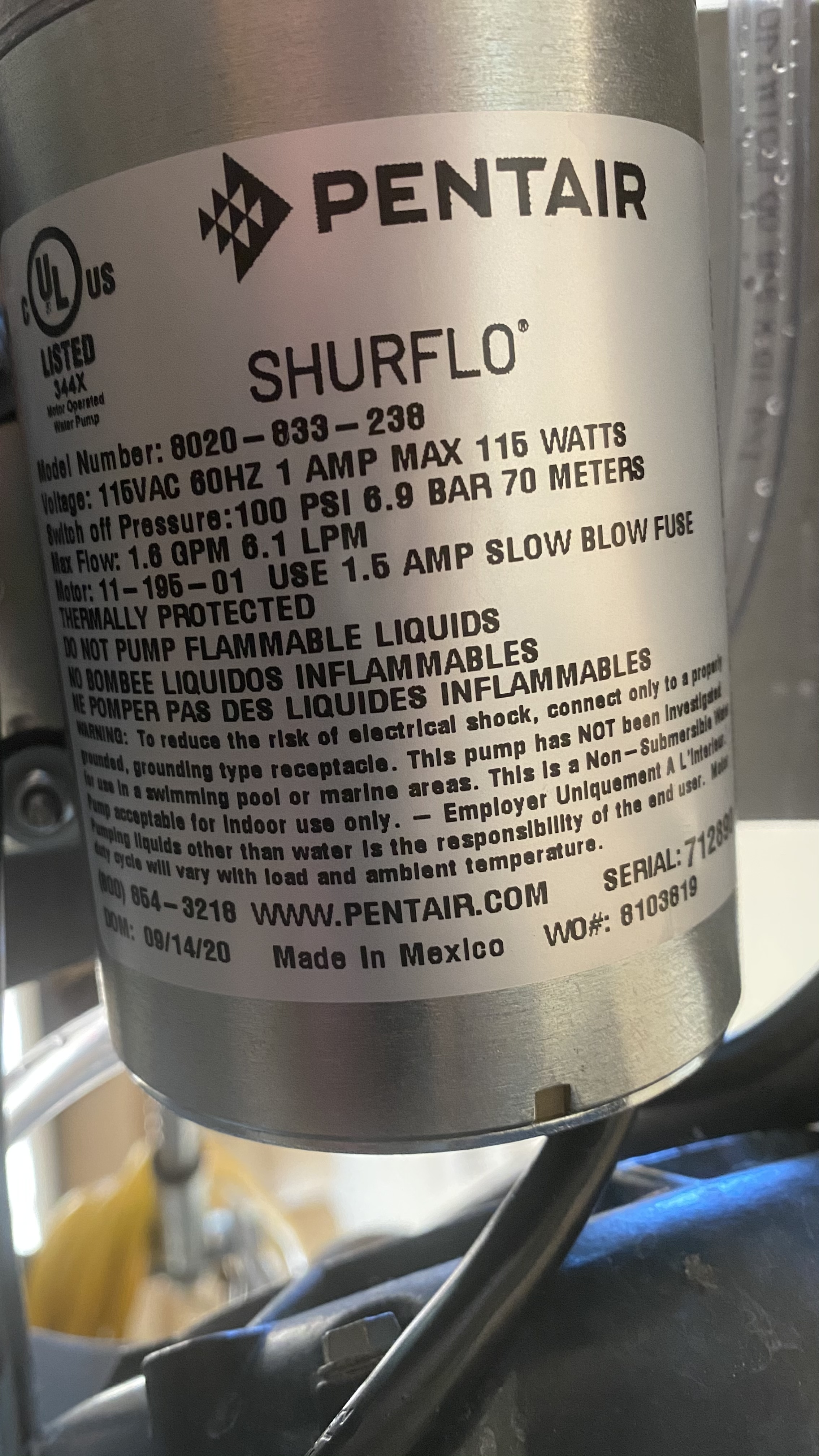

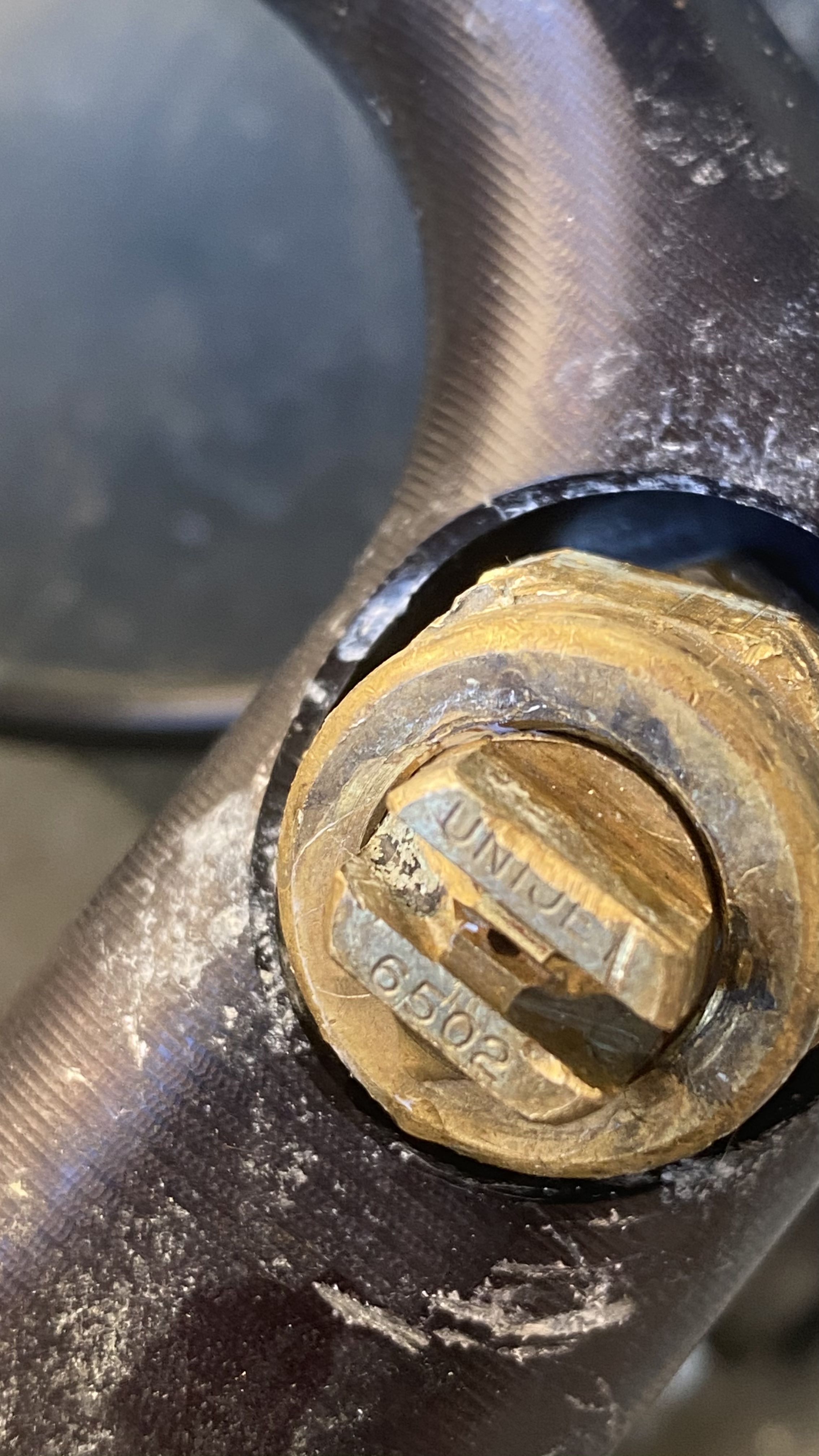

Here are the specs of the new pump and the jets.
The jets are two 6502 Unijet. The pump is a 115 volt 100 psi. The original was a 90 psi.

Should probably just replace the jet, with the way brass wears so easily.
