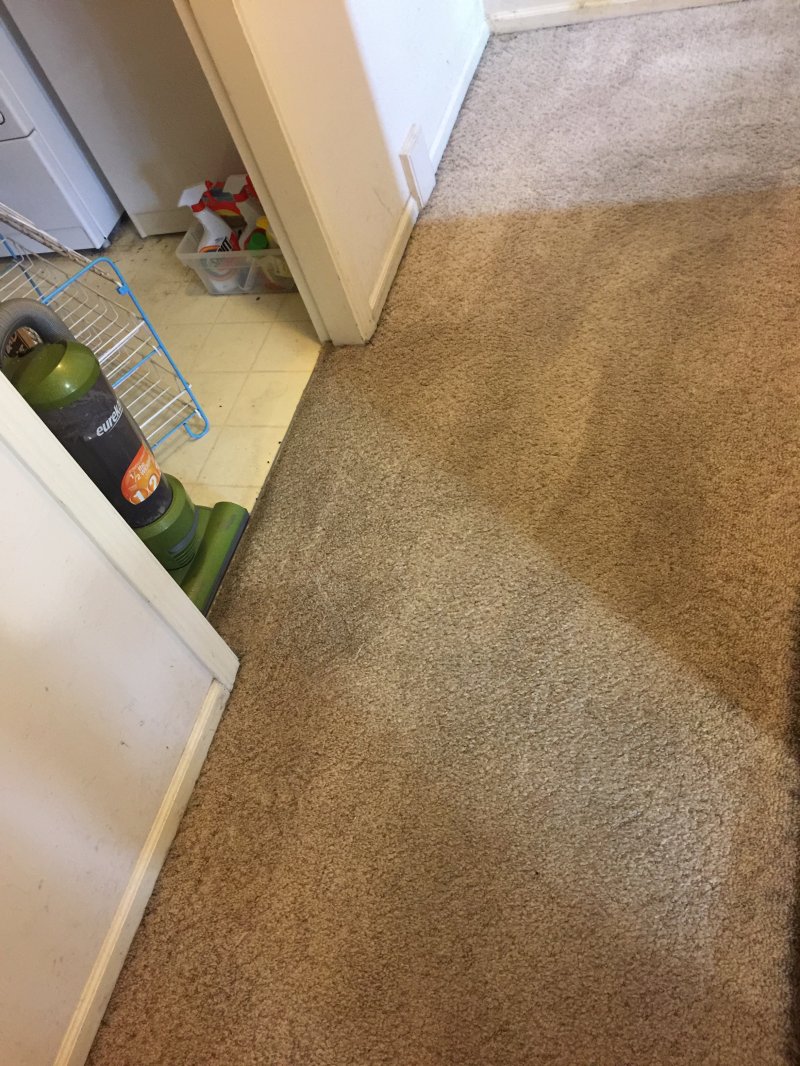

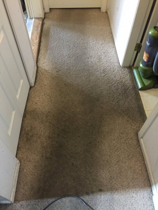

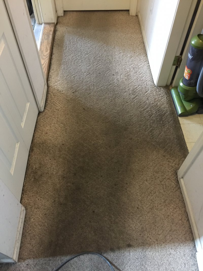

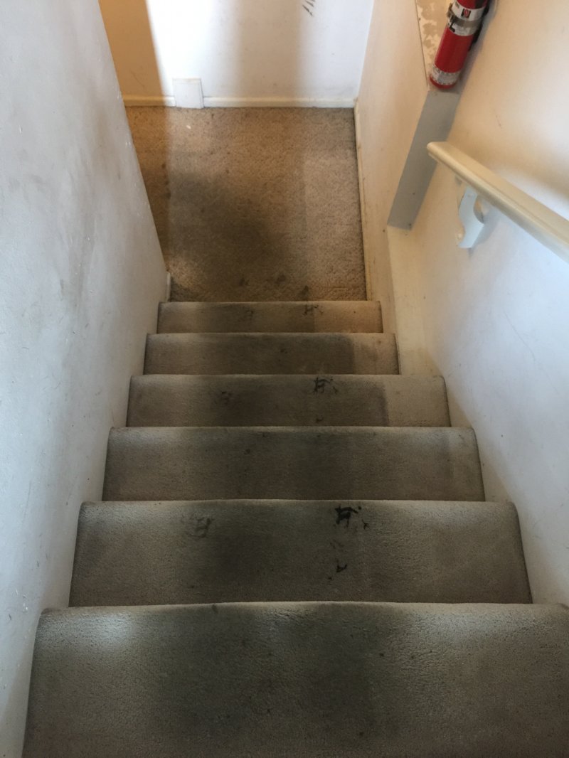

Damn... its just for those rat nasties that in occasionally come across...but a RE should be on the truck...fml
E
EDS
Maybe some encap on bonnet could have done better after hwe....same with the stairs...
