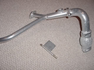

If this part from the vendor I looked at is OEM on your TM . . .
then you need a better-designed new exhaust system.
No OEM should be using SS flex for new exhaust work in a van.
Larry
You're right, Larry. They don't last long.
Truckmount Haedquarters has PowerClean parts. 805-604-4808.

I had trouble with manifold and other exhaust part between the engine and diverter so this is what I did. Bought a new SS manifold and then I made the rest with SS exhaust parts from Summit Racing. Had it ceramic coated and haven't touched now in probably 3 years.

Thanks Jim, I didn't get it right on the first try but eventually worked it out. The coating company also put what they call "Race Coating" on the inside. It has a higher heat rating. I hate that flexible SS crap. It always seems to leak at the slip joint and then get brittle and cracks from excessive heat.
