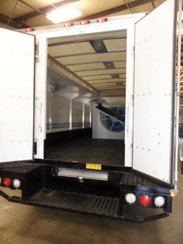

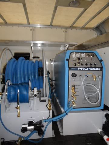

That's an excellent use of floor space with the fresh tank under the hose reel and the waste tank under the machine. The fresh and waste tank on my WM {and current Butlers) take up 2/3 of the floor space with the reel and machine sharing the rest with any tools I need, limiting severely what I can bring to a job. This looks like it was designed by people who really know what we need today, not the 1980's design so prevalent on most units.
FB7777
The waste tank under the machine works in a box truck, but there isn't enough room in a cargo van to have it underneath and behind the machine
I think the 4.8 CDS with waterpond has the best layout for a cargo van ... Just wish the waste tank was bigger

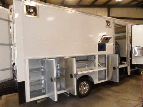

That is a sweet set up..I really like the box with the storage on the outside...everything at your finger tips with out having to jump in and out of the back...
would like to see what it will look like completed....

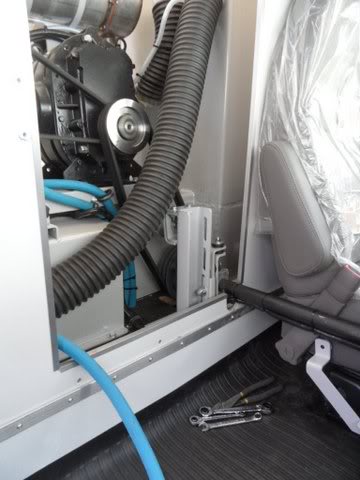

Is the PTO shaft going to have a cover...looks like it is riding on the edge of the seat...
What is that white thing hooked to the side of the driver seat...

Looks to me like the waste tank is behind the seat, not under the unit. Maybe it's just the silencer under the unit?

In the box version the Butler takes up about half the floor space, from the door opening back is usable floor space.
We will sometimes have 5-6 Cimex's and an Orbot back there for large commercial jobs.

looks like its the seat recliner lever...with the plastic off

looks good but I would be concerned with the weight of the machine flexing the water tank. Whits Magic did that on the Pro 1600 which was a huge disaster with tank flex failure. I like the look and concept.

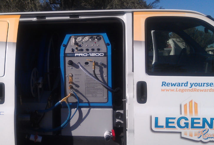

The Pro 1200 on the waste tank will fit in a standard van, in fact that is what it was originally designed for. And the weight on the tank is not an issue since the console does not have an engine. It's really a pretty slick setup and gives maximum space in the van for a Water Pond, reel or whatever you might want back there.

Jim it looks like it is an extended lever for the recline feature on the seat, as the shaft is blocking it.
I need to make something similar for my van.

The sub-mount tank is 85 gallons and the standard tank is 120 gallons (100 at shutoff)
An APO is still a good idea.
One of the ideas behind the sub-mount, other than saving space, is that much of it comes pre-assembled which reduces the install time and the cost to the owner.
