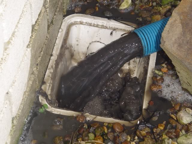

Bit beside the point now that you guys have gone all millitant on each other - but here's a pic of the water that came from my gym. It includes blood, sweat and tears lol :lol: Seriously though, some dipstick had cut himself on the kick boxing bag and kept going, blood spattered everywhere in one room. I'm fairly sure that HWE was the ONLY option in this place.
Powerburst, 175 and and hot as could get her. Strange thing is it didn't really look that dirty.
