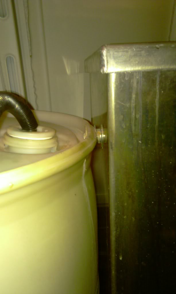

It has support brackets all around it and its bolted to the waste tank. My 55 gallon holds 55 I can do 2 or 3 apartments with it

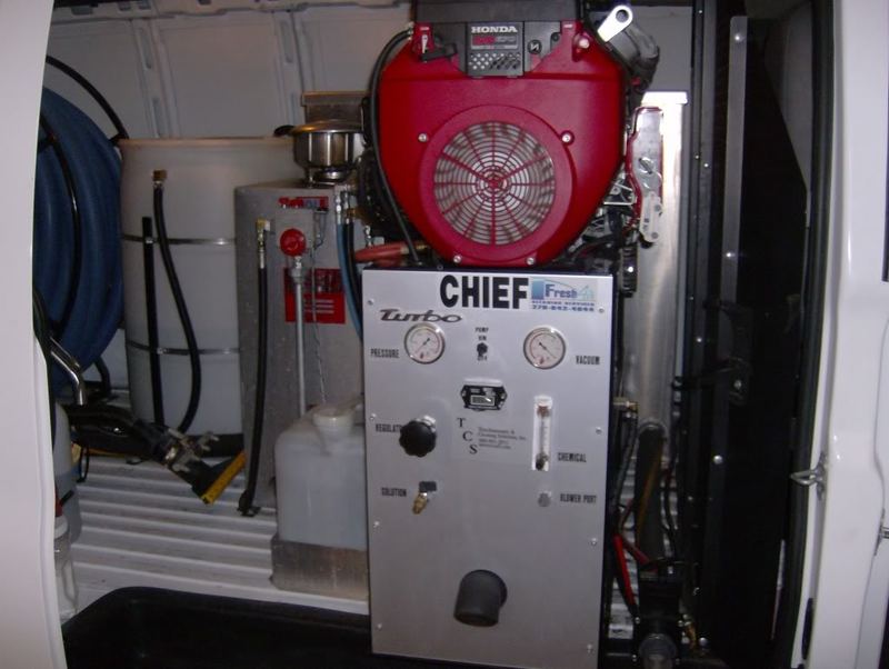

That's a proper picture of a true TCS install. Plastic fresh water tanks may not be for everybody, but that's why we have so many garage based builders. So everybody can find somebody to love.

I see no support brackets in Les's picture AND I have never seen a TCS install with the water tank mounted between the side wall and the waste tank. If I had "tried" to buy a Judson, I would own one today. If shopping is "trying", then I would also own a Butler, a Cleanco and a number of other rigs.

Both of my pics are tcs.. one was installed by actually tcs, the other from my disty chris pond..... I have no separate battery either it runs off my van battery. I can use lights turn on hazards while working and not worry about killing my battery cause the tcs keeps it charged. Why have maintenace on two batteries????????? Now I am about to hear negatives about that I am sure...... no the van battery never goes dead. Lol

That barrel does look much better, it's clean and has an attempt at safety. Doubt it would hold up in an accident but then I don't know many water tanks that would unless bolted through the floor.
However it's still a barrel with a hole in it, 50 gallons is really too small for most cleaners needs and is going to require frequent refills.
If it works for you fine but I'd want at least two of those barrels but then at that point I'd go to a true "water tank" and save space.

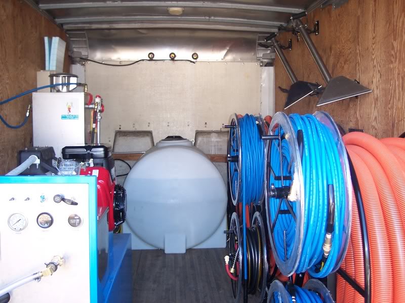

With all due respect les..... your making fun of my 55 gallon drum? That fresh tank is held down with cloth strapes. Do u have a metal one? Or just made to order. Cause from what I'm seeing the tanks are made out of same material..... just a different shape. Love the pics though. I would take ur machine in my. Van with a 55 gallon drum over that

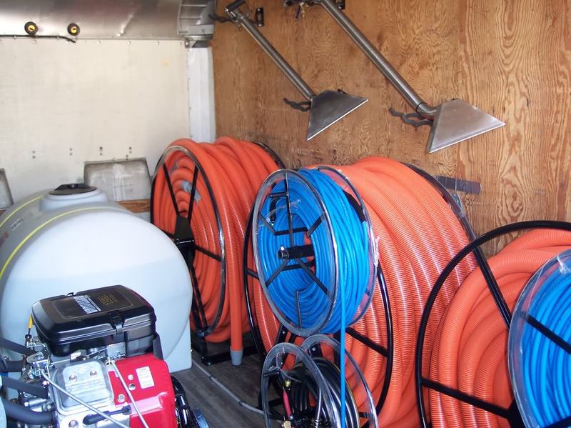

the straps are rated at 100,000 lbs, the tank is made to be installed in a vehicle not the same as a 55 drum.
you will never get a 55 drum from me.
But you will get a free spare motor and $1000.00 cash, if you pay $14,995 for a aluminum truckmount from me.
