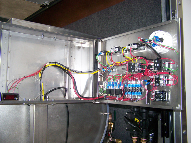

Gauge inside the panel - ask me at the Experience show and i shall tell!!!

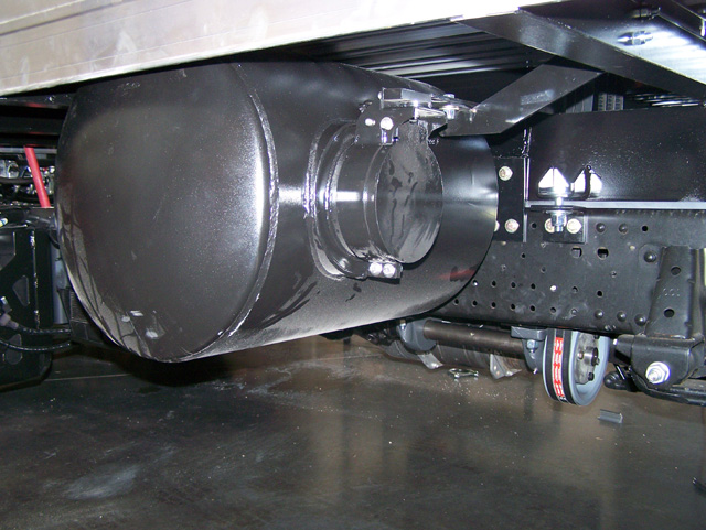

Silencer - we moved the discharge to the side to reduce the noise. The blower exhaust discharging straight to the ground would give an "Echoing" effect adding to the noise.

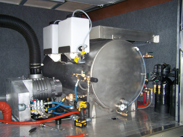

Here is the front face of the control panel.

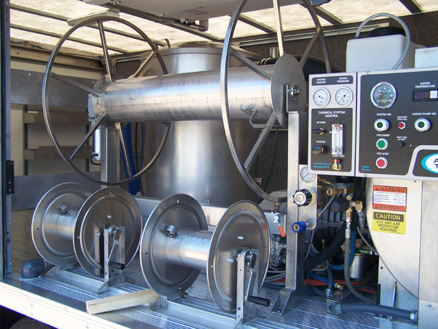

we have installed the vacuum hose reel, solution hose reels, dual pressure regulator, etc.

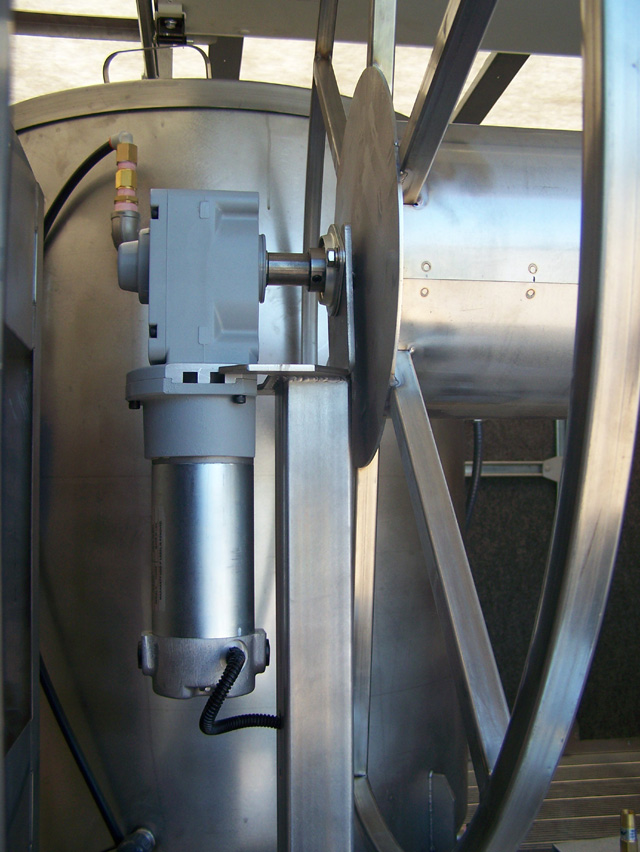

here is the electric motor / gear reducer that drives our vacuum hose reel. The hose reel can be manually turned either direction or powered by a push of a button. As you can see, this is a direct connect without any sprockets and chains.

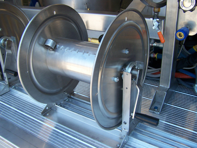

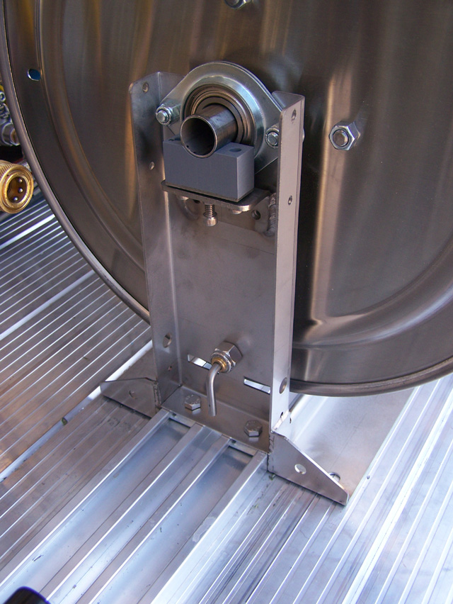

2 solution hose reels come STD. on each truck. They are fully stainless steel and hold 400' each of 1/4 solution line. We bolt them to an extrusion that allows them to be adjustable side to side.
here you can see the drum spins on bearings. This makes it much easier to roll up and unroll with less resistance. The grey plastic piece can be tightened to the shaft if one prefers more resistance.

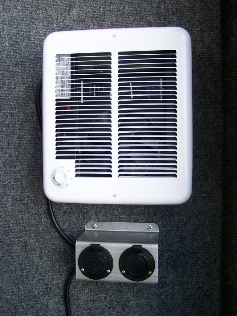

nicely upgraded solution reels!!!!
looks just like mine otherwise
FANTASTIC truck!
Jeremy, if you could..
I would love to see a picture of the dual heater set up you guys have!!! I plan on re insulation my truck and might add those heaters before hand.
here is our electric heaters. They draw 1500 Watts, and 12.5 amps each.
let me know if you need a set and i can get some shipped up to you!

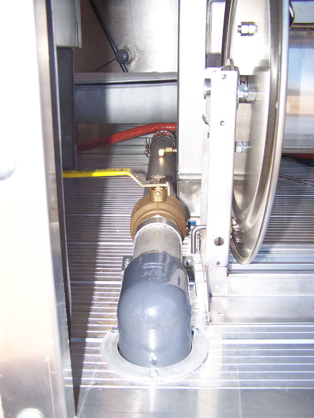

The recovery tank drain has been fully completed. 2" drain pipe plumbed under floor.

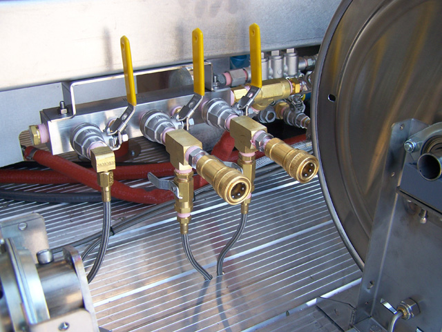

Here is the main Hi Temp / Hi Pressure header. The small chrome handled ball valve and the stainless hose going through the floor is our new pressure bleeder valves. This allows you to relieve the pressure in the hose without having to pull the trigger on the wand. The third ball valve without a quick connect supplies water to the dual pressure regulator.

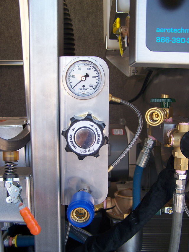

Here is the dual pressure regulator.
all electrical wires are inside the box, ran inside the conduit you see in this picture.

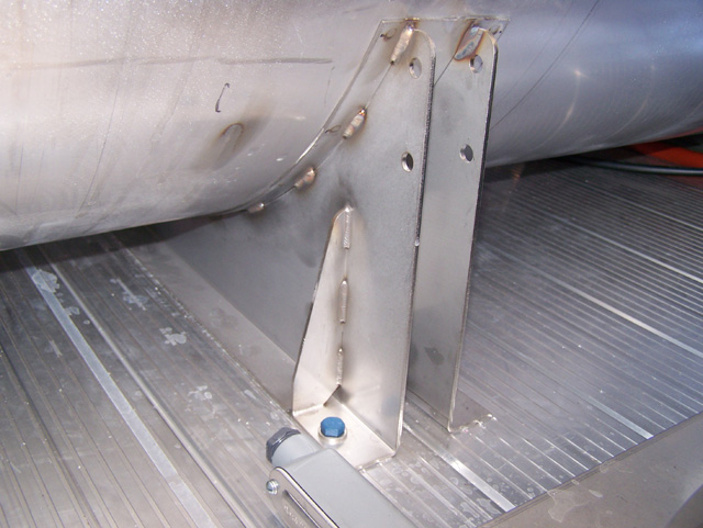

another good look at the legs on the fresh water tank. NOTE: bolts, screws, and nuts are either stainless steel, or PTFE coated like the blue bolts used to mount the fresh water tank.

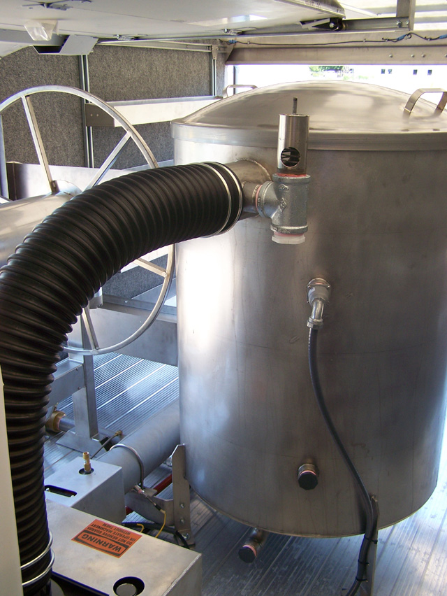

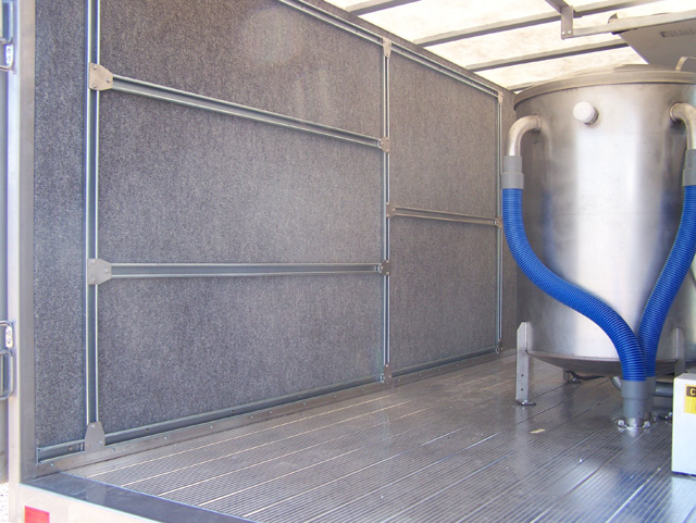

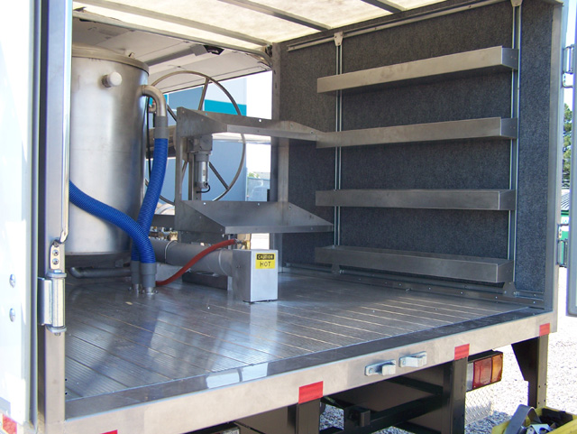

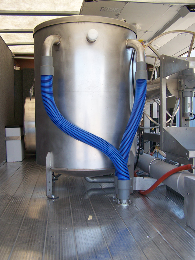

5" suction line (rated to 29" of vacuum) has been attached to the recovery tank. High water level switch installed and wired.
Air mover shelving (holds 4 air movers), Chemical / misc. side wall shelving unit (48" wide) fully adjustable up and down. Exhaust exchanger installed, plumbed, and insulated.
Racking system installed. We will later attach different brackets and straps to mount cleaning tools.

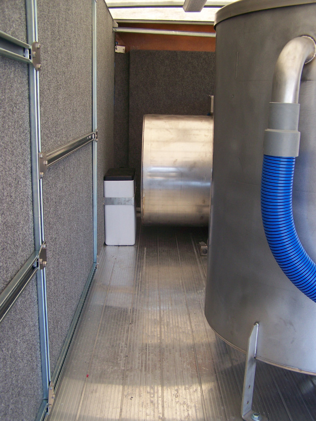

Here is a look down the drivers side isle way. The white tank with black lid is the brine tank for the water softener. Holds 40 lbs of pellet salt.
2.5" vacuum hose from recovery tank to the vacuum inlets (compared to 2" from tank to inlets on vortex and early model AT's). This has tremendously increased vacuum. With engine rpm's at max, both vacuum inlets open, we only have a restriction on the blower of 1.5" of vacuum.
anyone who owns a vortex, or an early model AT that performs this test will find themselves running around 4"-6" of vacuum with both inlets open and all filters clean.
