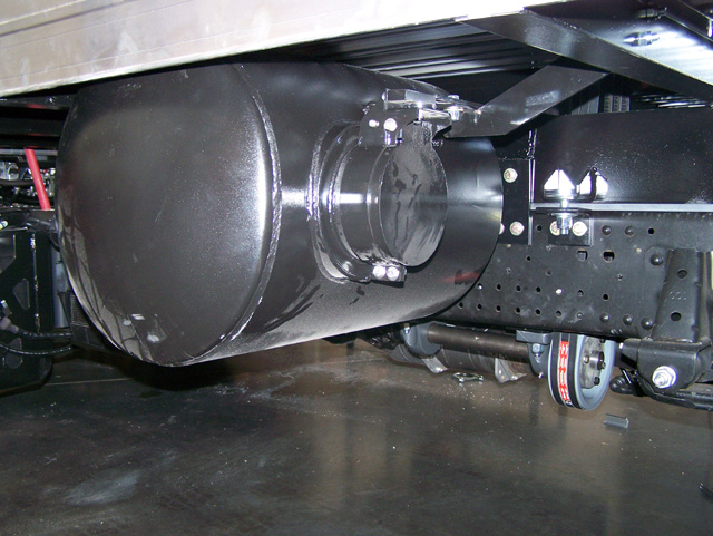

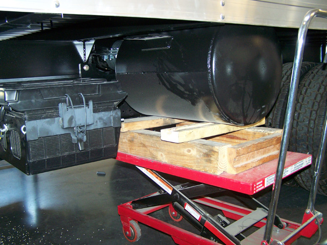

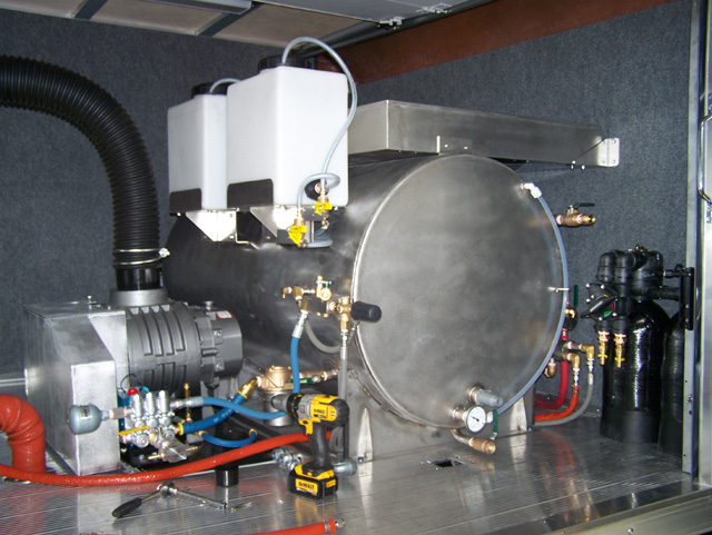

Here we have loaded the fresh water tank, #6 blower, water pump / oil level indicator, and recovery tank.
[/URL][/IMG]
Here we have loaded the recovery tank. We are getting ready to install the 2" drain line. It will be plumbed underneath the floor of the box.
[/URL][/IMG]
[/URL][/IMG]
we have installed the blower & water pump belts and are getting ready to install the 5" suction line from the blower to the recovery tank.
[/URL][/IMG]

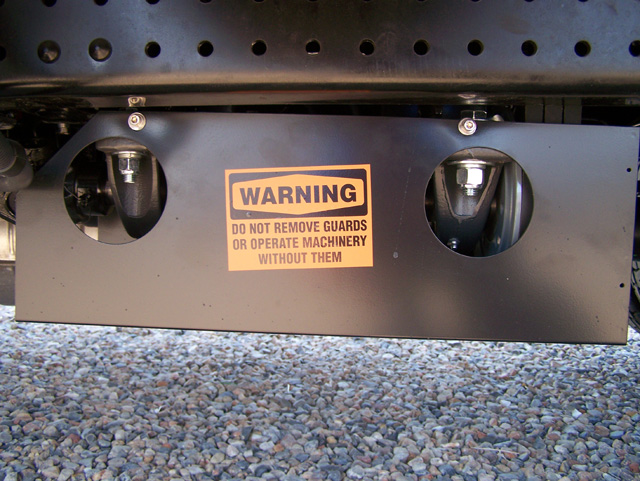

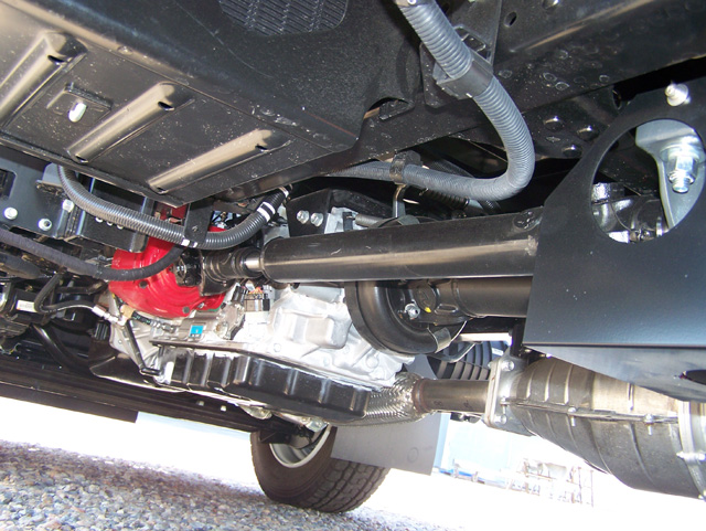

Here is the drive shaft connecting to the PTO. Only 3 grease zerk fittings.....Easy to access.
This is the lower sheave shaft bearing or pillow blocks. 2 grease zerks to grease. the cover can be left on to grease.

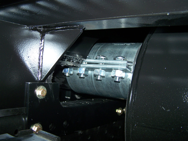

here we are connecting the 5" piping from the blower exhaust to the silencer.
attaching the silencer to the box frame rails.

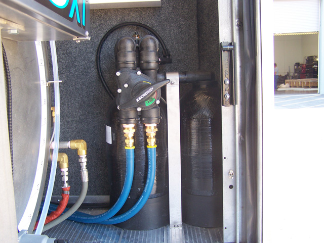

Inlet tubing from blower to recovery tank has been installed. Kinetico water softener has been installed.
Kinetico water softener fully plumbed.

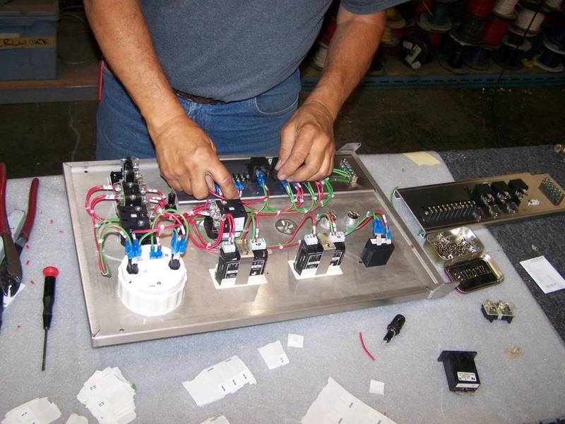

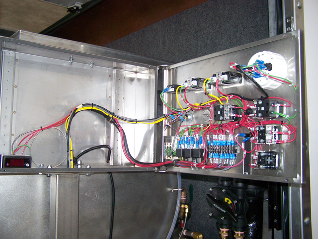

control panel being assembled and wires labeled with #'s
Control panel installed inside box.
