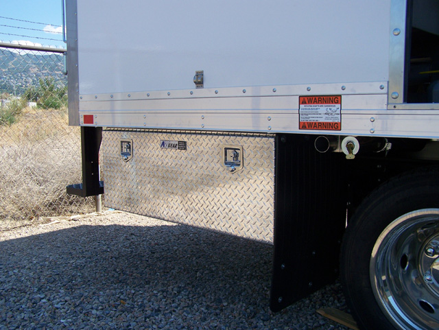

Here is the 48" long under body box for extra storage

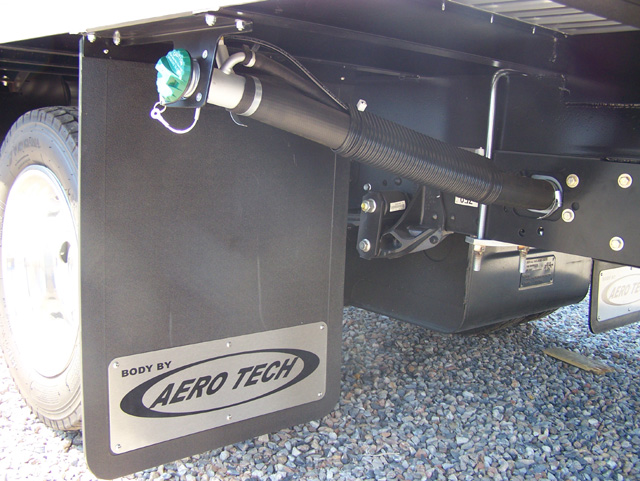

Fuel fill line.

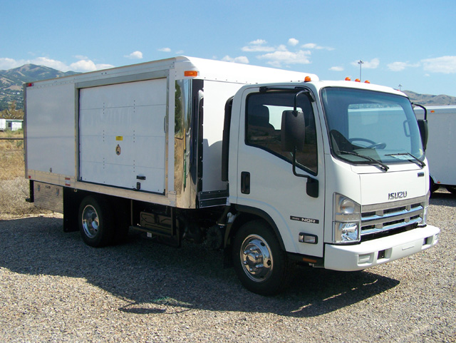

Passenger side

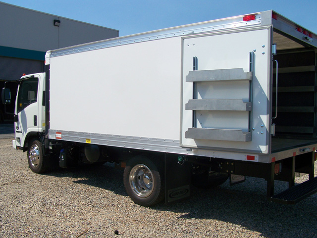

Driver side
Each door has 3 chemical / Misc. shelf's

This truck appears to have larger tires and stiffer suspension than a regular vat, is ride height taller than the trucks with 16 inch rims?
Yes, a little taller. This is a heavier chassis.
This chassis is an Isuzu NQR rated at 17,950 GVWR
tires are 19.5"
same engine, transmission, just bigger axles, springs, wheels / tires, and brakes.

Mine runs 19.5.......same set up same...axle..springs....bumper height......etc.....and I have 4 or 5 driveways that I drag going up and down......I would rip the bottom of that box out on a few of them.......
