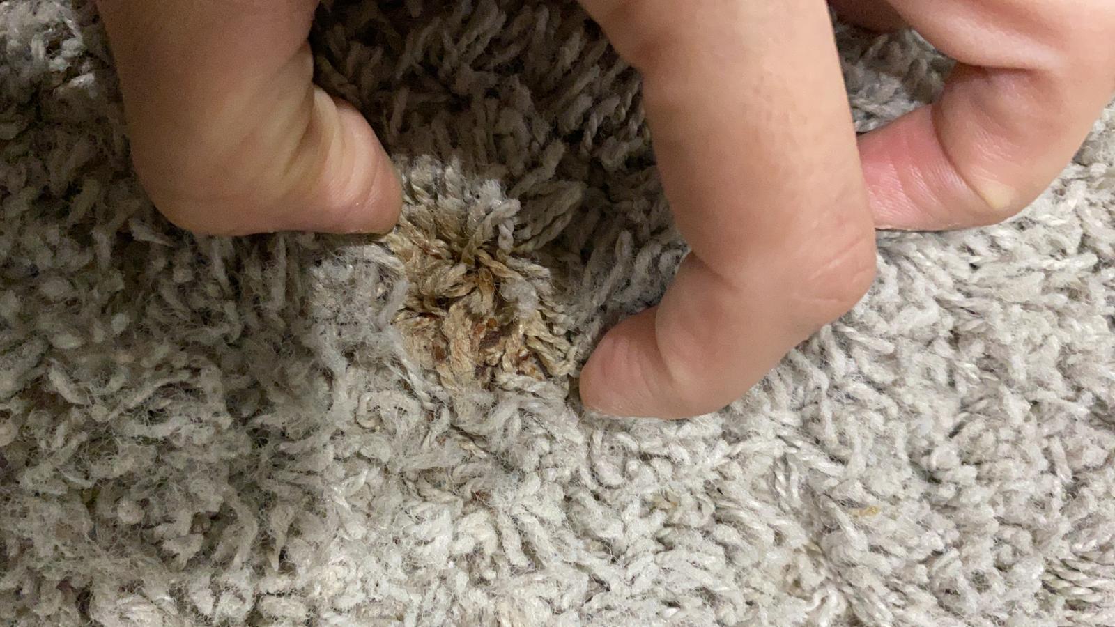

This is one I had to flush out. The browning got worse even after treating it with H2O2.
I came back to treat with OSR and claw it. I have no clue what it was. No pets or odor; I assumed it was from a cleaning prior. It felt gewy like gum.

Very rarely, maybe never does browning happen on synthetic fabric. The so called “browning” effect is leftover cleaning solution dried
The real browning is rotting the fibers on natural fabrics and wool. Totally different process is needed to treat it

So the answer to your question on number one rule:
-Get off your lazy ass, leave the vibrating buffer orbot whatever, and browning treatment sprayer in your truck and pull out your hoses and do another cleaning to rinse out the remaining crap you left behind and leave a fan behind.

Yeah that too. My issues arose when I didn’t turn on my chem injection, sprayed protectant with non acid water, or have done urine work and because of the saturation of the pad some browning occurred. Encap juice really has been a life saver for these occasions.
