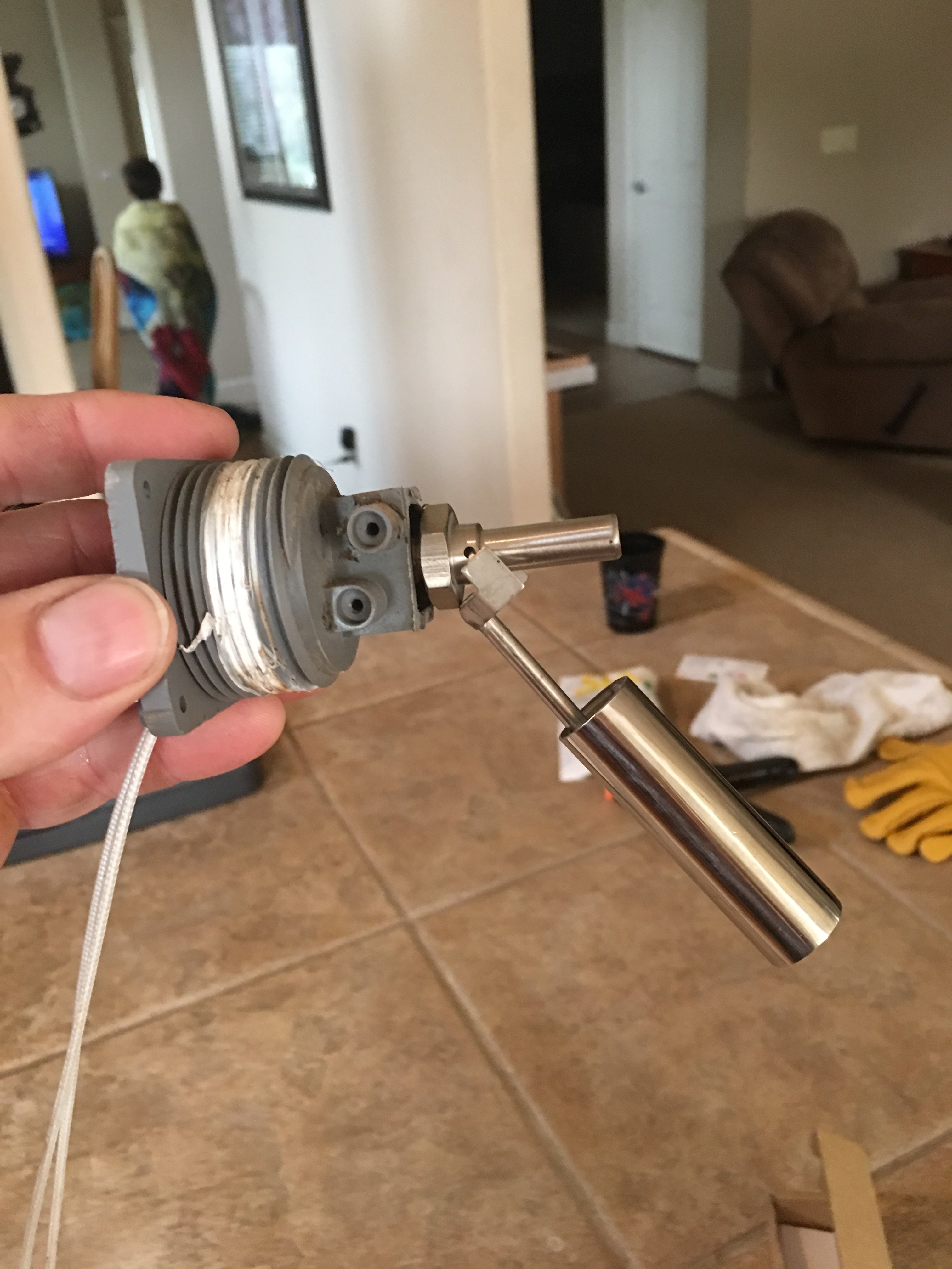

Tell me about it. I hate these fancy harwil float switches. I’m making my own today.
